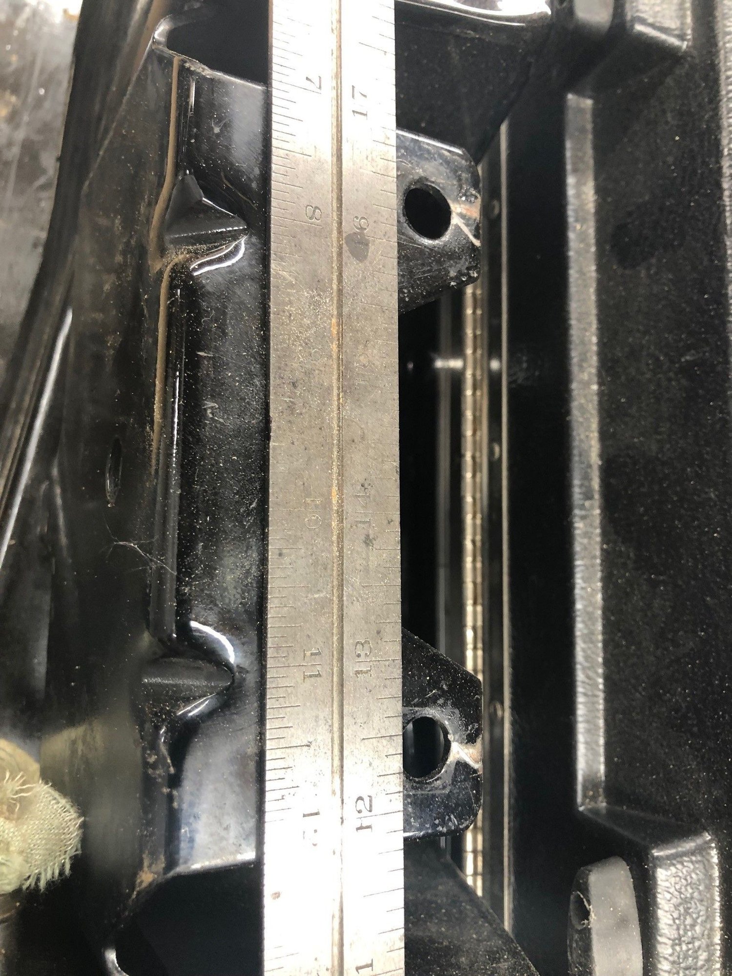

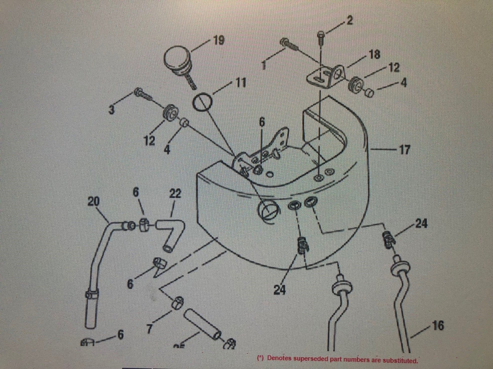

^ I have a T/C tank on the shelf , I`ll get a photo
first is evo
2nd pic is T/C

Thank you for the specs.
