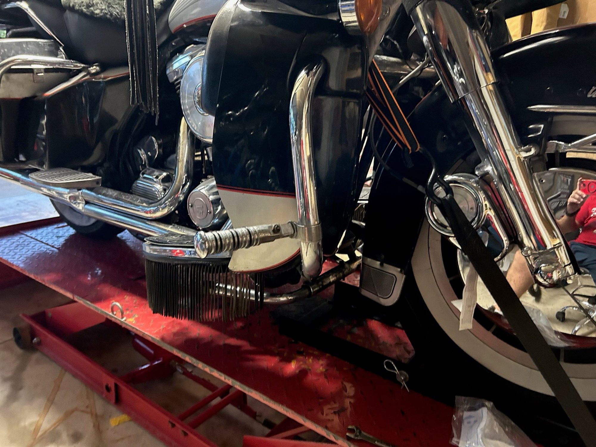

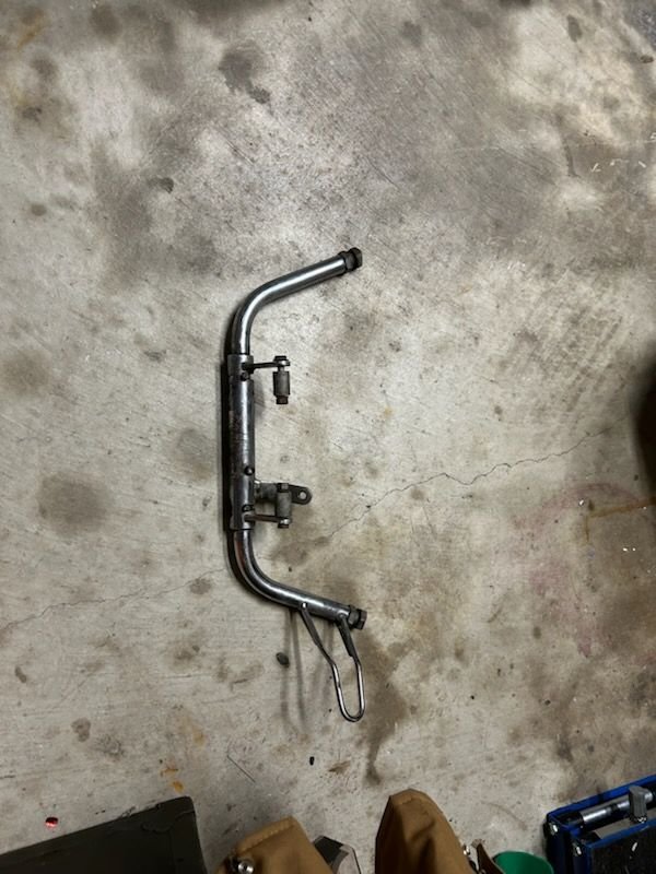

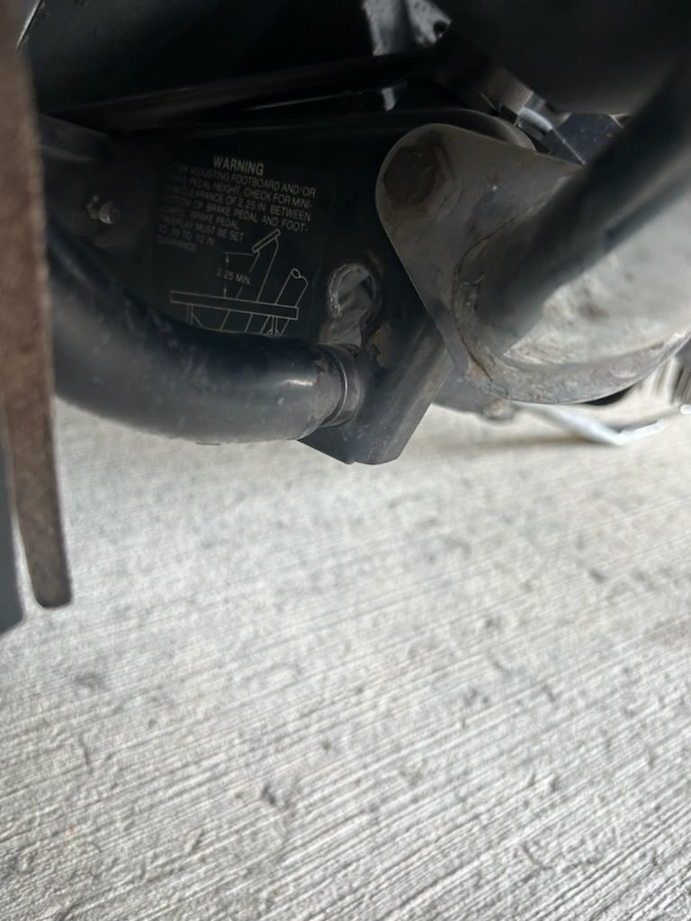

I took my display stand off last night, as it was scraping in the corners. When I went to take it off though, I realized it was mounted through a hole of its own, as opposed to the crash bar bolt as shown in the photos. It also looks like it is missing a tab where it bolts to the voltage reg. It worked great for the last couple of years I have had the bike. I may put it back on in the future and was wondering if someone else who has one, can verify how it is mounted?
