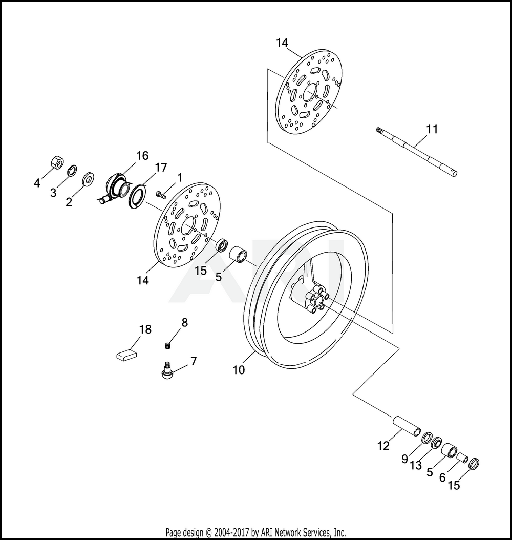

This may help for where thing go, follow the link for sizes of the spacers. The bearings need to be set per the service manual for spacing. If they repacked the bearings and did not put the spacers back correctly, or you did not put them back correctly, things will be off.
Number 9 below is a spacer that comes in various thicknesses and adjusts the location of the wheel with regards to the bearing.
Genuine Harley-Davidson OEM Service Parts | Harley-Davidson USA

The right side bearing sits much deeper in the wheel center than the left. The right spacer is bout 1-1/4 long and about 1/2" is exposed beyond the seal when seated against the bearing
Valve stem on a Touring front wheel is on left for 16 x 3.00 mag wheels.
If the caliper is tight against the rotor inside half, need to compress the piston and slide caliper inward. Always clean/grease the mount pins when removed.
I'm guessing while riding it around, the left bearing fell away from the race, cocked slightly and the right one did the same, pushing the bearing spacer against the left is why the speedo drive won't go in. Speedo drive is the left axle spacer and the drive tang has to be in the notch of the rotor. The tang drive disc sits directly the against the hub with a thin cork washer/seal between them.
Simple fix - put the axle thru the bearings with the right side axle spacer on axle. That'll line up the bearings and bearing spacer. Remove the axle, put wheel under fender and the rest is easy....
