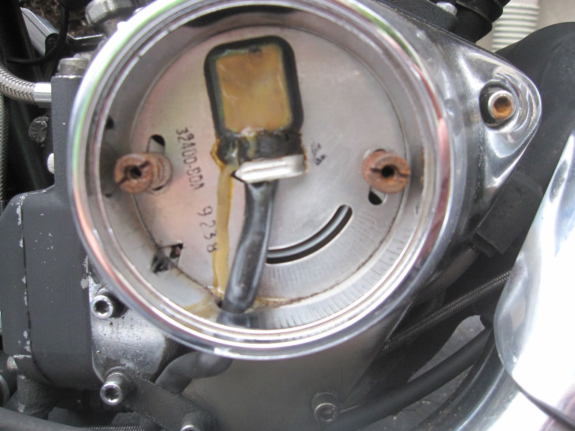

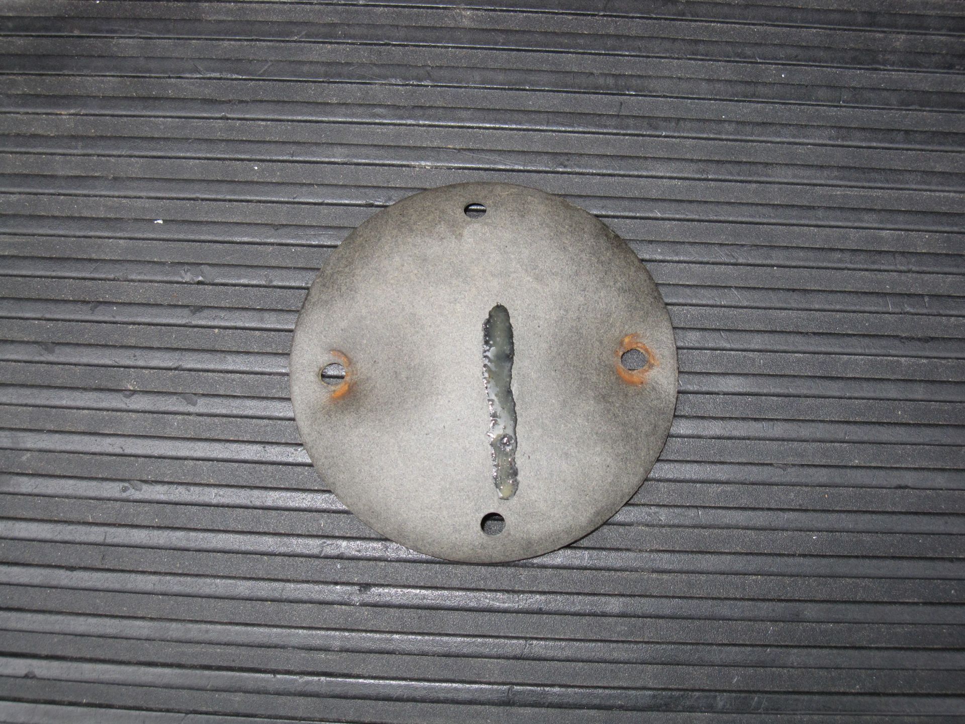

Thanks. I remember reading about this issue on the forum in the past, but I forgot all about it. I just checked the nose cone sensor, and it does look like something melted. I've attached two pictures. There is even a bit of melted "stuff" on the gasket.

Is the recommendation to replace the nose cone sensor and the ignition coil?

Yeah, looks pretty much done. Single fire coils are plenty expensive. I'd go with a cam sensor first.

Found the issue, common failure item on the older bikes. Pick up unit and go from there, coil is probably ok.

Good picture of a failed/failing unit in the nose cone. Replace that and see what happens next. ONE thing at a time.
