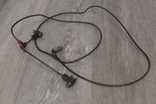

I got rid of the anti-dive solenoid & reservoir, but kept the air adjustment.
I like the option of adjusting the front spring rate and also the ease of changing fork oil with a mity-vac.
I bought a used air line set up off a 2001 from ebay, the air lines just push in, you can cut them and set it up for what you need.
There's one on there now for $21.75 + 6.50 shipping, ebay item #325419195926
