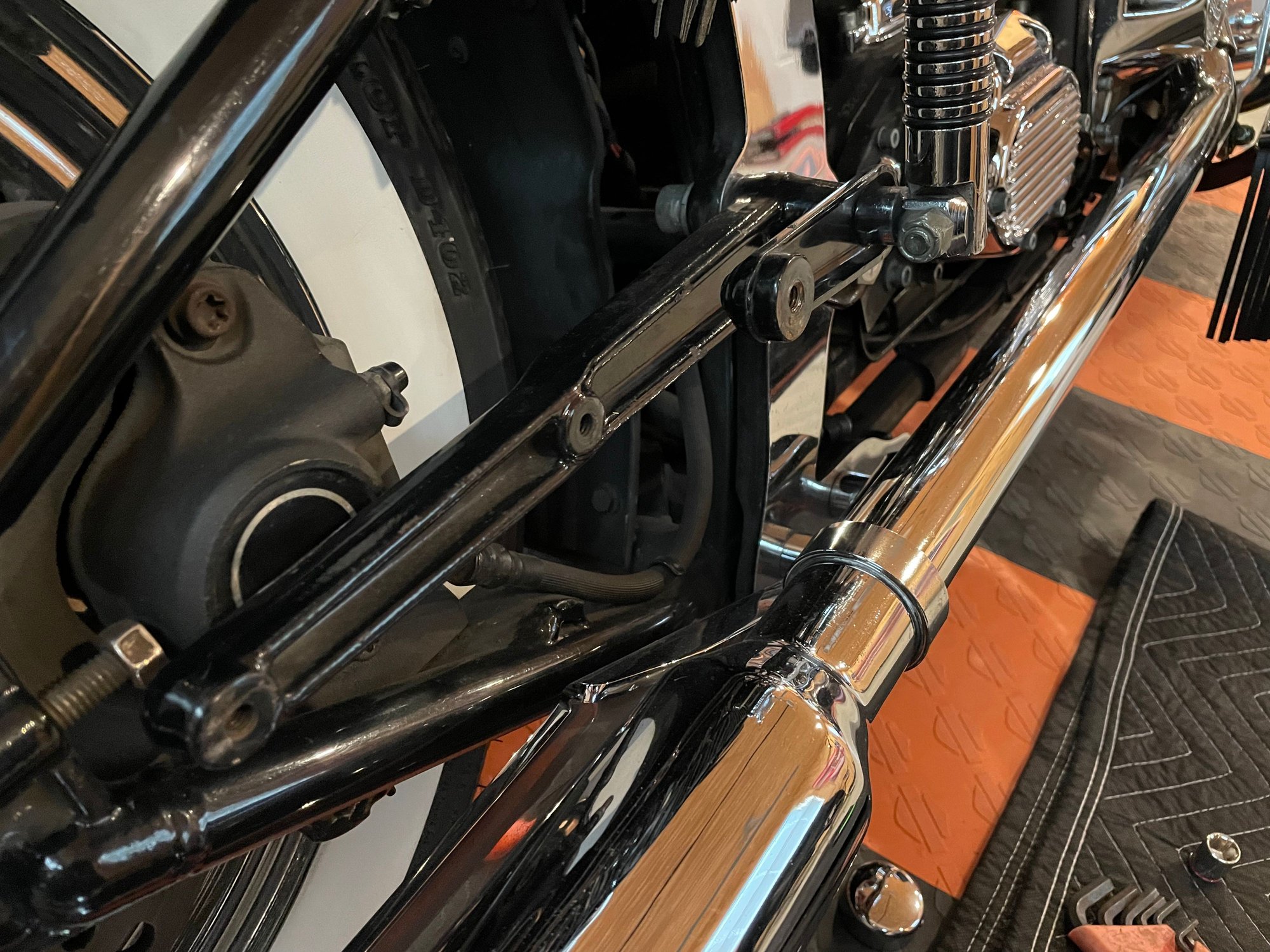

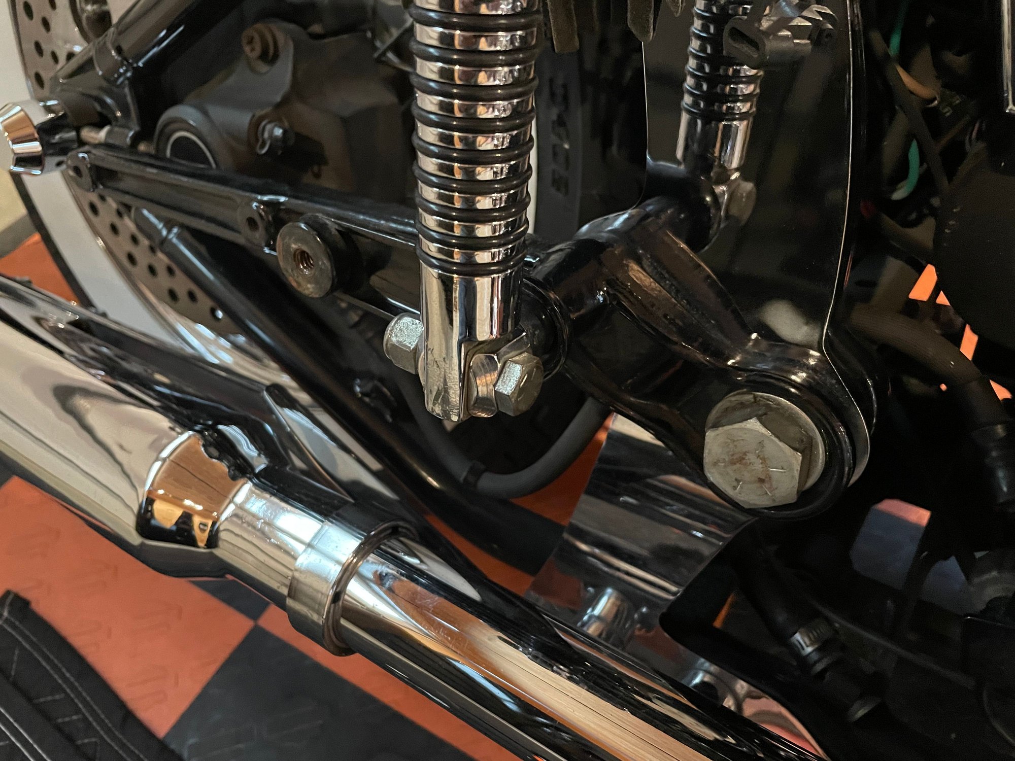

I want to remove this exhaust bracket on my 93 fatboy since I no longer need it. The bracket is attached to the swing arm bolt. My question is can I remove the bolt, take off the exhaust bracket and reinstall bolt? Will I need a spacer to replace bracket thickness? Do I need to worry about the swing arm moving out of alignment while bolt is removed?

It looks like you only need a shorter bolt for the passenger peg once the bracket is removed. The swing arm alignment is not affected.
The second to last pic looks like the rear tire may need to be moved to get the bolt out. The pic is a little dark, so hopefully that is not the case.

Luckily the tire is clear. Got the bracket removed. Thanks Paul
