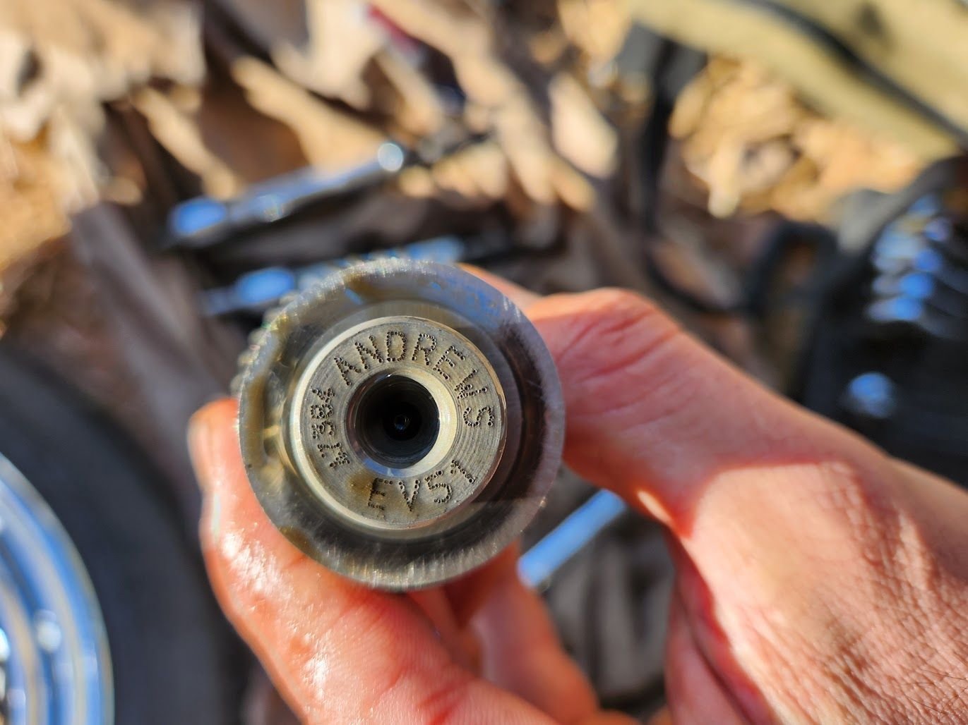

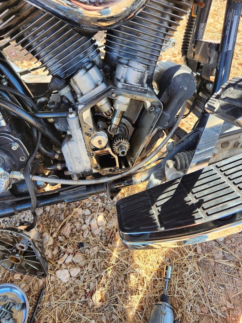

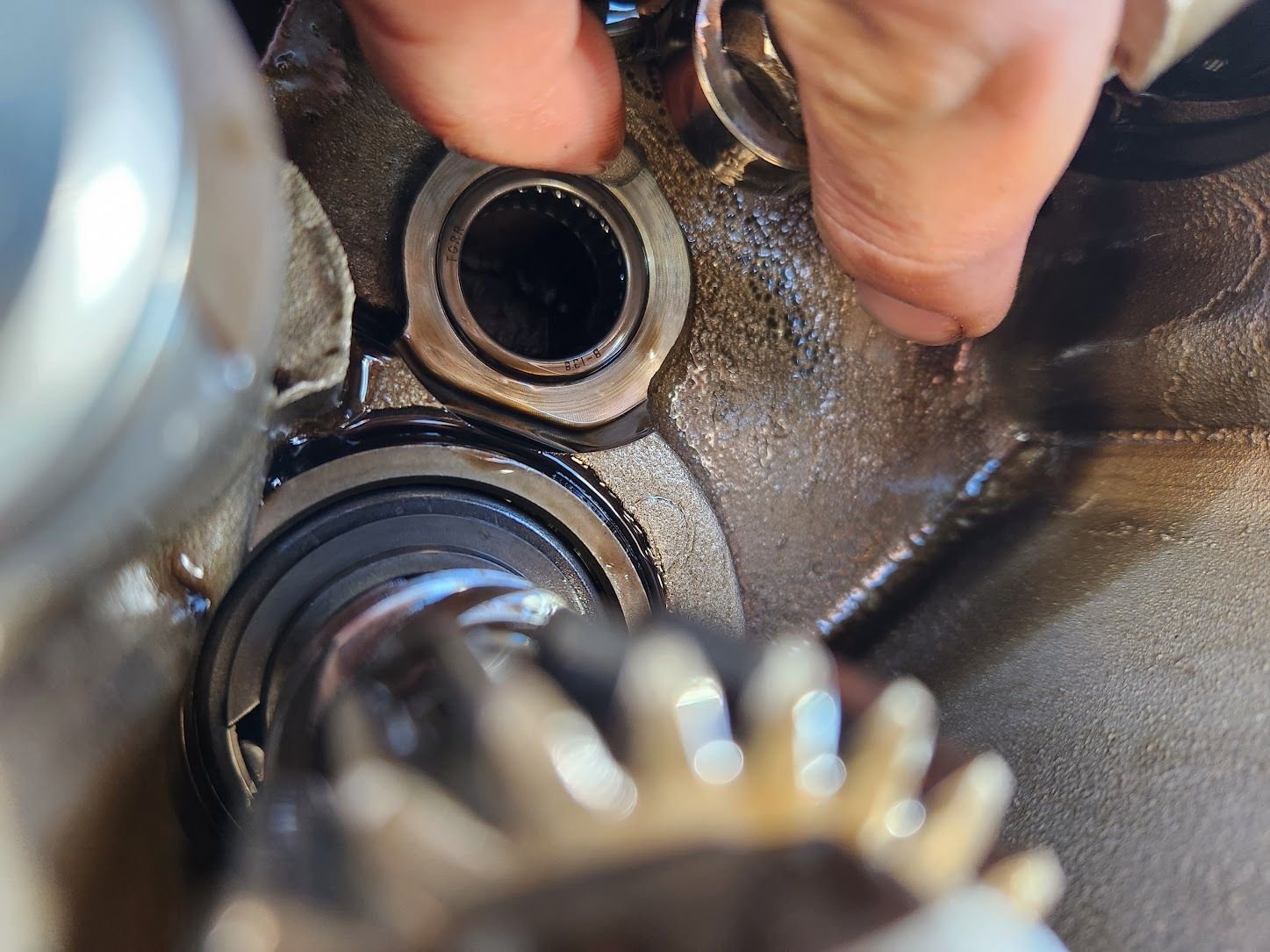

I opened it up this morning and found an Andrews EV51, fresh lifters, a torrington bearing, and an S&S breather. I"m no expert on these, but that seems like a lot of cam for what I was told is a motor that hasn't had top end work done.

Well that's pretty cool.. So you're probably got a 10 to 1 motor.. I would have done a compression test before I took all that out but no big deal, do one after you get it together.. You're going to need to get the measuring pins their .108", two of them measure the cam gear and measure the pinion gear and you will need the manual to decipher which way to go.. Pressing on a new cam gear or press putting on another opinion shaft gear.. which ever is cheapest..
Assuming the cam has the gear it came with from Andrews, the "blue" size pinion gear is what you need # 24044-93 and I saw a few on ebay just now. That'd be your quickest way to get it back together. Pinion gears are easier to find than cam gears (of a known size) and if you buy pins, avoid Andrews. I bought a pair a few years ago, new and sealed - they measured .1083 just saying......
In case you don't already know, that pinion nut is RH threads on that year if you go that route.
