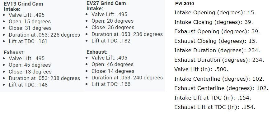

The V-Thunder EVL-3010 is another very good choice, very similar to the 13..

Here is a quick cut and paste job on the specs of the cams mentioned in this thread.:
