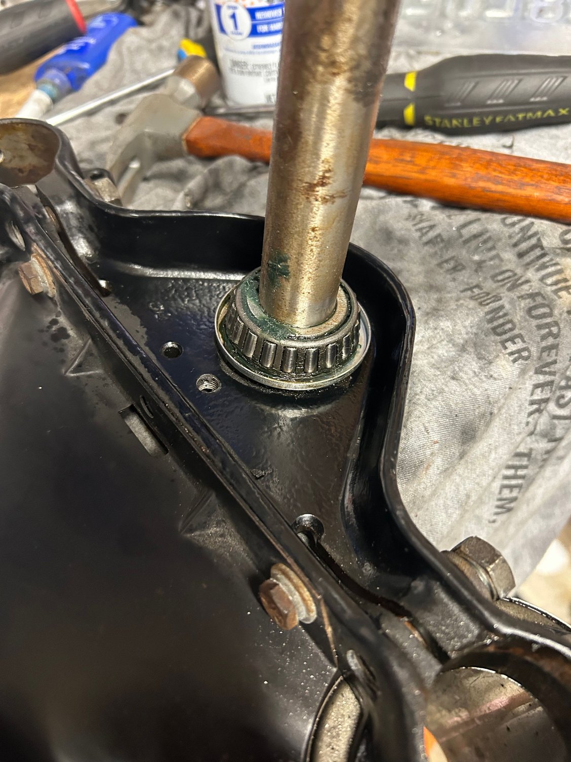

For all of the corroded and rusted in bolts I had to go through to get to the bearings, they look really good. Someone has been here at some point and repacked them. I will obviously repack them now that I am this far in, is there a method to getting the bottom bearing off to repack it? The manual says to chisel it off...

Don't take it off.. Clean and repack on the stem.. The main thing to look at is the race in the neck. If it's bad, replace both..
