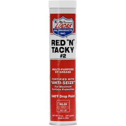

Some grease will drip in hot weather, Lucas Red n Tacky won't, drop point 540*
You may never have that problem in MI., unlike out scorching summers.
I'm surprised it wasn't filled like most bikes with a zerk on the neck.
