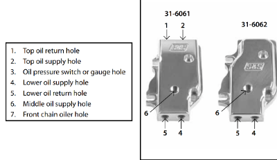

i contacted s&s tech support and they were 100% positive that the key way for the scavenger gear set was sheared and needed to be replaced..
i disassembled the pump and the key way was intact. now knowing that was not the issue i checked all the lines for clogs even though i knew that was not the issue everything was clear.
i then checked the passages inside of the pump i found that on the new pump i found one passage that would not pass air see red circle
with that knowledge i then checked the old cover and this same passage i was able to blow air into the line that goes to the filter. so i then checked the directions and with this pump there was a few pages to look at but this picture answered my issue.
the cover i have is the 31-6062.. my mistake was i thought port 4&5 were the same but now i know i have the oil filter file hooked up to port 4 and i needed to be hooked up to port 5. i made the change and my sumping issue went away..
so my rushing to get the bike back in the road cost me more time and headaches. lesson learned read everything before installing..
