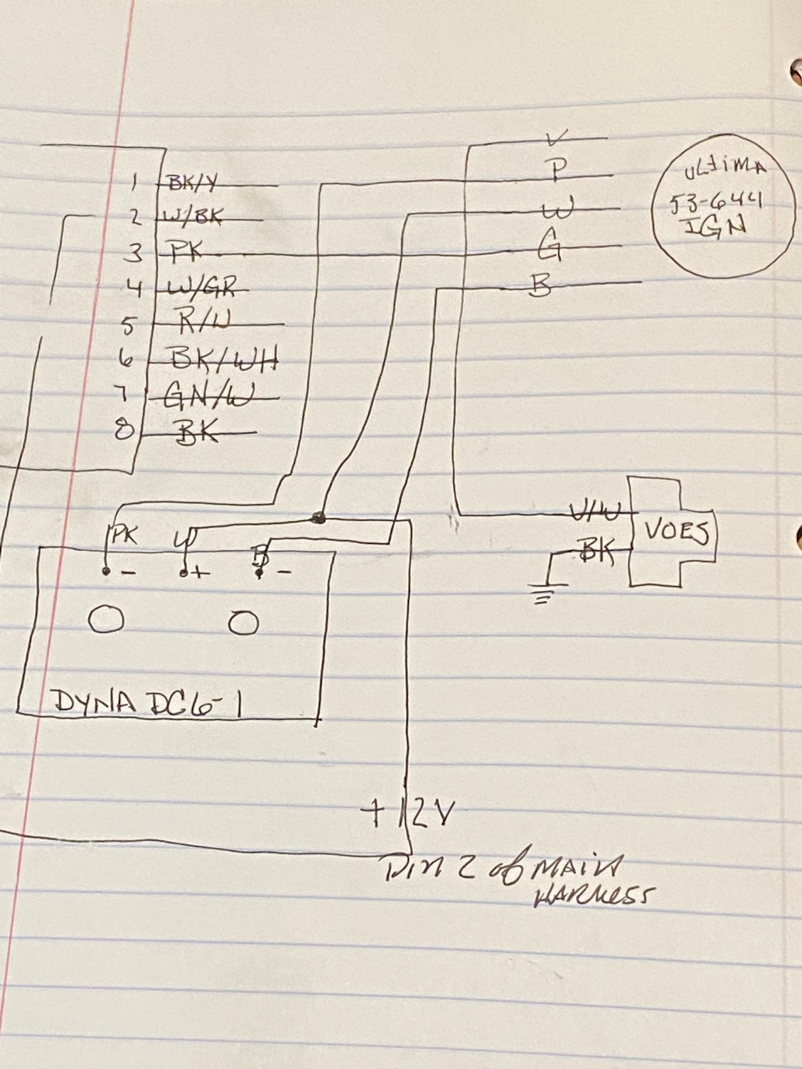

Originally Posted by evotrike
Would like a look at that. Thanks.
Most I've seen online are illegible. Ken
Pretty sure that thios is the one I used. I have sent it to other forum members who have used it.
Thanks, fl.
