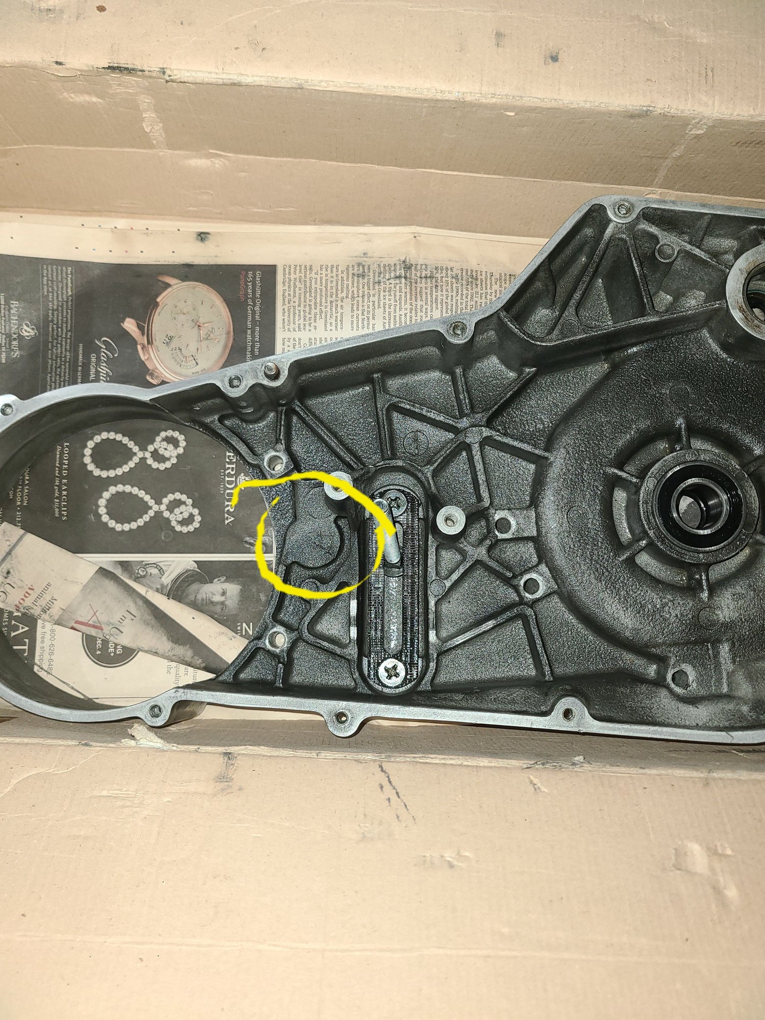

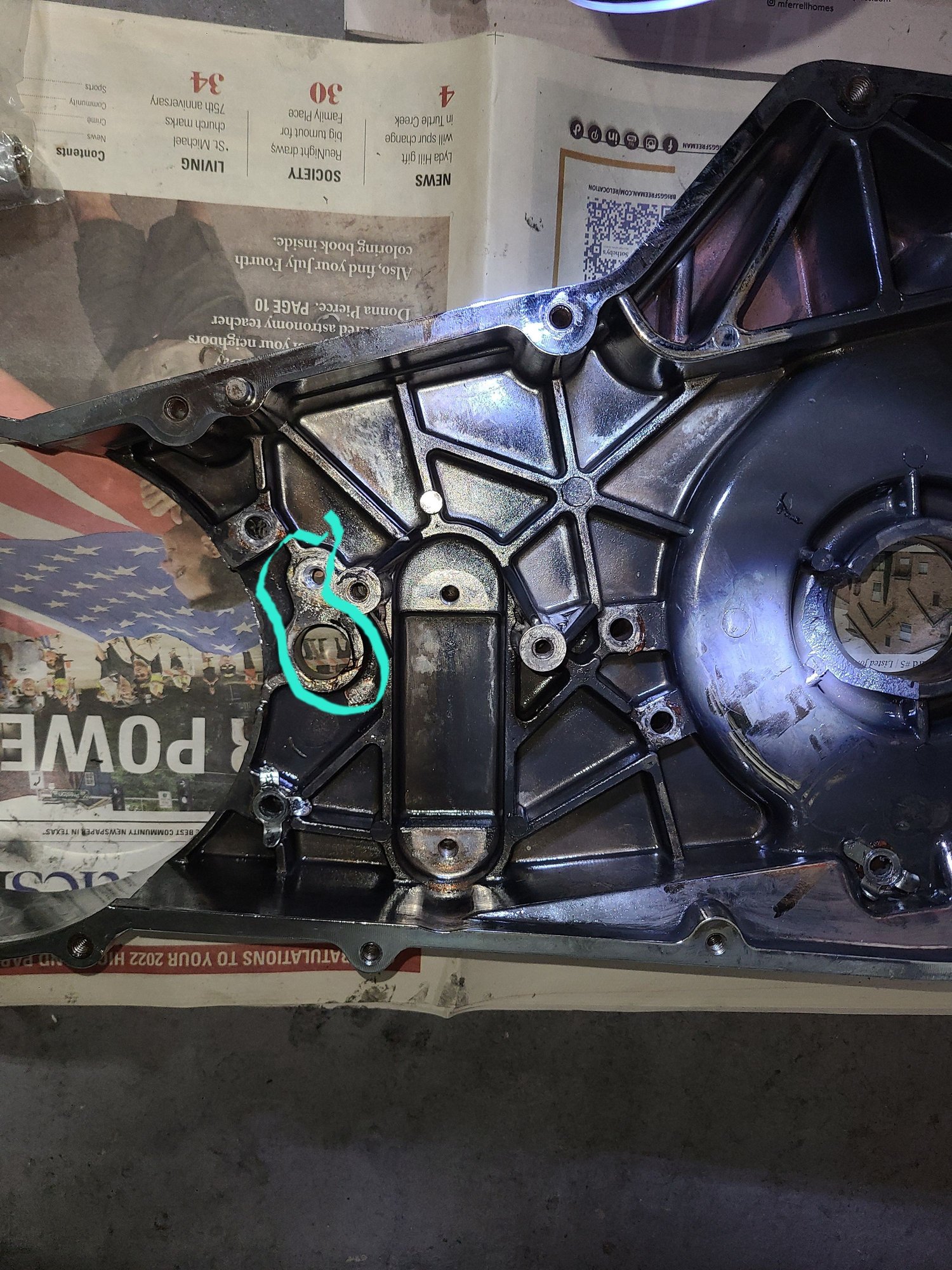

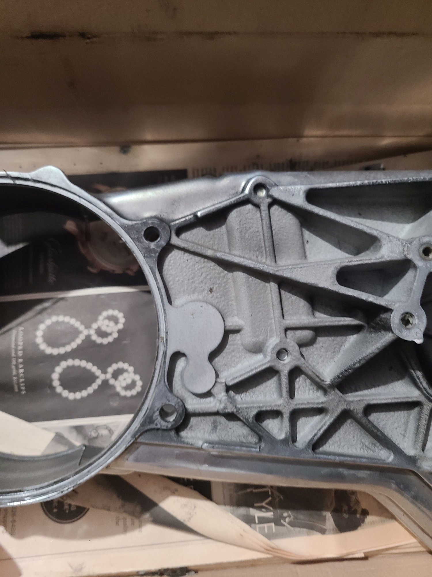

So I have another inner primary for forward controls (I believe it is a Custom Chrome item - bought prior to 2010) that I plan on taking to a machine shop to machine the holes (1 tapped) for mid controls. There was a thread I had seen on here where a forum member machined/drilled & tapped their own. Doesn't seem to be a difficult job for a machine shop. They're charging me $80.
Searching online I found other inner primaries for mid controls and they were mostly around $350 and one I found for $250. I did see one for a 2000-2006 Dyna (#60681-01) for $198, but am not 100% sure it would fit a 97 Dyna.

So the $80 machine shop apparently didn't have the correct tools/tooling to do the job. The recommended one started talking and then verbally said it would cost $200-$250, so not going that route. Probably getting an OEM one online. I do remember a member here who drilled their inner primary and it worked for them, just not sure in my ability to do that.
