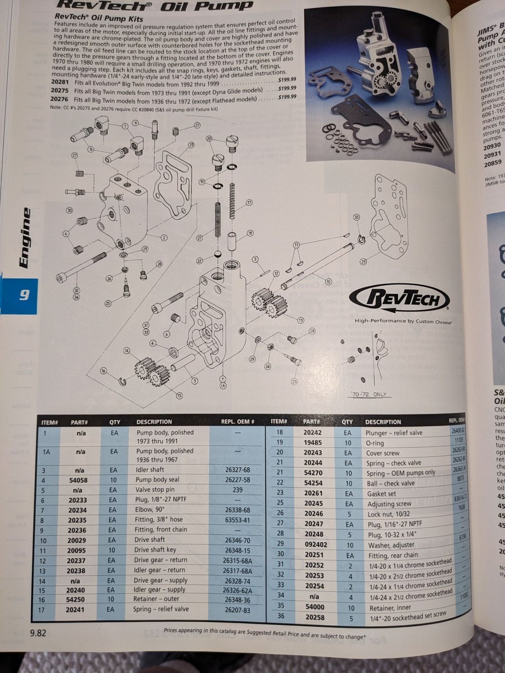

ill try to get a pic.my other question was there is no check ball on top of the pump

Originally Posted by john lee
my oil pump does not have a check ball fitting at the top its blank. where else could it be there is also 3 horizontal pipe fittings on the side of the pump there are only 1 hose connected to the top fitting which im guessing is the breather. the supply line goes to the bottom of the pump
Gonna need a picture to sort this one out, it has to have a check ball port, what may have been done it is something else.

Here is what an EVO Revtech oil pump should look like. It has a checkball.
