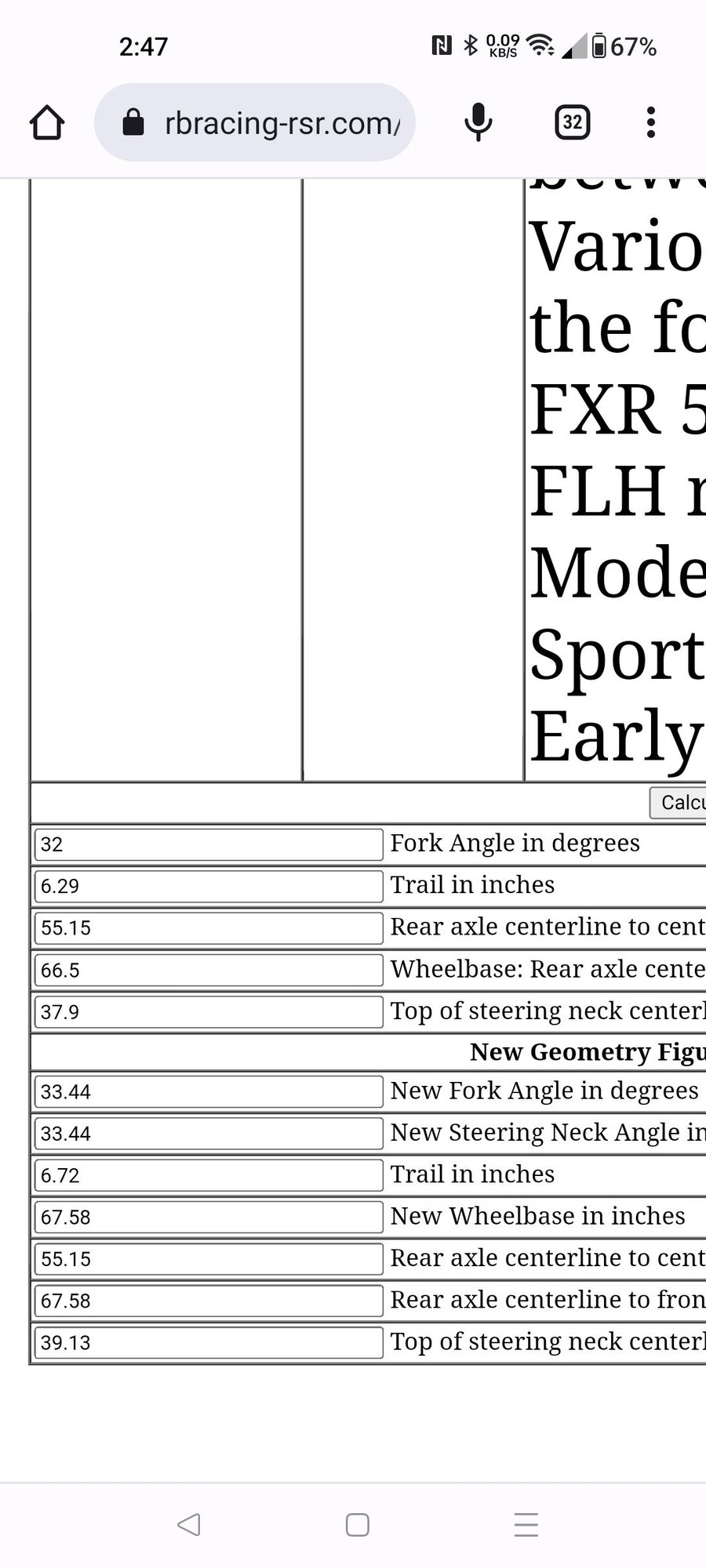

The trees are at 0°, the neck numbers vary from what research I can find but assume it's set at 31°.. the only way to really know is to laser it and actually measure the trail.. Once that number is identified I can calculate the take to the exact degree,.. Offsets, tube lengths, tire diameter, triple tree height and wheel base are all measurable to put into the equation to help me determine exact tasks but I'm really not concerned about that.. I really need my trail at a minimum of 6"... Also you need to remember the fork length raises the whole bike it will not change the relationship of rake to trail...
I beg to differ...plug the numbers in!!! Better yet... measure! The Only thing the MoCo changed when claiming different Rake numbers.. when what really changed was the trail!!! Lengthen the forks and tell me what happens...Note; The frame will No Longer be Parallel with Ground..

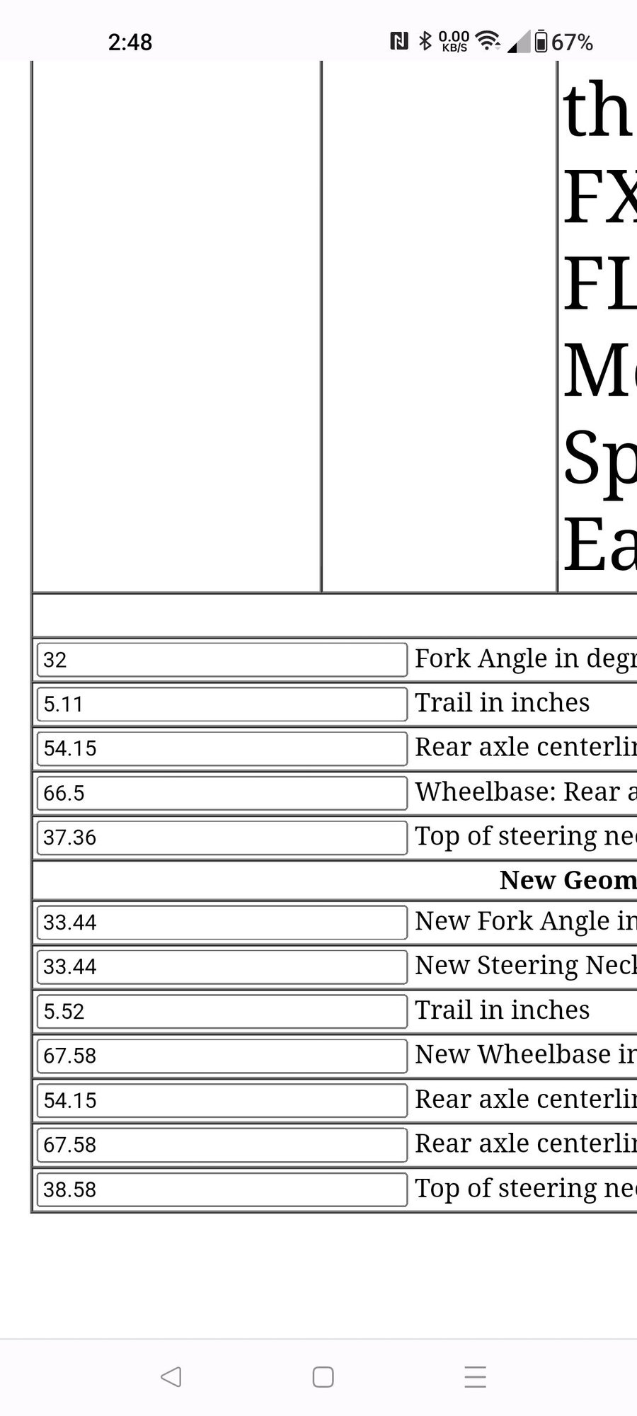

You are correct, RB racing has two calculators.. Ones just a standard calculator and the other one is supposedly a professional Rake and Trail calculator.. The standard one never showed any difference in trail when extending the tubes by 2 in. The professional rake and trail calculator however did so I was getting conflicting information but will now only use the professional calculator..
In the following charts we are looking at a stock FL front end with 1.45" of offset in the trees and stock length tubes and 2" over compared to a modified front end with an offset of 2.45" offset on the trees with stock length tubes and 2" over..
Stock
Modified

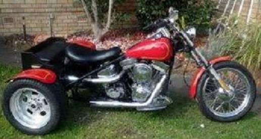

my trike gets a shocking death wobble. ive put on 2 steering dampers to counteract the problem could it be the rake as the cause of the problem

At what speed and do you know what your trail is?
