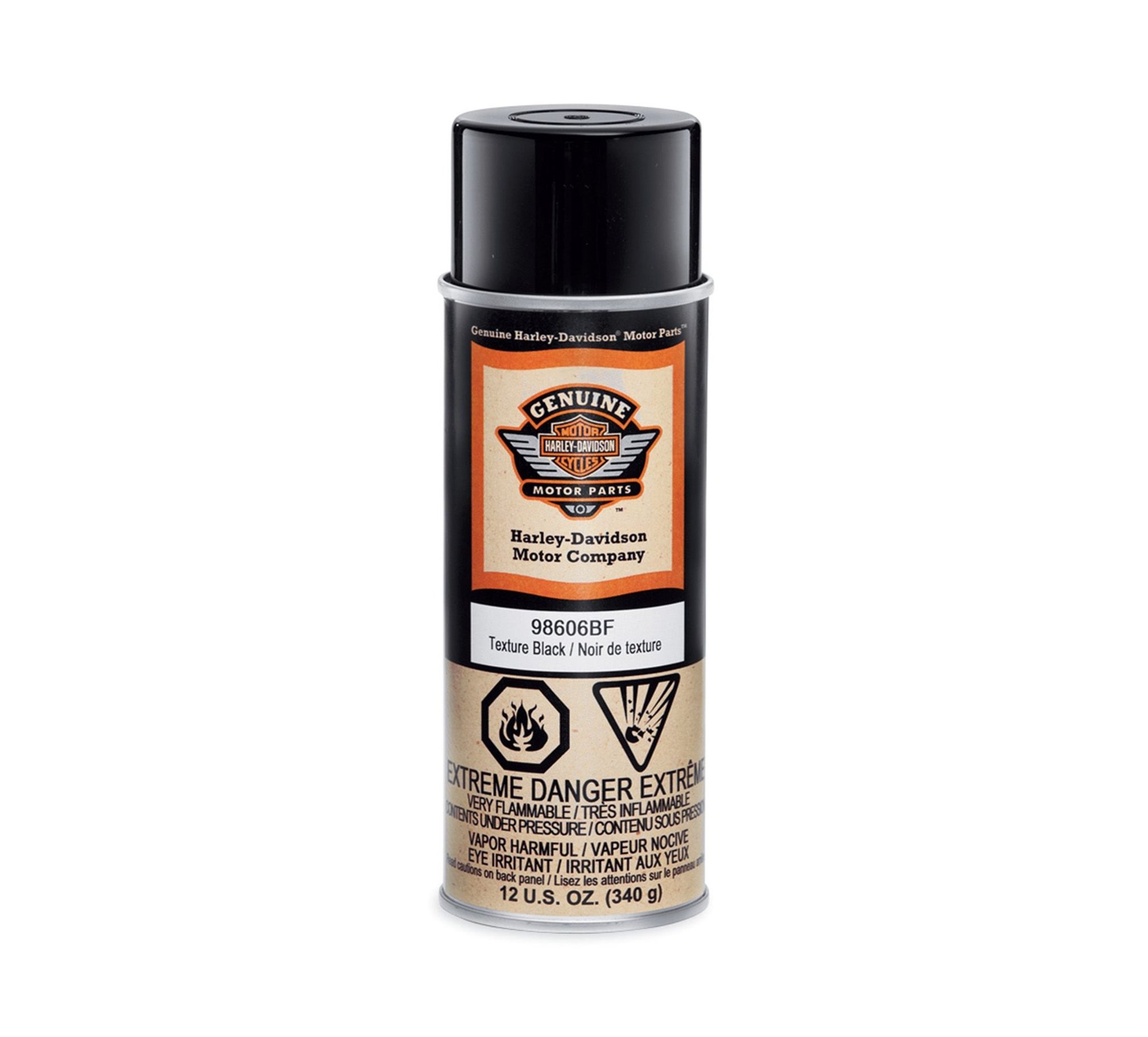

Not wrinkle, Harley Texture black

My inner primary was painted with Harley texture 12 years ago, it's still there.
Texture is the original finish match, whether painted or powder coat, not wrinkle.

The key word is: "TEXTURE" there is a difference between texture and wrinkle. As some have mentioned, you definitely want texture.

As others have noted black texture is the best.
When I build a TC fxr, converted the inner primary to mid controls and whacked off the shift arm mount. After cutting it flat I used HD textured paint. You can't tell where the paint stops and the PC starts. Even after 16 years.
