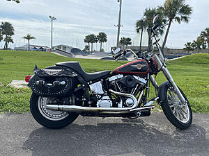

As much as I liked my Softail when I built it, it is not "punkrock" enough for my liking. This thread will not be quick because I am not even going to start on stuff until after Biketoberfest.
Here is the game plan.....
1. Sportster front end (narrowglide)
2. Mount an alien tank
3. Get the alien tank painted
4. Rewire to simplify it
5. A little bit taller narrow apes
6. Maybe build a new sissybar
My bike is already very simplified with wiring. No horn, hand controls, turn signals, or start button. I am already running a automotive style ignition switch mounted on the motor mount.
Photos to follow tomorrow of the new tank. I already have it and blind hole threaded bungs. I just need to do mock up and pick up more parts from the swapmeet.

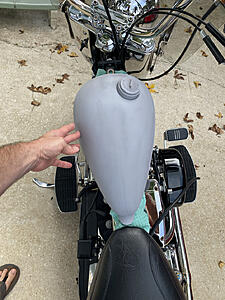

Primer'd the tank and test fit to see what brackets I need to cut and what side I want to
Run the petcock on. Looks like I'll need a 1/4 npt pingel.
Still pondering where I am going to stick my hi-lo beam switch.

When I had my Sporty I mounted a toggle switch (on/off/on) on the headlight shell.

I like that idea!

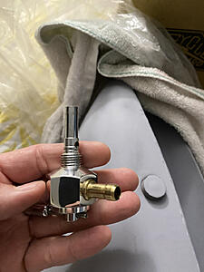

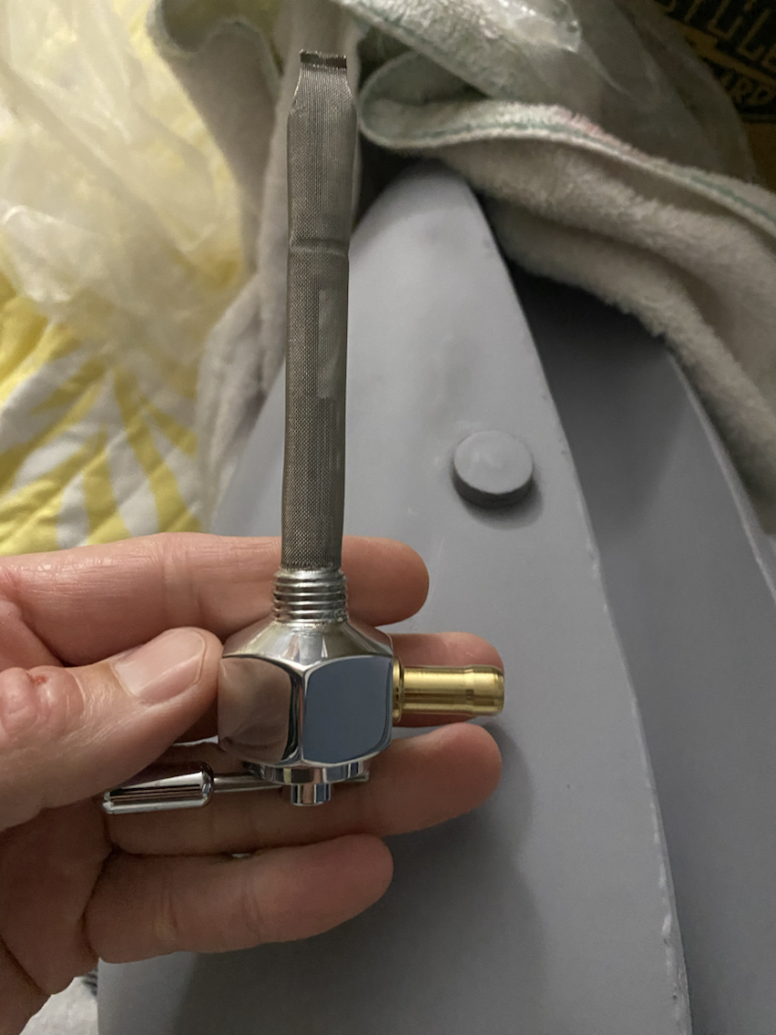

It's the small victories that matter. My new tank is kinda small but that's how I want it. I am running a big inch motor, so I needed a petcock that flows well and has a large outlet. I ordered a pingel that fit the 1/4 npt hole size.
I got the petcock in but the inlet tube was hitting the tunnel and it wouldn't thread in. I did some shopping for other petcocks but couldn't find any with a reserve. I was laying in the guest room on the bed with the tank pondering. I came up with the idea of shortening the pickup tube. Now she fits
