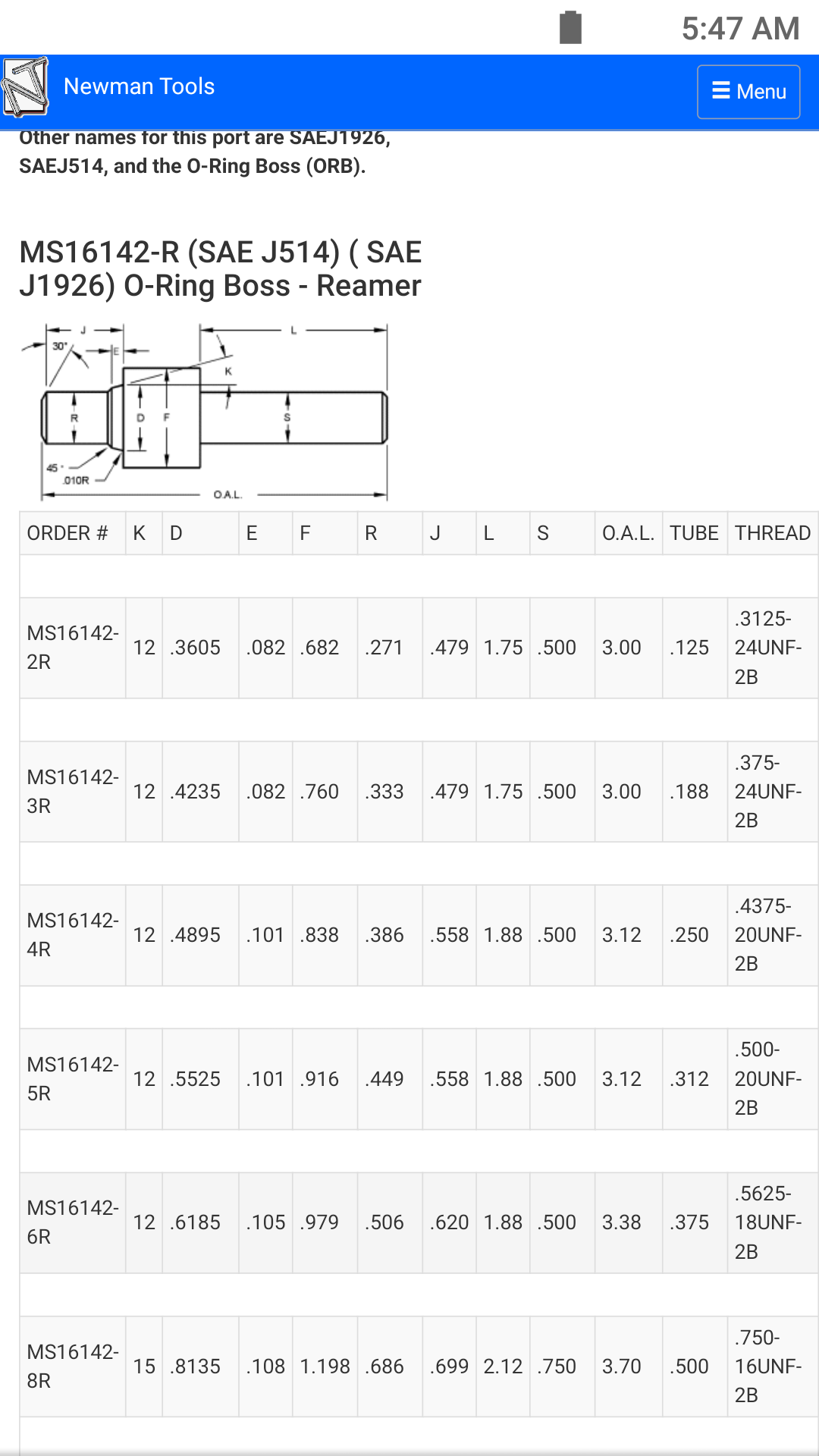

The plug on a Harley is a MS fitting. It's designed to seal in the bevel in the pan and the steel plug torque on the aluminum face machined in the pan. The threads are straight and sealer will help but should not be necessary. Be sure you are using the correct o-ring. It should be tight in the undercut of your plug. If your plug doesn't look like my sketch, it may not even be an MS plug.
If the plug torques, it's not the threads, it's either the bevel or someone tapped it over and used a helicoil or an insert. Welding it makes a mess. Then you don't even have a flat face.
If the hole is ever tapped oversized, you need a face gasket. Use the copper one with a seal ring in the center.
Don't depend on a soft face gasket to keep a plug in a shaky Harley motor. That's why Harley spent all that costly machining time on that MS fitting.

That is what I use on my 93 4 Cylinder YJ.
It may work on a Harley.
Depending on what cutter spect Harley uses. The washer face cut appears about .558
https://www.newmantools.com/cutters/ms16142r.htm
The nice thing about the two seal types I mentioned is that they work on a hole that doesn't have a chamfer that's necessary for o-ring clearance like you pointed out in your earlier post. With the OP's drain hole being oversized the chamfer on his drain hole is probably gone or very narrow with not enough room for the o-ring.
