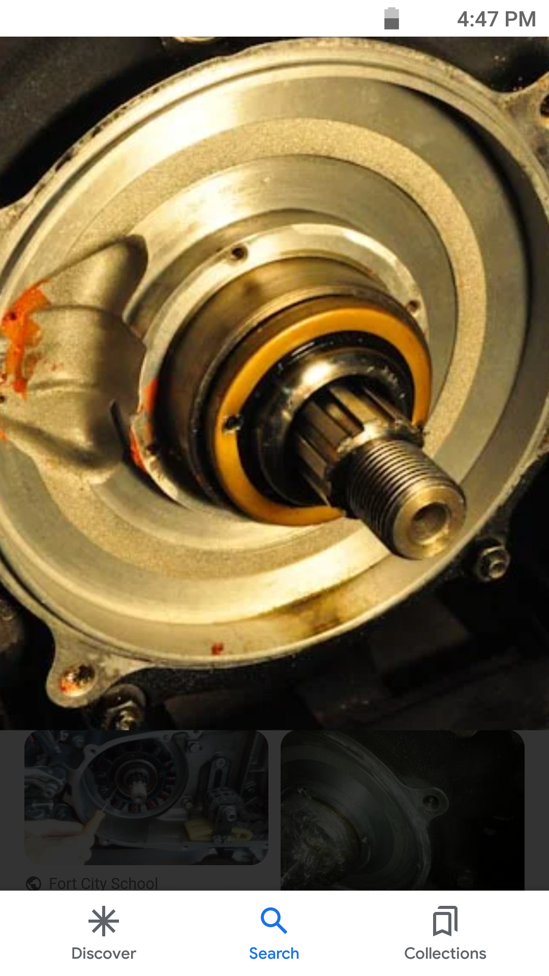

Might want to look first. On a TC, the seal runs in the center of the first half of the sleeve. And yes, if there is a lot of miles, the soft especially rubber catches the grit and laps a groove.
On a a TC just turning the sleeve gets you a new unused area.
For the first poster... It's probably just what you said but....

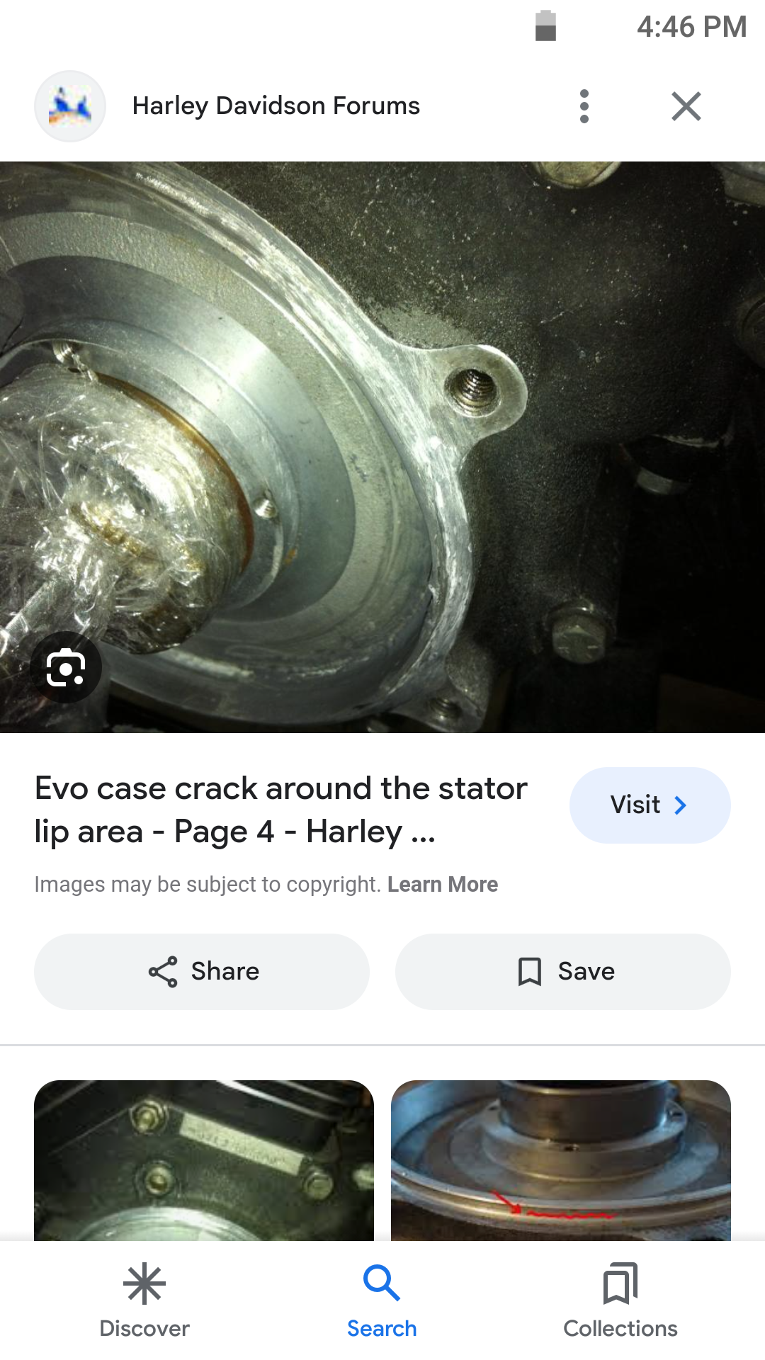

I once saw a EVO that was cracked from bad castings in the area were the bolt face hooks the inner primary cover to the engine allowing oil transfer.

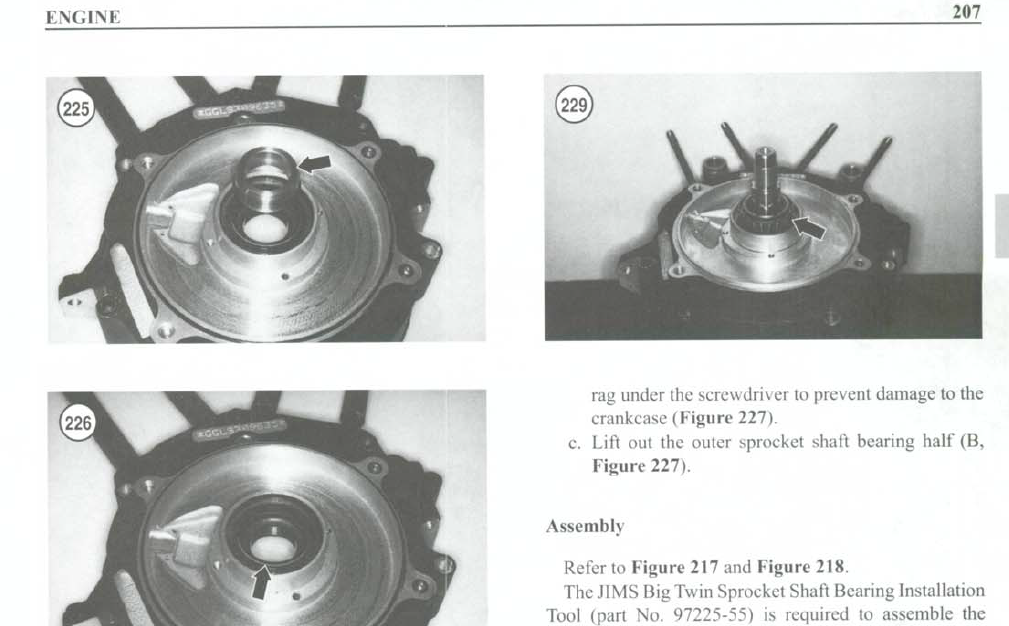

Here is what I am referring to in a EVO . And it sure appears sleeve is designed to be flipped if it is not already been done and then it will have two grooves.

A cracked stator lip will not cause oil transfer between the engine and the primary chain case. Bear in mind when posting here that bad advice is much worse than no advice.

I said about the seal sleeve to check. But I looked and it appeared to be like a TC and I had turned one around there. I would rather do that using the original sleeve than a new one may not be the same exact length. The cracks are also a factor to look for. You don't want to replace a seal only to have it still leaking from a crack. Google EVO case crack. Also saw it on this Forum.
I'm sorry you expect 100% accuracy on where the first poster's leak is from with one place. The first poster had already pointed to the obvious. I pointed out one other, and about maybe being able to flip the sleeve.
That is factual. Now where it actually is leaking, the post here has to be an opinion.
You like Twist need to stop trying to be moderators.
Now I do apologize to the first poster, the sleeve appears to have a flange.
