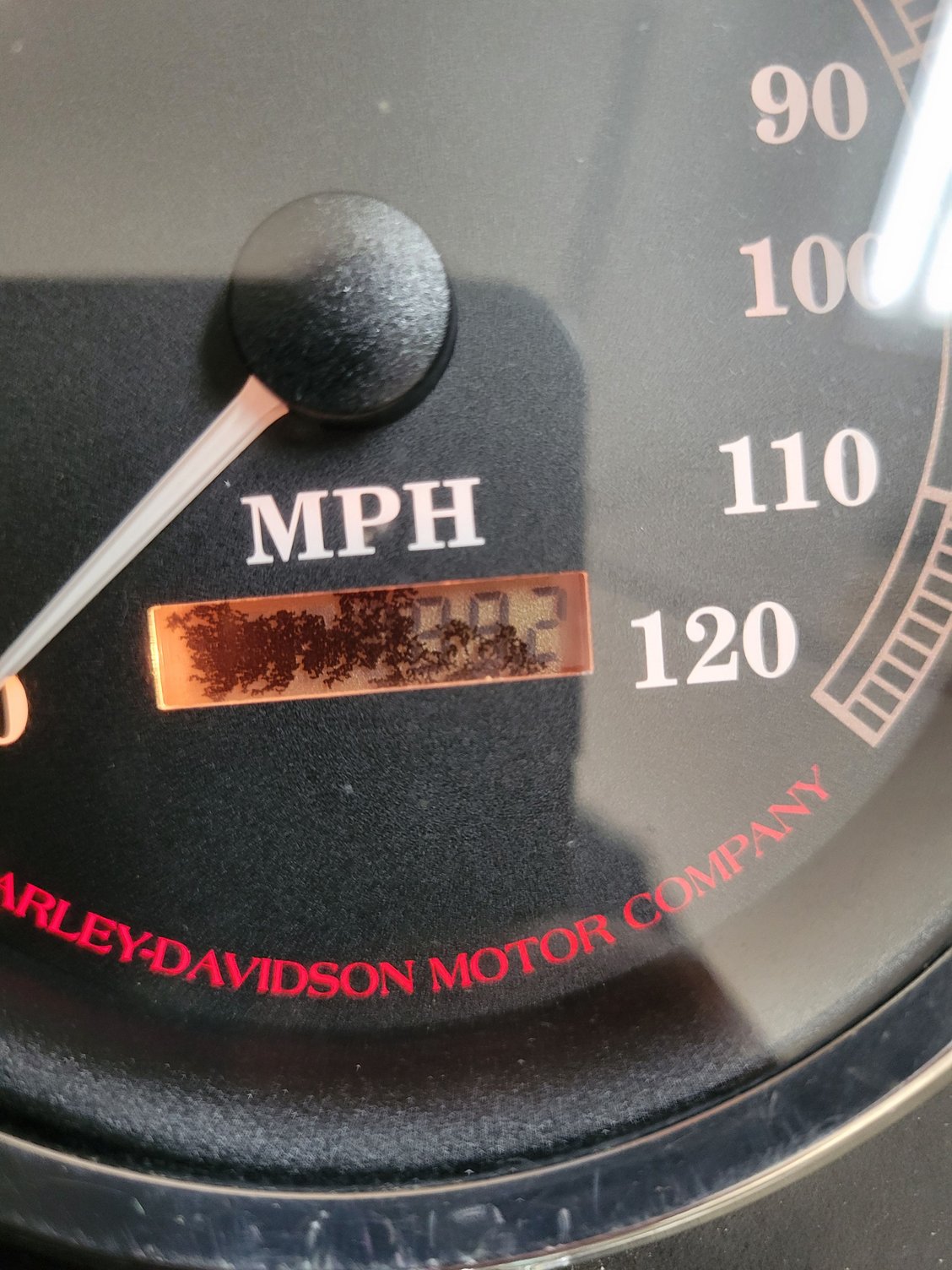

In the same boat with the LED not readable until warm and what started out as light ink leak on left had side, is now growing more to the right isntead.
I will need to so the speedo swap at some point , or at least pull it apart to replace the LED. The only thing holding me back on changing the speedo itself,and still trying to find a program to reflash the mileage in the replacement to the original speedo mileage, and unless I can find a program for that (maybe something like PonyProg), may still just pull it apart to do a lcd screen swap isntead. I already pulled the gas gauge on the bike to fix it, so pulling a speedo apart to fix it, not the end of the world.

My '98 Super Glide has a bad LCD too and FWIW Minitools now sells a replacement, I bought one but haven't got around to installing it yet.
The link below for the part also has a video showing the replacement process.

Just sent mine off to have the lcd replaced, if anyone wants to keep stock gauge you can check them out.
Mostly did it to see what the mileage really was on the bike I just bought. And it was in really good shape other than the lcd having some black spots covering almost all of the numbers. Will post some pictures when I get it back.
When it happens again, which hopefully won't be for years, I will go the new route. It was only slightly less costly than buying a new one + harness.

The EVO era speedometers with LCD odometer are a hard wired unit.
The LCD leak of odometer is rather common for that time.
They are not like the newer speedometer units with a plug on back of speedometer.
The speedometers hold the mileage record.
You buy "0" miles and it will show "0"...You buy 30,000 miles and it will show 30,000.
A 1999 speedometer unit has a plug and can be used as a replacement with a wire adapter harness but mileage situation is the same.
