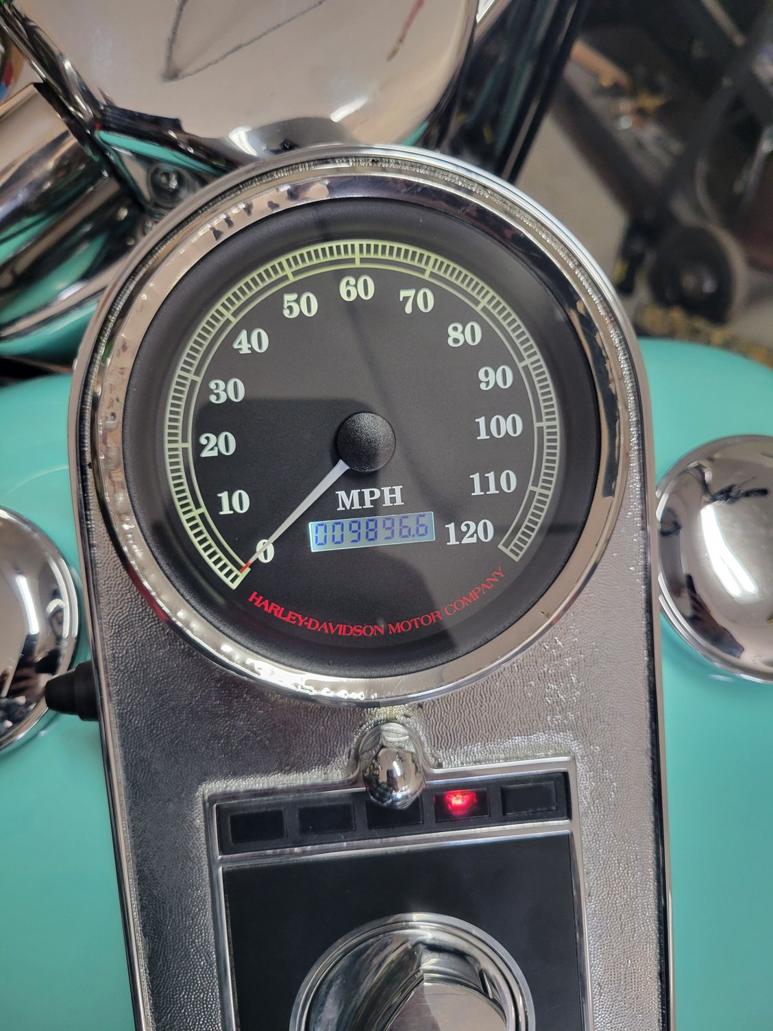

Got the gauge back and it works great. Speed is within 2mph at 60, will say the ring got some dings when they reinstalled but happy with it working again and seeing true mileage. Cost was about the same as buying the drag specialties one, $221.

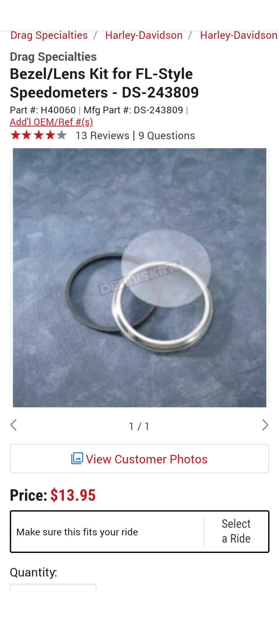

Denis Kirk sells a kit with the ring, glass inf gasket for speedometers pretty cheap.

Good on you for being happy that gauge is working again with correct mileage, but the ring looking like it has hail damage from re-peen'g the ring back in place (hand crimping using the front of bezel at clamping point for pliers), not acceptable instead.
Kind of back in same boat, begin if you don't have a press kit set up to peen the bezel back cleanly, could end up with same same again.
So what is needed for someone that does not have press peen'g Jig kit, is same type kit, but instead of having to peen bezel to lock it back in place on housing, have different type locking system that will not require peen'g instead.

I took the Speedo apart on a ‘99 Fatboy. It was a bit tedious, but I didn’t leave any marks on the surface… the underside shows the trauma!

Glad to hear you got it corrected, and there's nothing like OEM... looks good... ,👍
Yeah, that's kind of a bad business type of move if they even let that go out the door looking like that (unless they contacted you first about it and you said "good enough".)
Removed and replaced mine using all hand tools also. It can be done without the trim ring looking like that.
