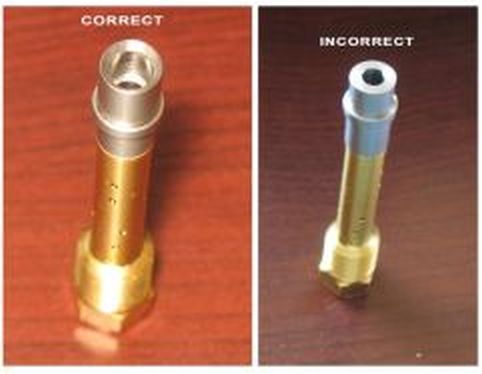

Did you use James blue manifold seals? Did you install the needle jet correctly?
