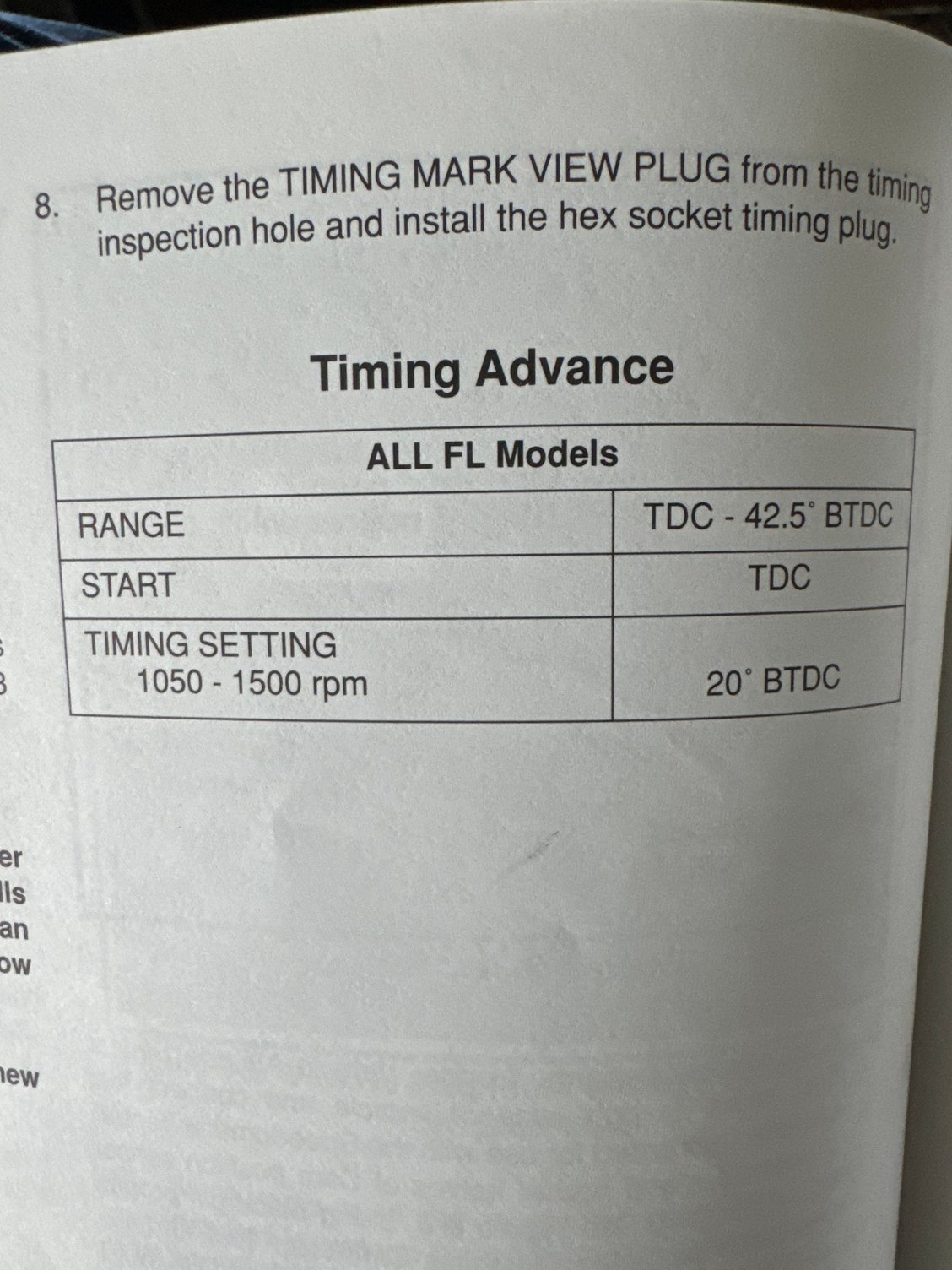

My manual doesn’t differentiate between ignition timing for carb or FI.
Maybe because it’s the MM system?

I'm going to static time it on TDC.
Than I going to Dynamoc time it looking for the 2 dots.
Thats my plan for now!

What manual is that exactly? Year(s) model? Some of the later model Touring came with injection only is why I ask.

97 and 98 softails

Thanks. They all had the same flywheels, but some came injected only.
So long as you static time on the line (TDC) you won't tear up anything.

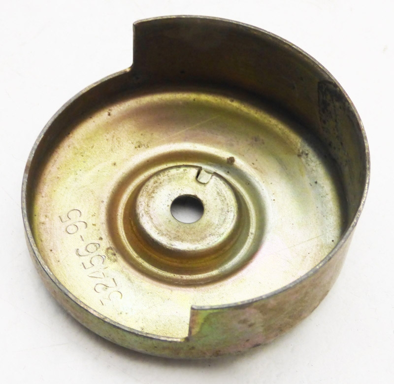

picture of the cam sensor rotor please, since may have a MM in play, instead of one for a carbed by isntead.
The correct one,hd 32402-83, should look like this,
One for a MM bike that year with fuel injection hd 32456-95,
looks like this;
Old Mar 18, 2024 | 03:39 PM
  #38
Marcomeistro's Avatar
Marcomeistro
Joined: Apr 2014
Posts: 29
Likes: 10
From: The Netherlands
I've got the one with the 2 notches!
