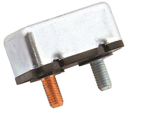

If main breaker has not been changed out in 10 years, replace it now. The 15 amp main breaker is in line with the DC side off the voltage regulator, other side of it has the rest of the connections, and when the breaker over heats to pop it open from just surface corrosion, bike will still run off the battery, but battery will not be charging.
Note auto part store should carry the one you need.
The breaker again, is just a 15 amp that you can find in most auto part stores, or can do a quick search under hd 74589-73.
Gold post is the wire coming from the voltage regulator, and the silver post is what you connect everything down line of the breaker.

Funny I thought of the Main breaker I did replace it about 6 years age with a 30-40 AMP breaker? cant remember is that over kill? and I thought the same way you are with the battery Ill try both good advice thanks Dano523
