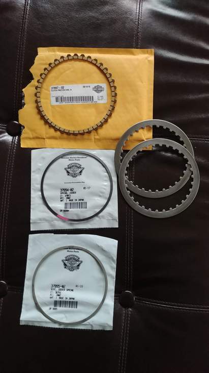

It actually takes a friction plate plus two steels to replace the spring plate and the actuation on my clutch was still good too after going that route...but the squeal drove me nuts so I went to the judder spring setup. Not everyone gets the squeal and some say it goes away after awhile.

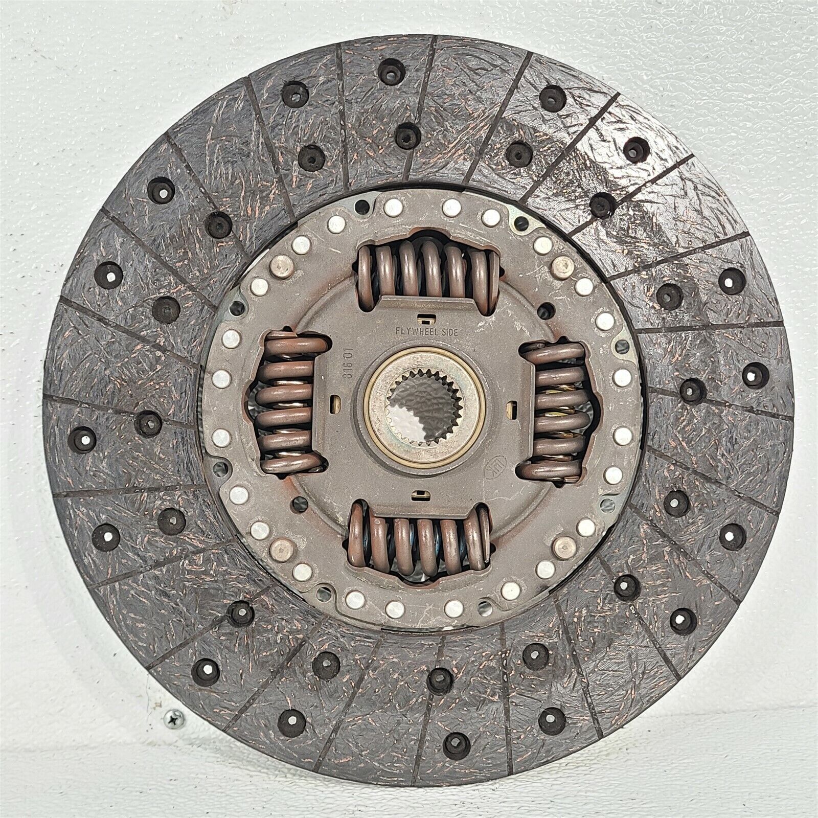

Think of the spring plate in the Harley, or even the concave spring washer in the later clutches, as the springs in a standard pressure plate.
Hence when the clutch friction and steel discs go to lock up quickly/hard as pressure is applied to them, going to cause the plates to want to Grab/load up/ slip/ over and over again ( judder) and the Anti judder system in the clutch prevents such (gives the clutch plates a place to adsorb those shocks and slightly slow down the lock up.
In a lighter bike, less load to clutch from high engine torque and trans speeds match up, but on a heaver bike , hard/fast clutch still slipping hard with motor and trans speeds not matching and you off the lever, the judder noise can sound like the belt is stripping the teeth off the belt (but coming from the clutch itself).

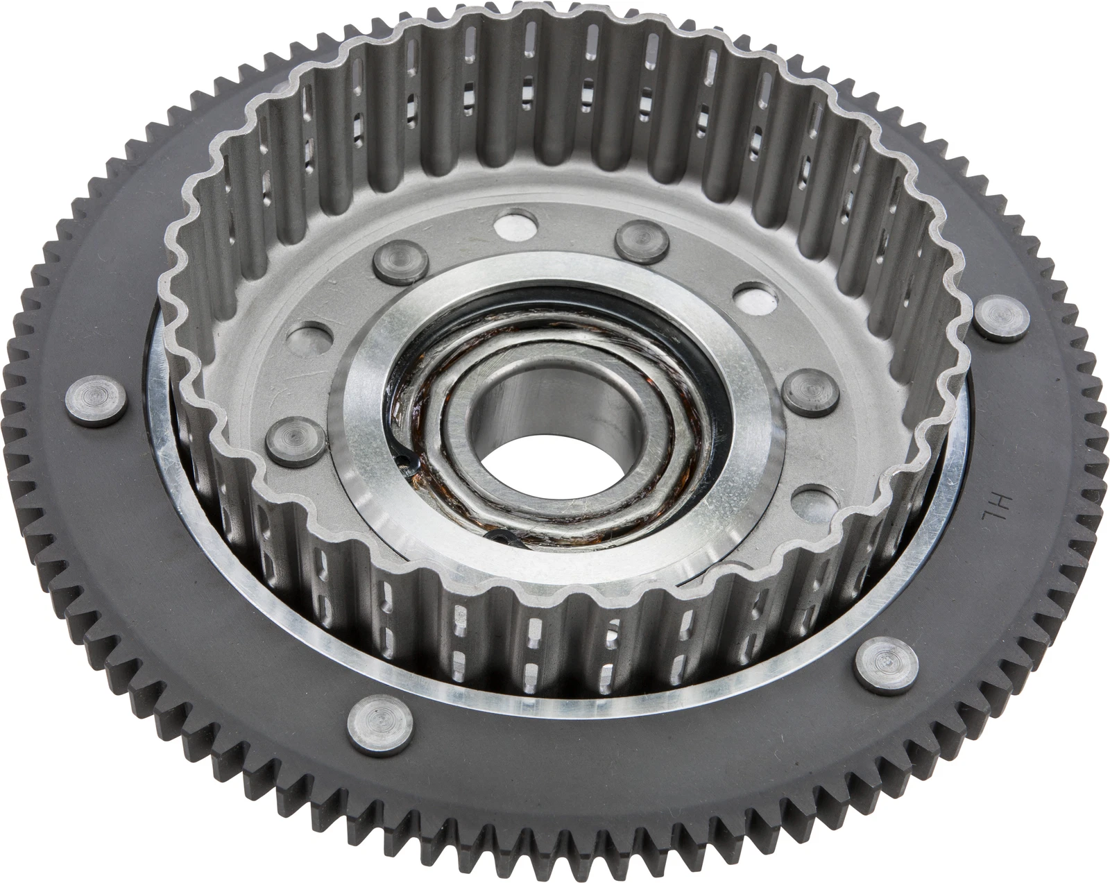

As for 08xl1200r solution of losing the problematic spring plate that the rivets start to fail and cause problems to take out other parts, and going with the later style Judder system on the older clutch basket and hubs, will have to look into it.
https://i.ebayimg.com/images/g/MrYAA...X/s-l1600.webp
But, Kind of lost on the stacking method, since up to 1997 back outer basket not squared edge/flat bottomed for the spring disc to drop in first, like the later 1998+ type baskets below with outer bottom channel for the concave washer springs in the first place.
