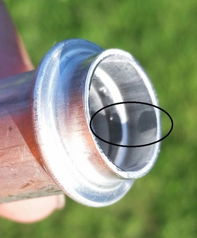

If you are going to pull the lifters, check the pushrods and pushrod tubes for witness marks near the top of the tubes. I chased a maddening ticking forever...
the tube.
