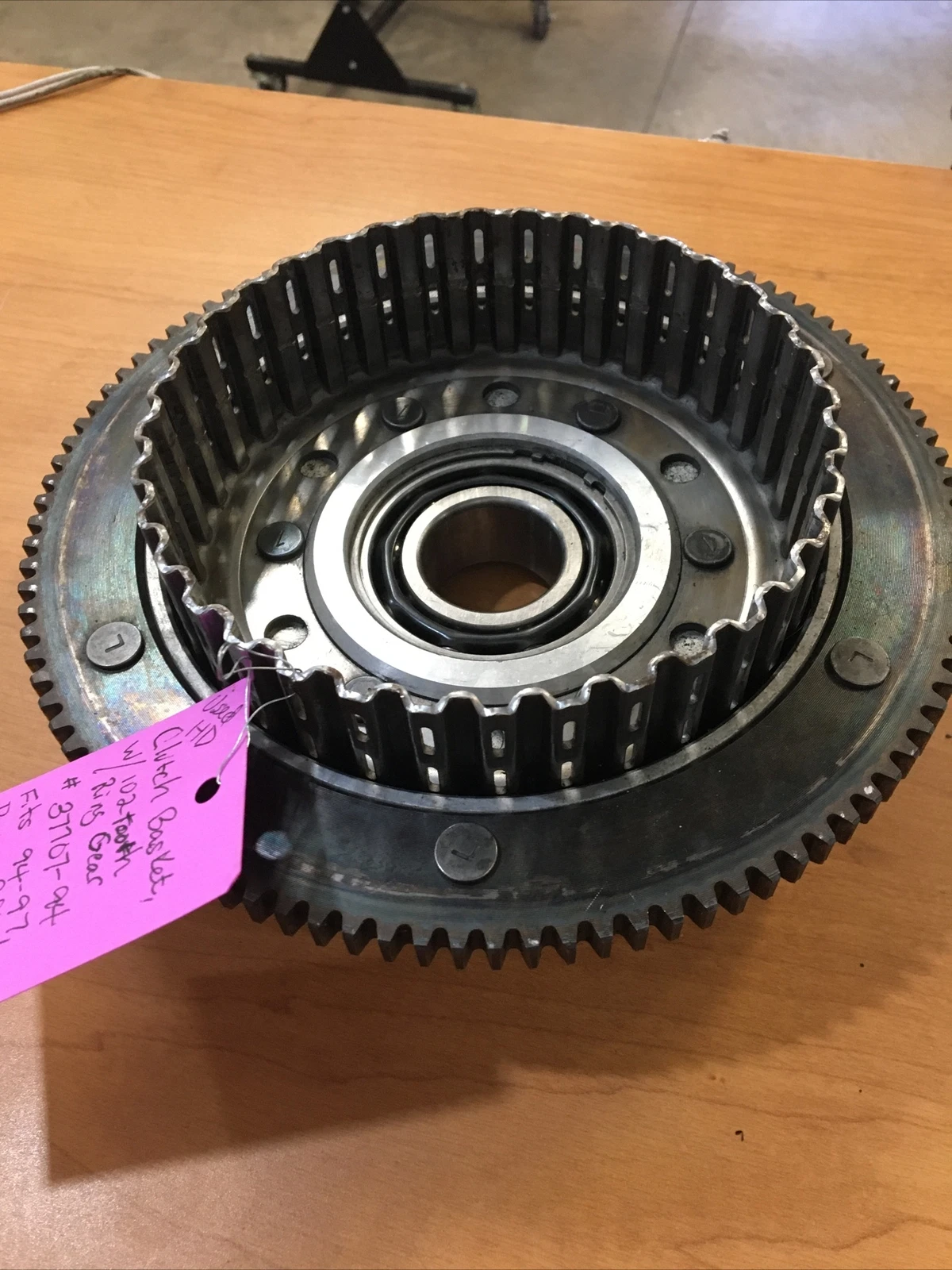

Originally Posted by Dano523
Can see them working in the Buell clutch baskets above, since there are flat areas for the springs to work against..
Not the case on the evo 97 and older baskets isntead, so no solid flat area for them to work as shown in below link (short of lathing up an add in base bottom concaved/top flat additional ring, to covert the pre 98 basket base to a flat surface to start with for the judder springs to work correctly)..
https://i.ebayimg.com/images/g/7dAAA...u/s-l1600.webp
hmmm, well in that case the judder spring parts MIGHT work if they were installed between the first two steel plates.
