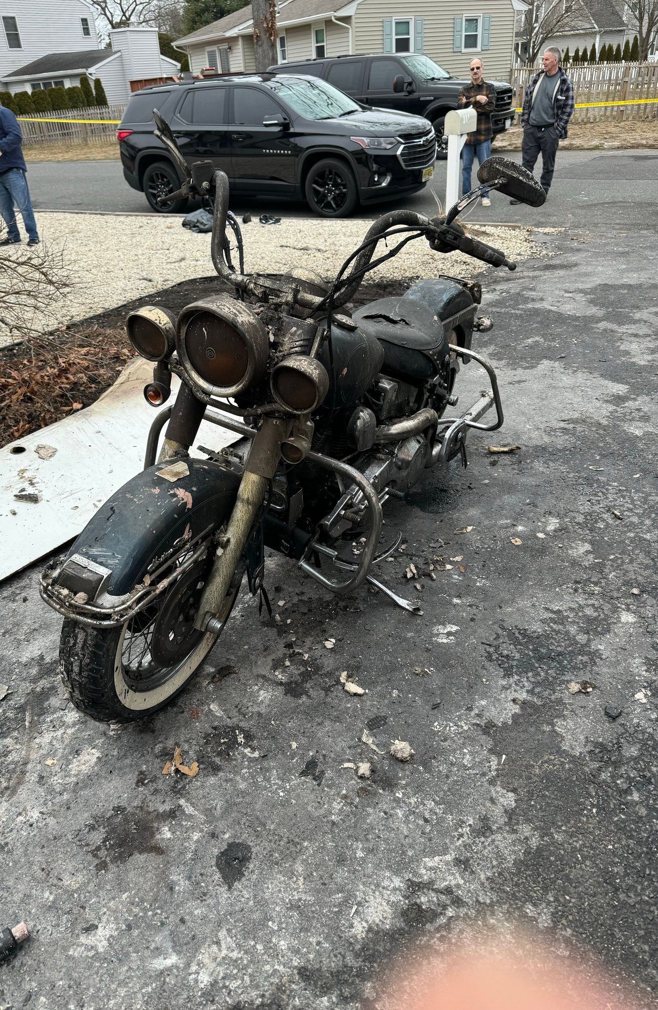

The top pic is 4 days before the fire.

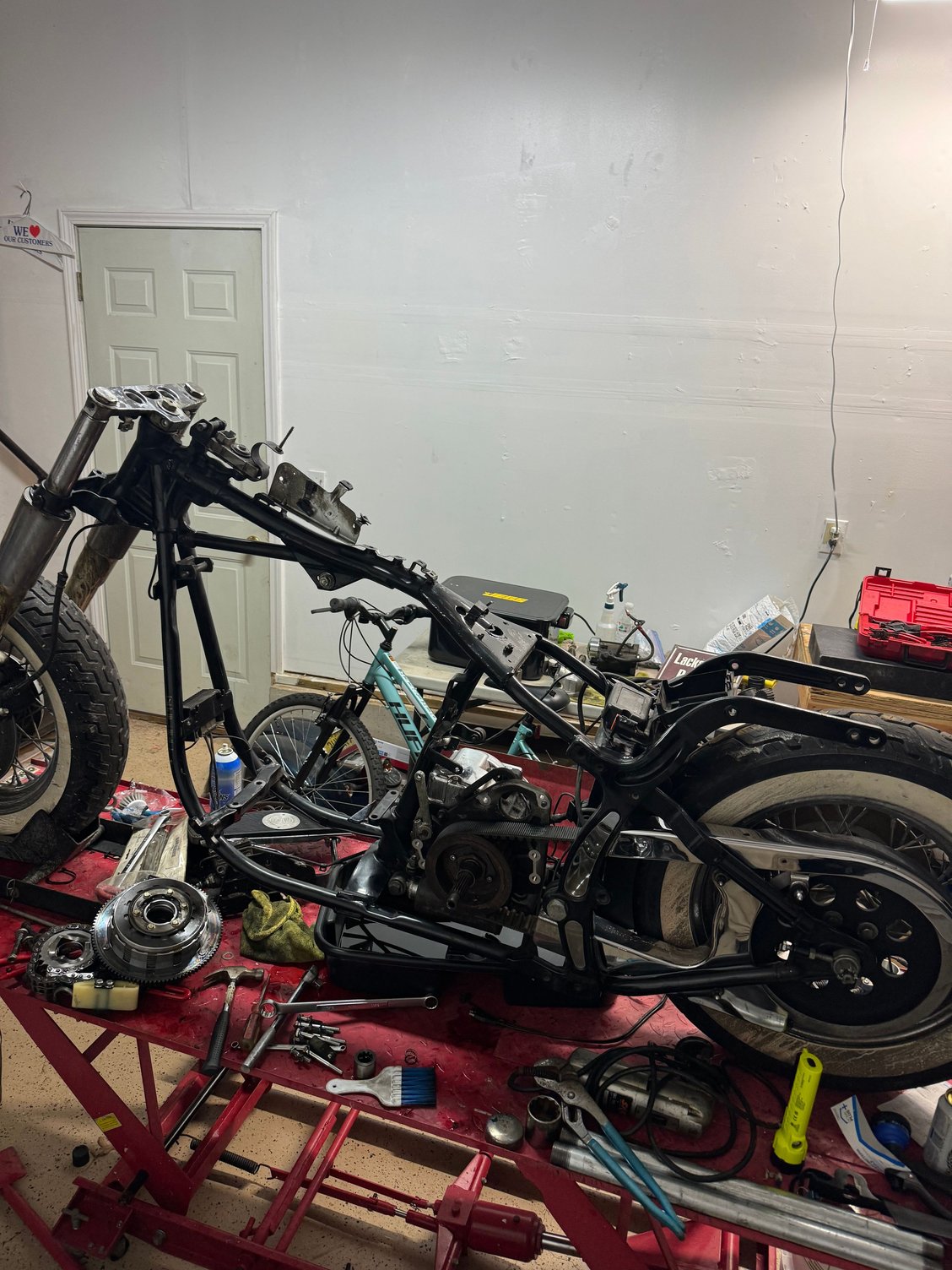

Currently
