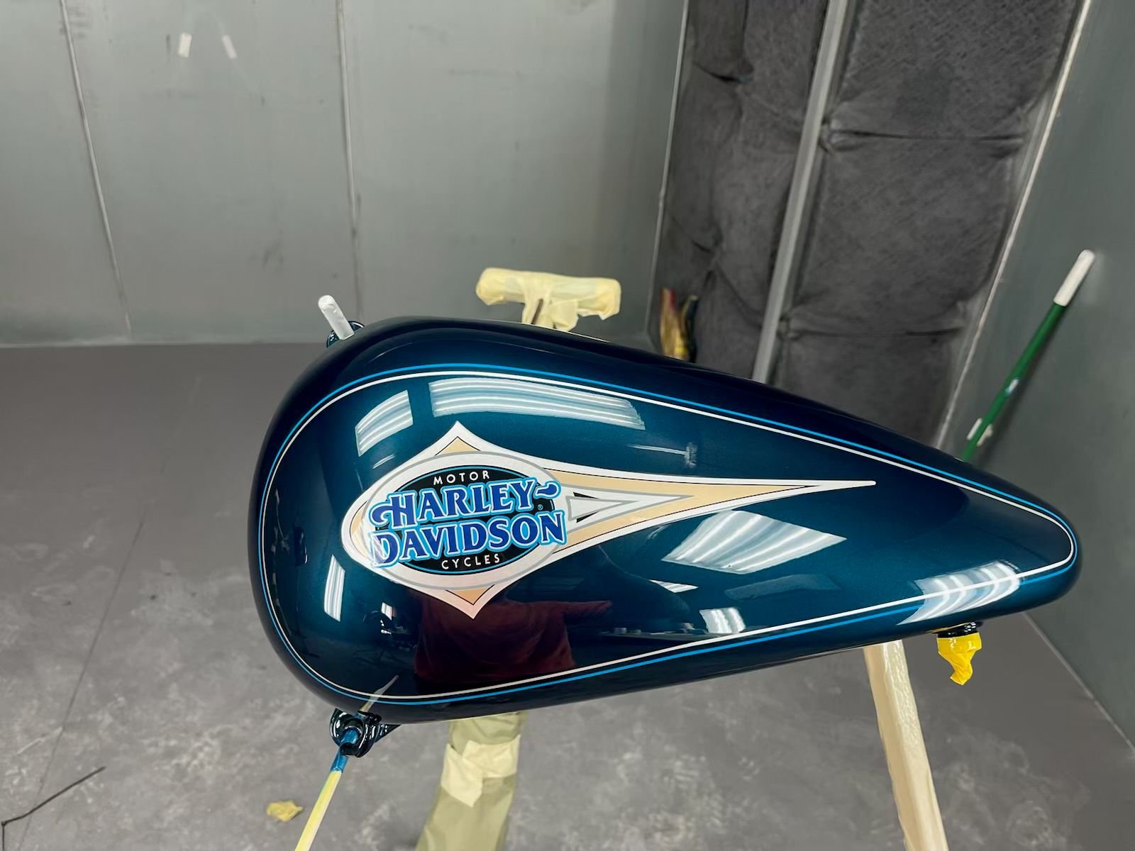

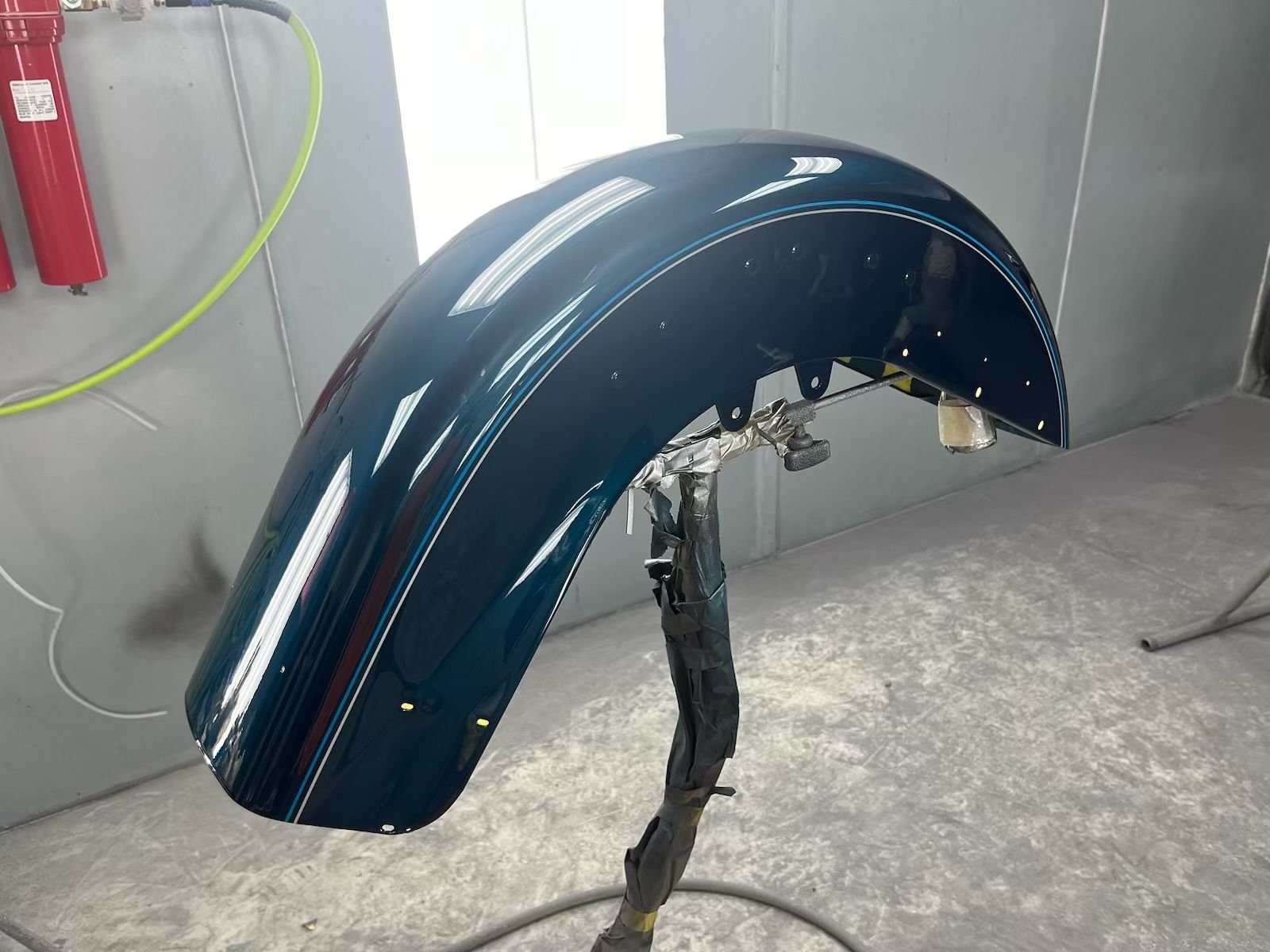

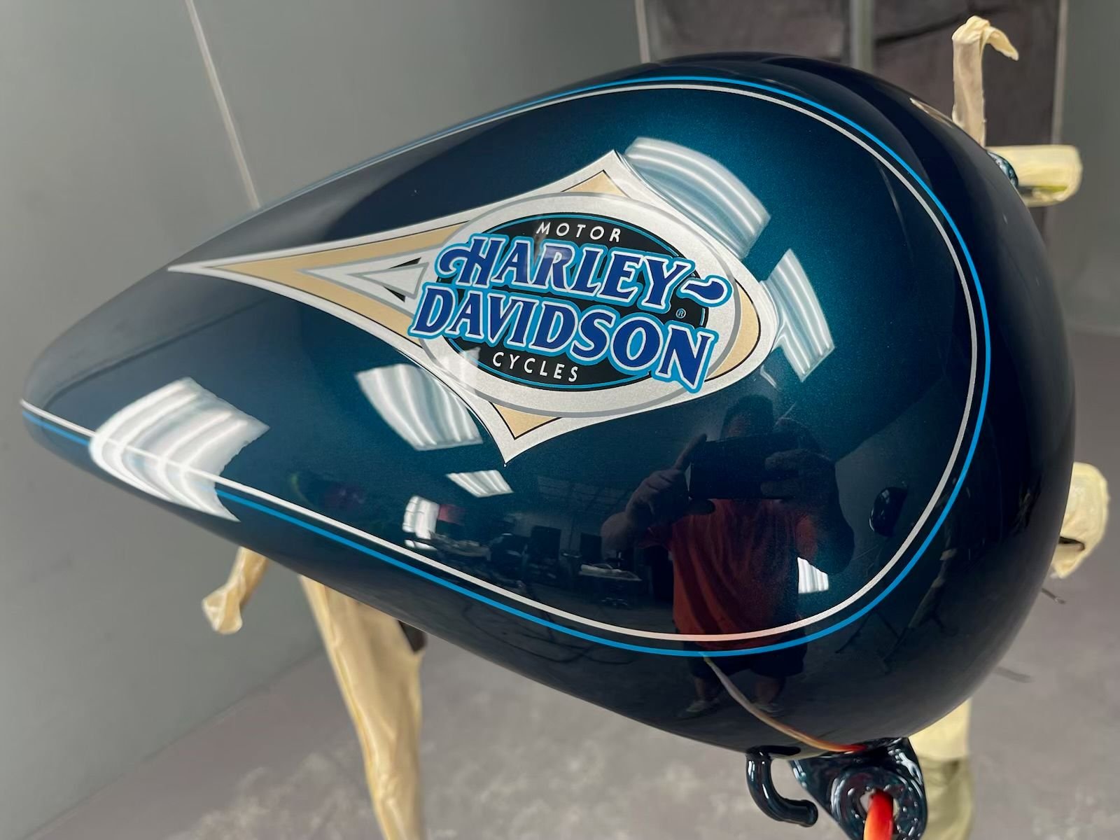

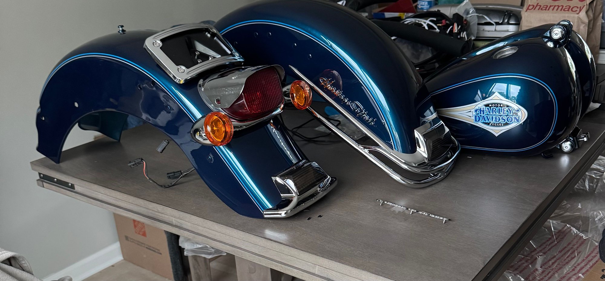

Finally got my tins back from the painter.

That is looking real good... Nice job.....

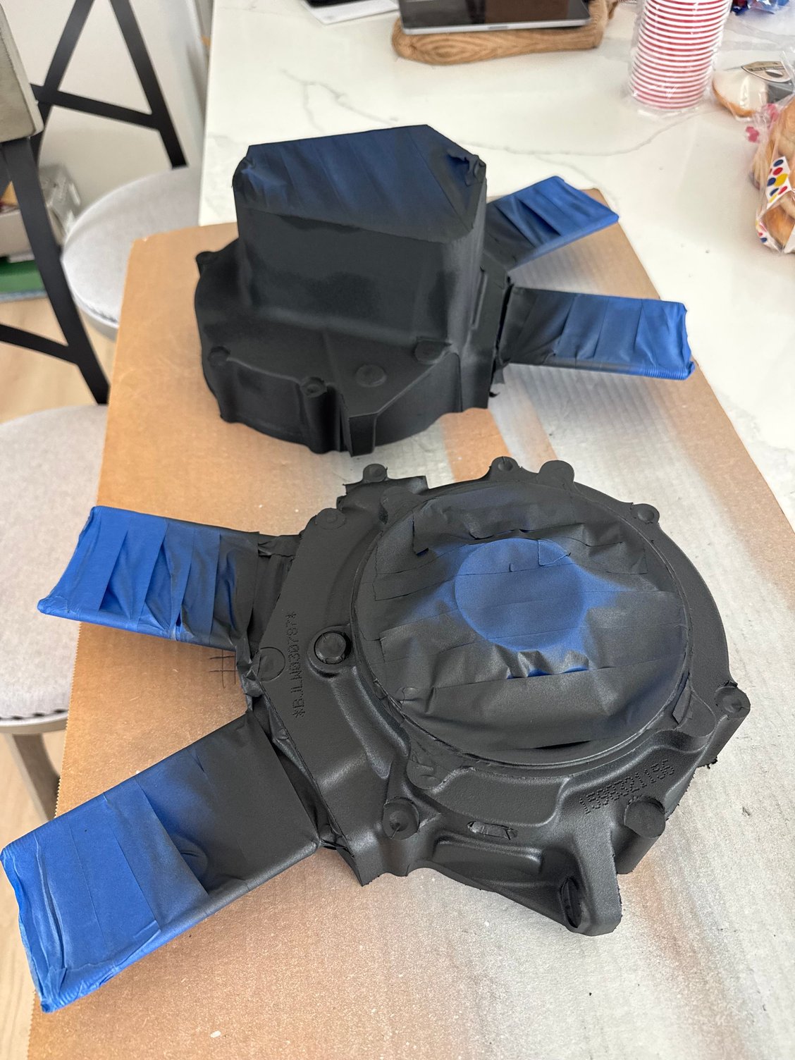

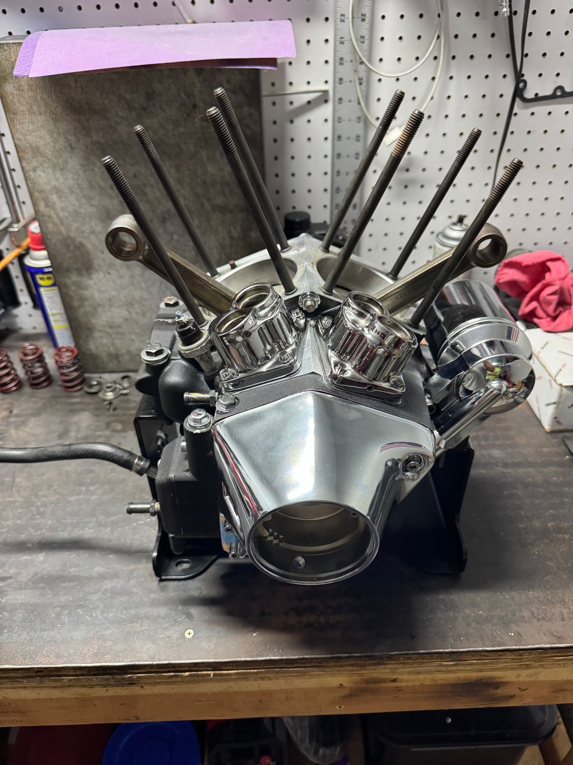

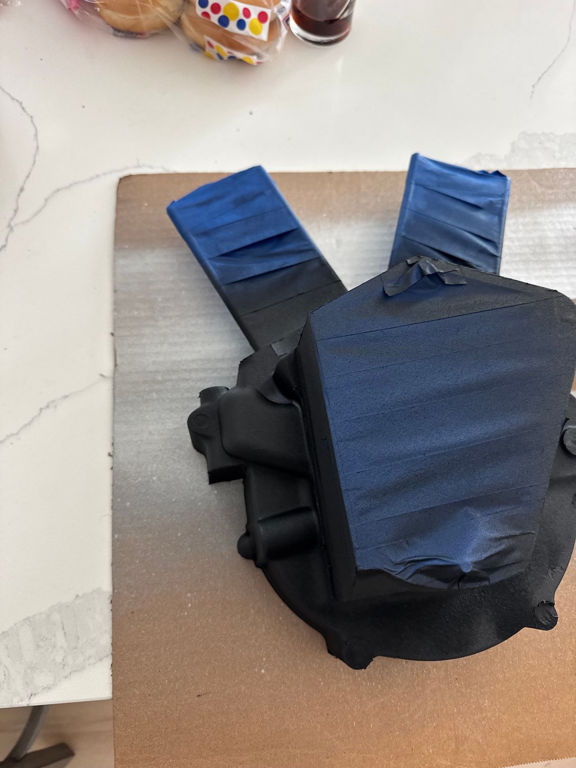

Cases all painted up

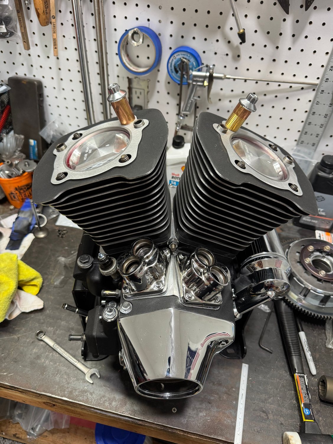

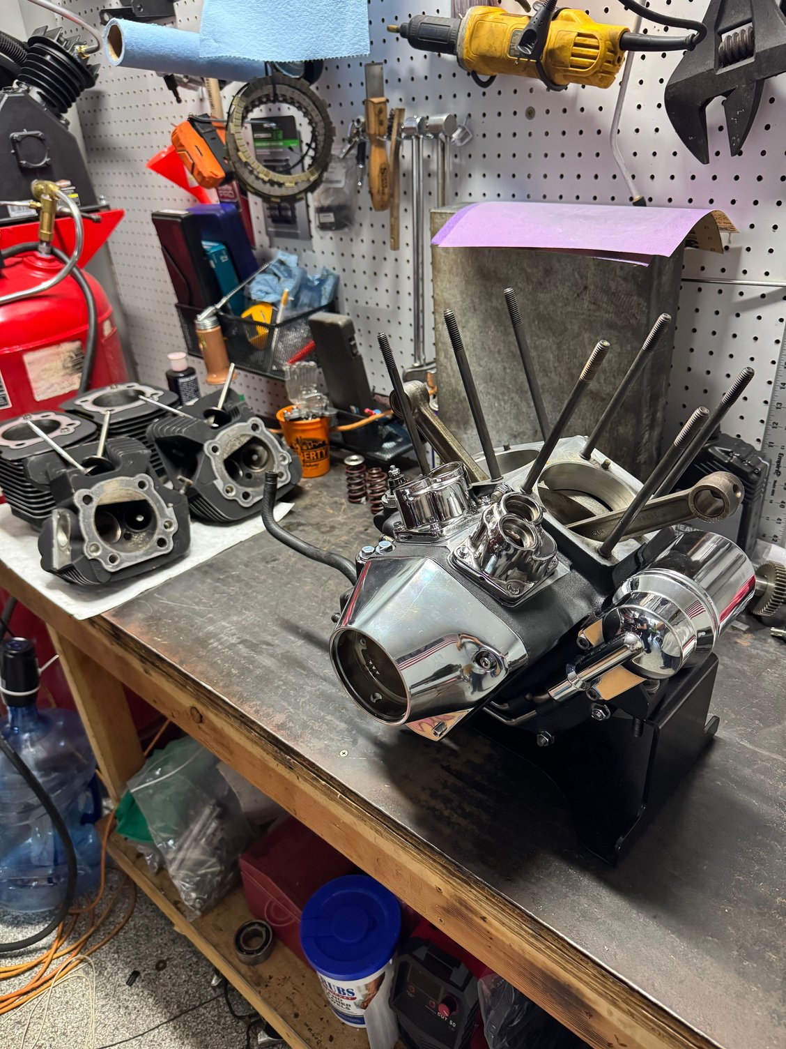

Crank case is all assembled, seems like it took forever lol.

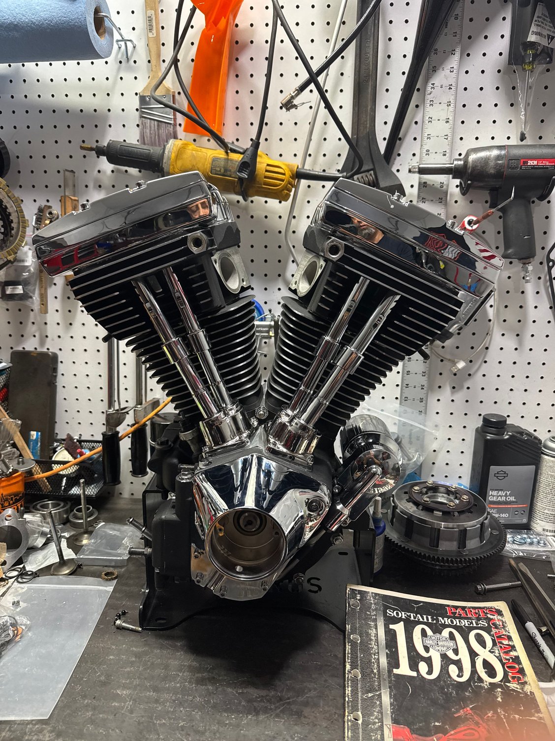

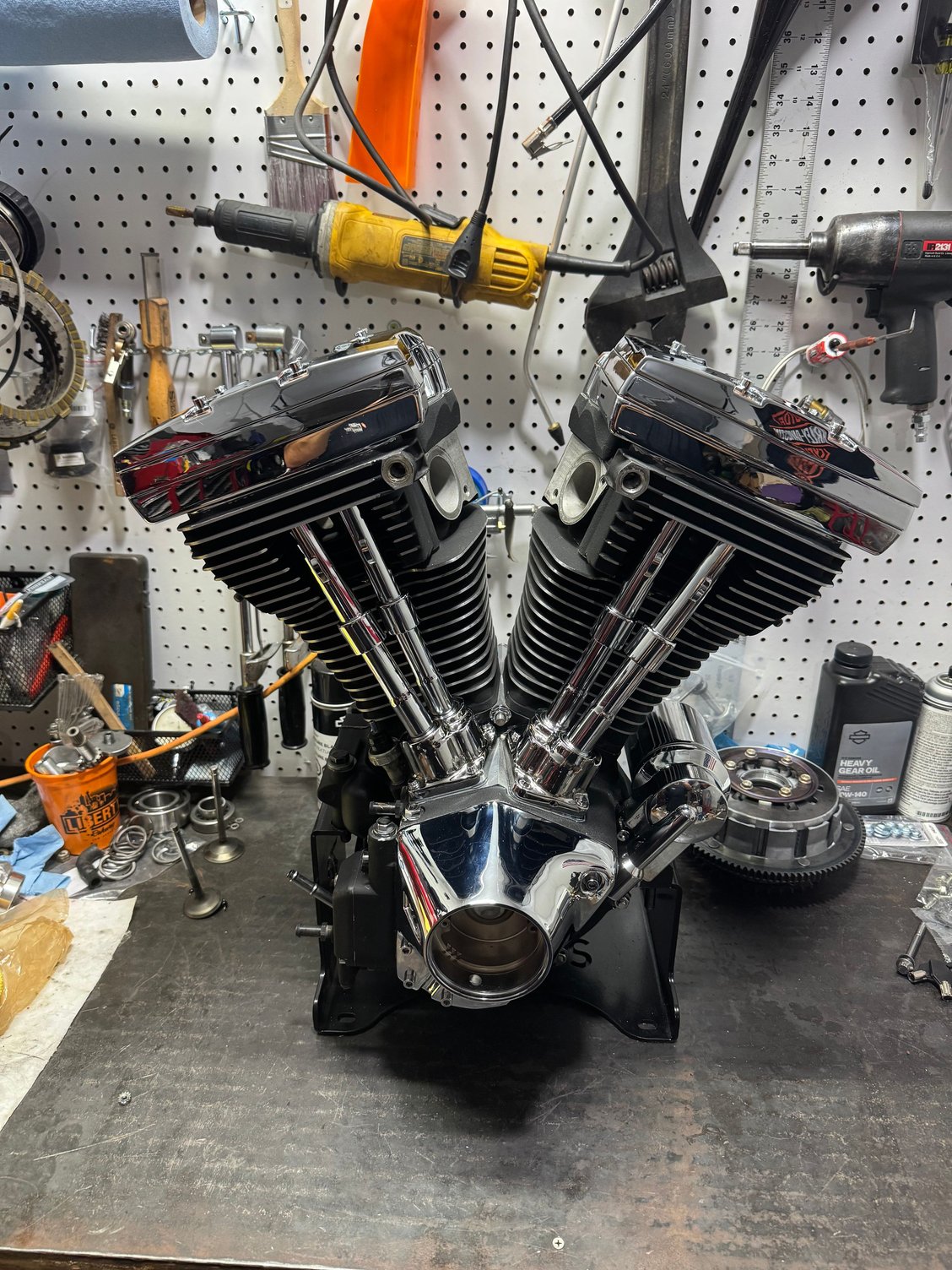

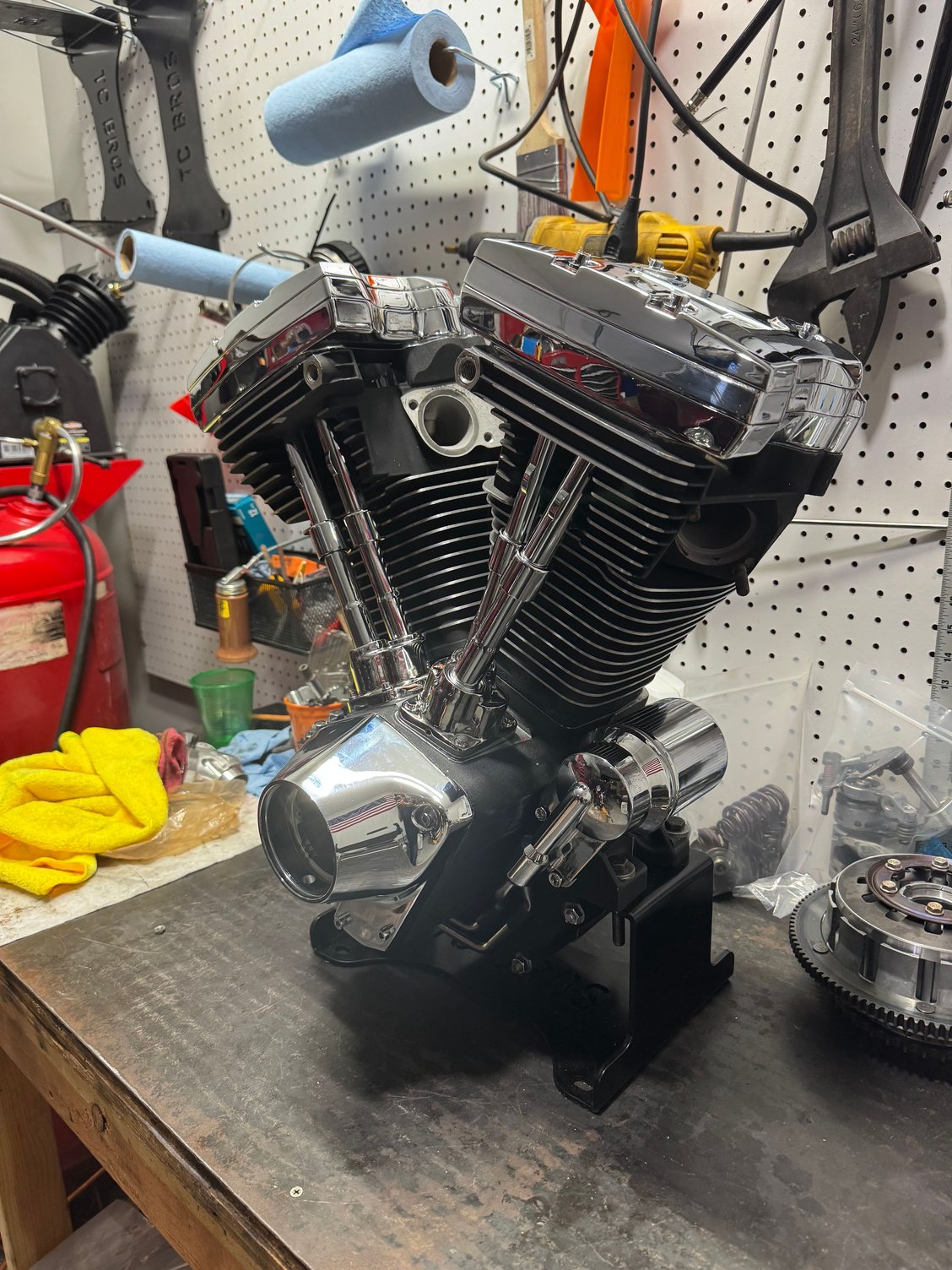

Progress, ready to be put back in the frame.
