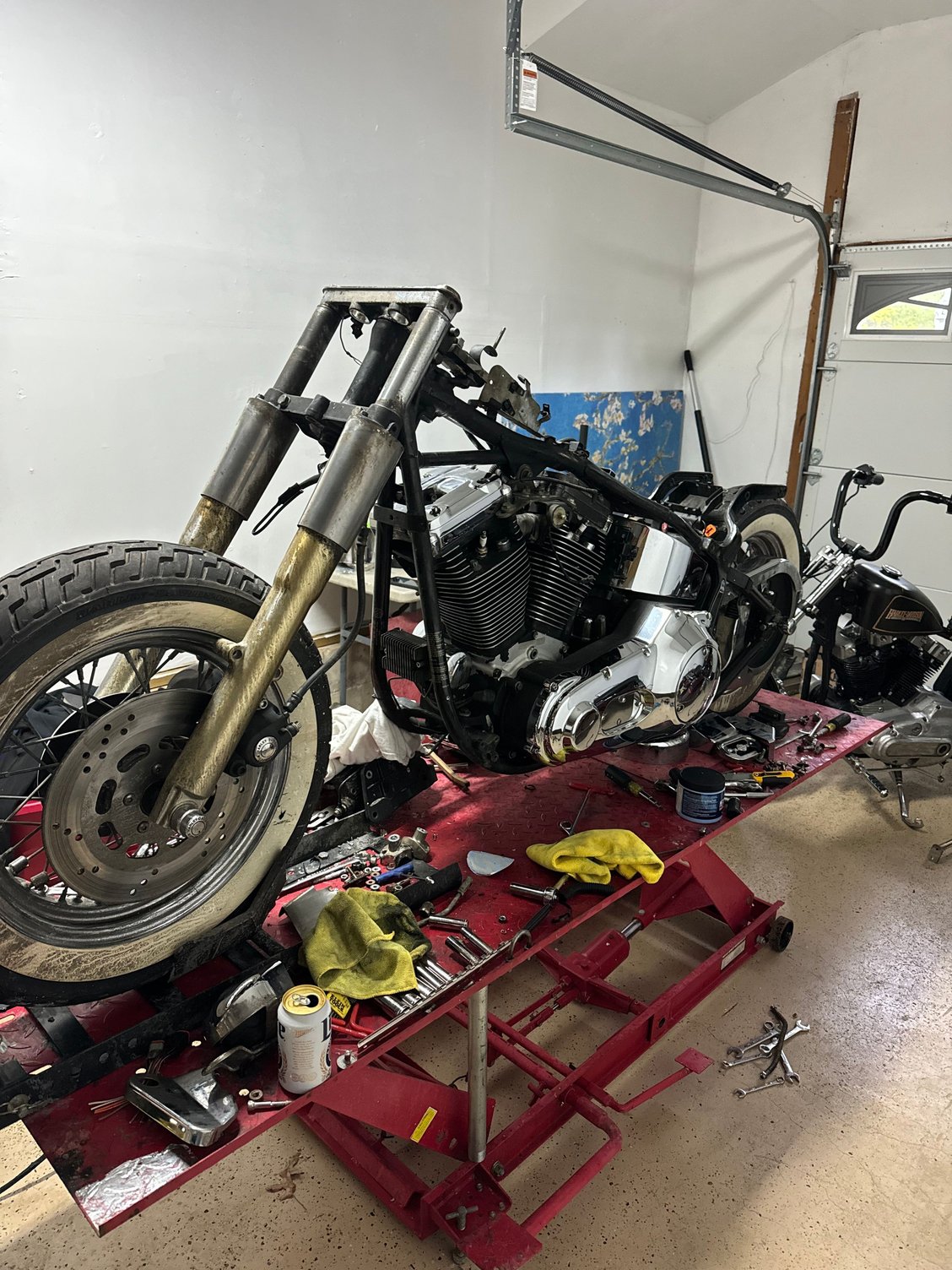

I have the bike stripped completely down to the frame for cleaning degreasing, have to get the soot from the fire off everything. Tins are going out this week for repaint, I’ve since spent enough money my wife wants to kill me by buying most of the new chrome. Picked up brand new Dunlop American Elites www tires, picked 2000 up chrome fork sliders, brake caliper and spoke wheel. Also picked up a set of 05 Fatboy handlebars, like the look. It’s on its way.
Onto the motor I got a set of weisco 10.1 pistons, EV46 cam, still have to get an ignition and carburetor, I still have the Mikuni 42 so I could put it back on but was thinking of getting an S&S E carb.

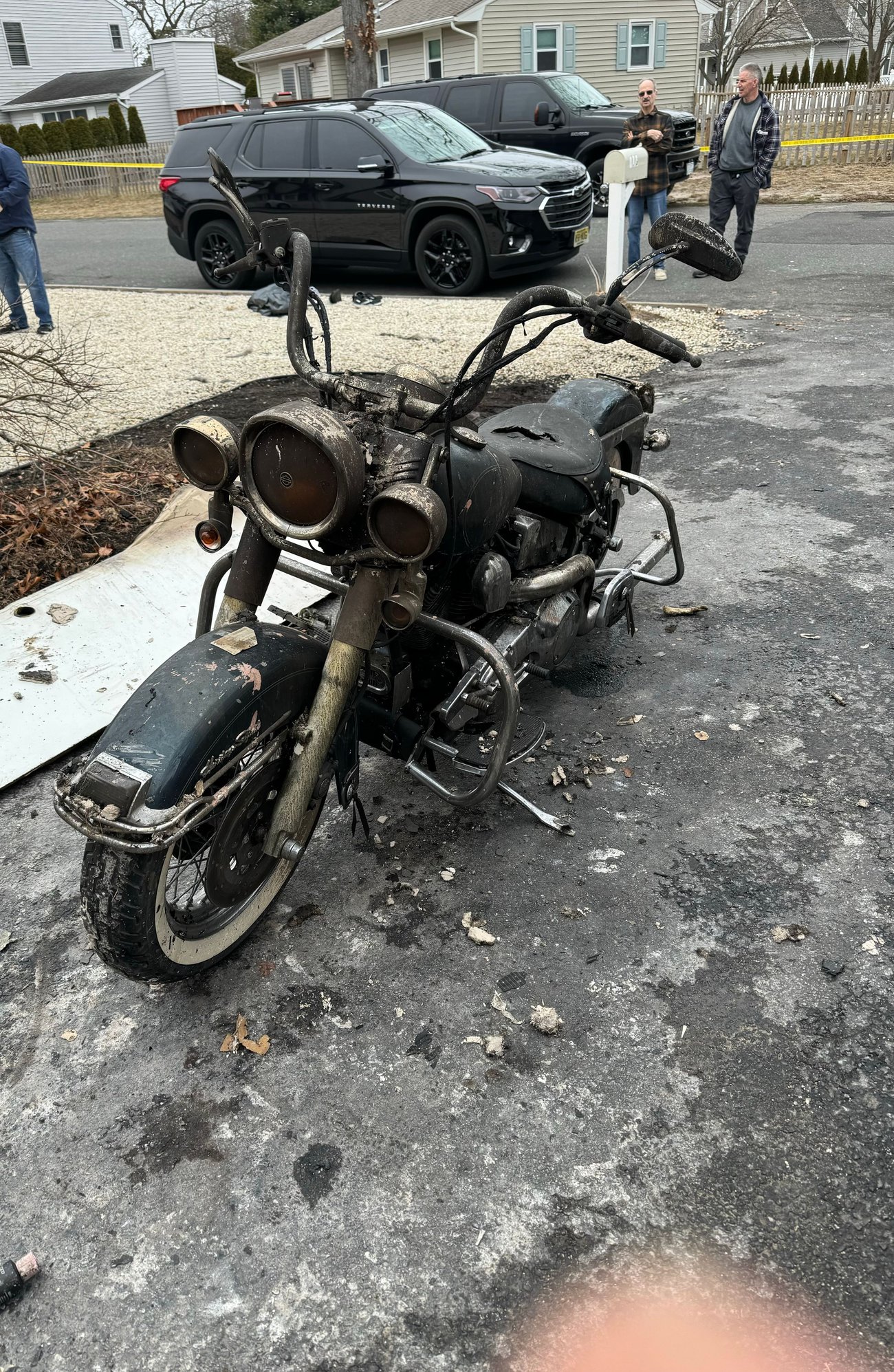

Just some pics, the top pic is 4 days before the pic of the burnt bike. Truthfully i could’ve just bought another heritage of the same vintage and probably saved some money but it is what it is.

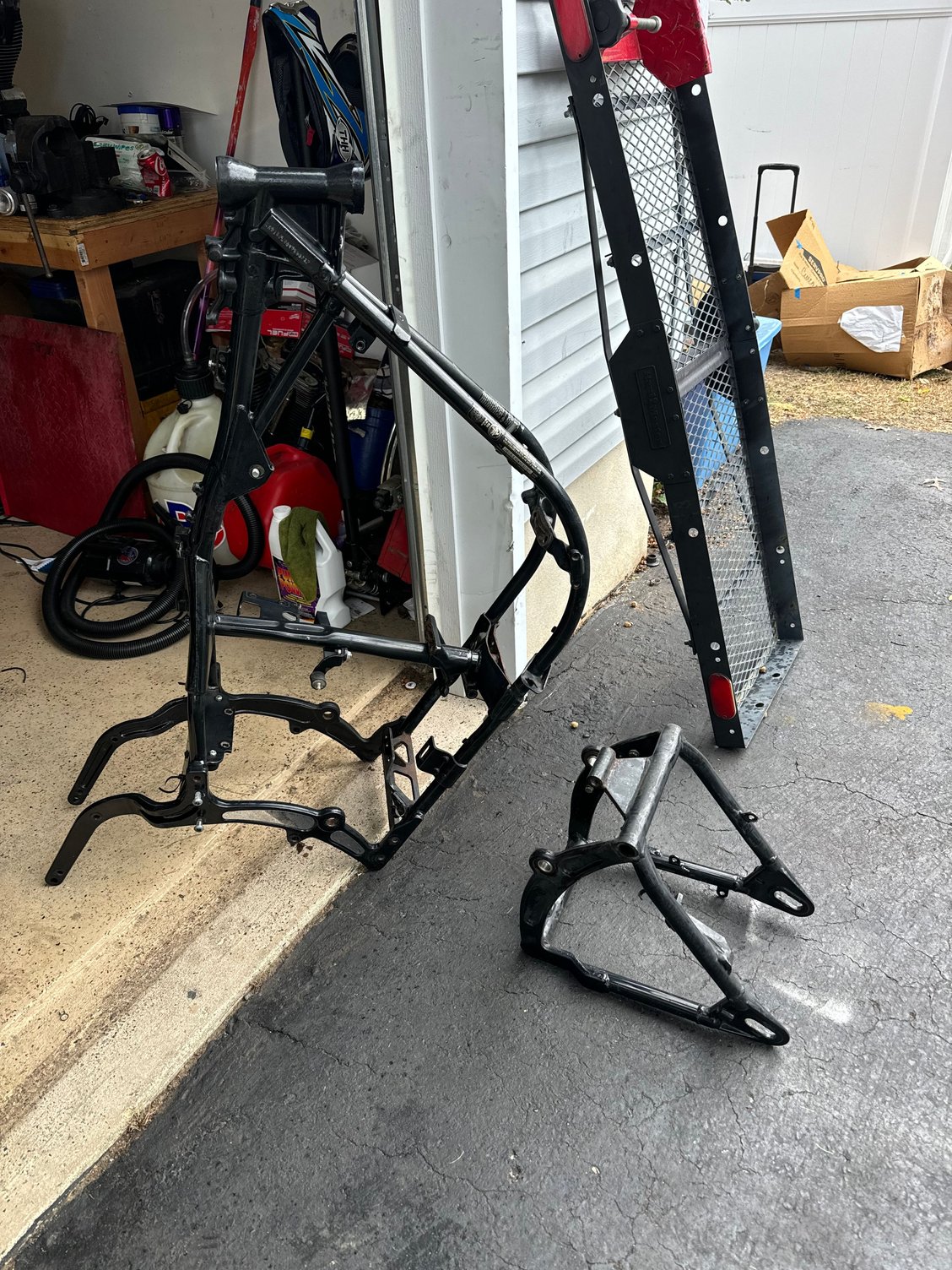

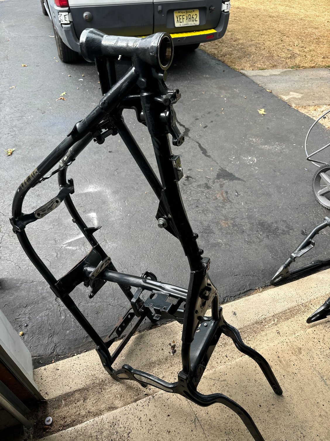

Well the frame is completely stripped.
Before I go on I want to vent a little, a bit at myself. I always wanted an Evo Heritage probably going on 30 years now, finally I get my bike January 7th this year a 1998 FLSTC 30K for 5G, 4 weeks later my house burns down and takes 4 of my 5 Harleys with it, 5th was a 76 Ironhead kept at the neighbors garage.
The Heritage suffered the least damage and as I went through the carnage the next day I’m thinking, it’s not too bad just cosmetic and we’re good, that was Feb 11th. Fast forward to now and everything is apart and I can go through everything with a fine tooth comb. On top of fire damage their is 26 years of neglect, this bike was showing its age from everywhere, then add in the probably 1000 degree garage fire it was involved in, so the quick cosmetic resto has turned into a complete restoration which now I wish I didn’t get involved in. Could’ve bought another one for much cheaper. But I’ve spent a lot already and now am fully involved. Might as well just restore it fully.
The frame is stripped and heading to the powder coater because it’s all discolored after degreasing and power washing and a lot of the under frame spots are bare and rusting. On top of no matter what I do I can’t get the fire smell off the frame. So in the end I’ll have the most expensive 1998 heritage. I am enjoying doing it though.

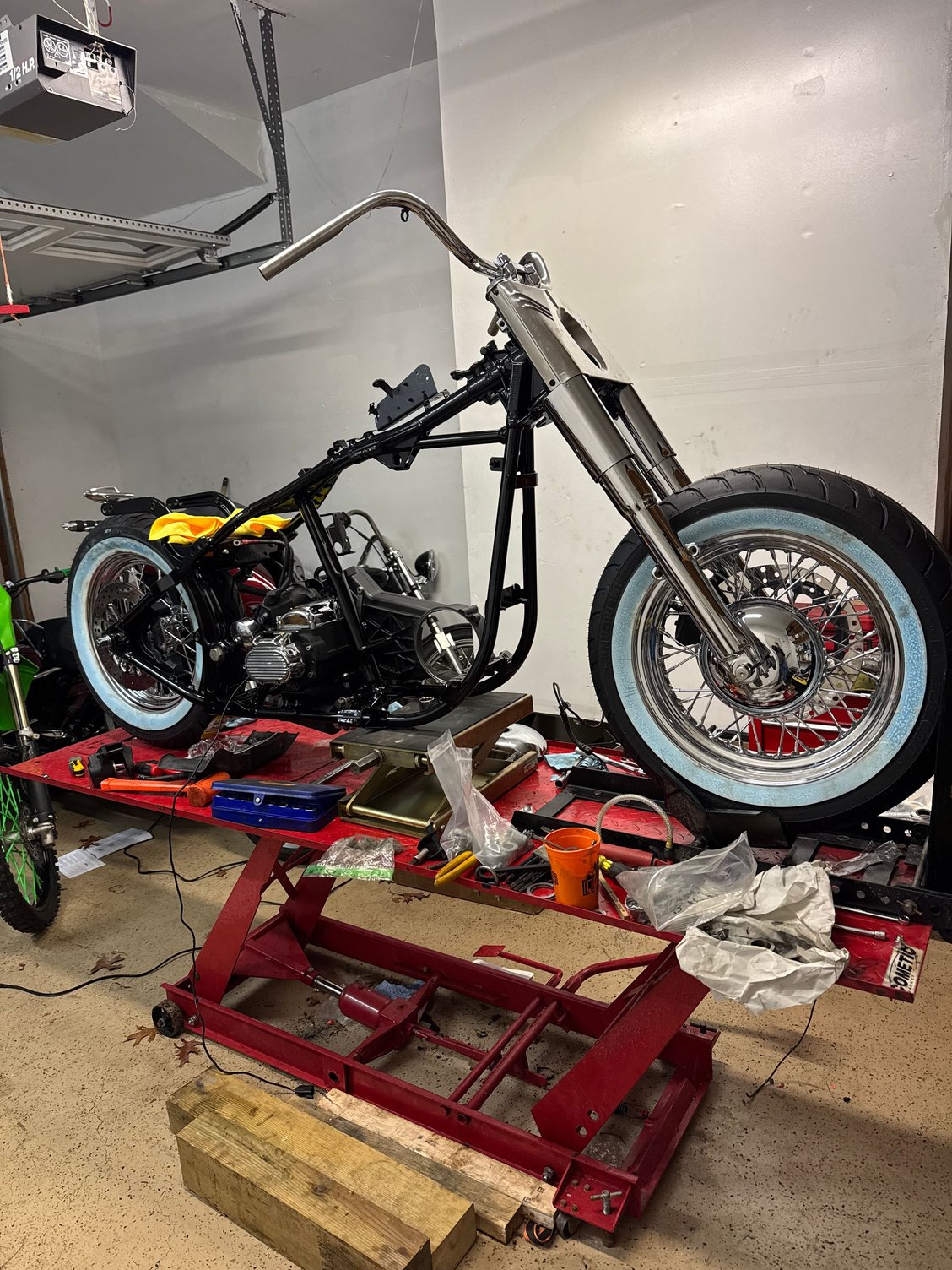

It’s back and I started the build back.

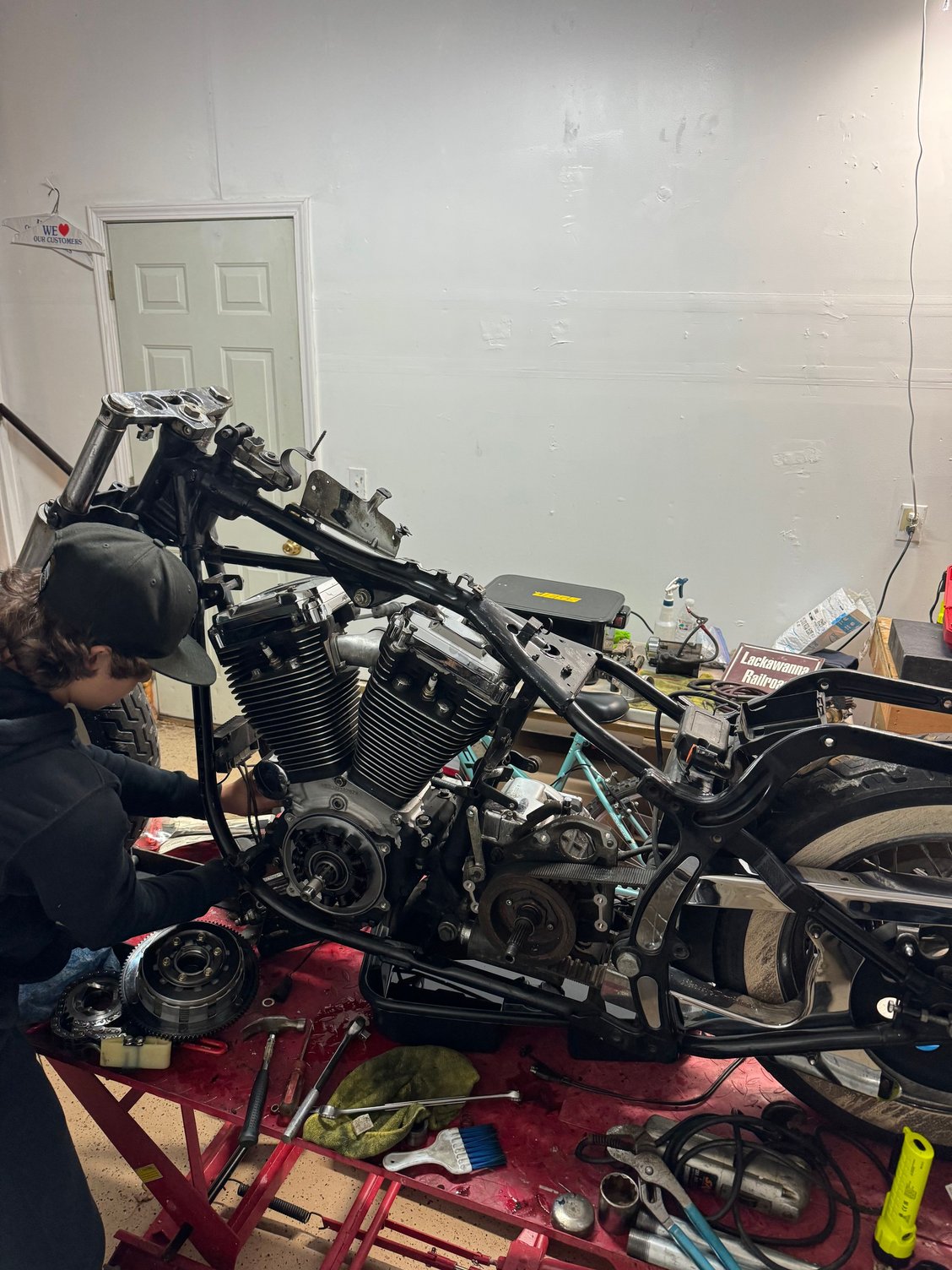

The tires are Dunlop American Elites they seemed to be a softer compound than the D402s. I swapped to the 2000 up fork lowers to run the 4 pot caliper. Tins unfortunately are still at the painter, but I told him take his time. I also picked up a 2000 road king clutch and compensator 24/37 tooth. Now I’m on to the motor, got an Andrews 46 cam Dyna 2000 ignition and coil, Weisco 10.1 pistons, sending the heads out to WFO Larry for light porting. Coming along, I’m not divorced yet soooo lol.
