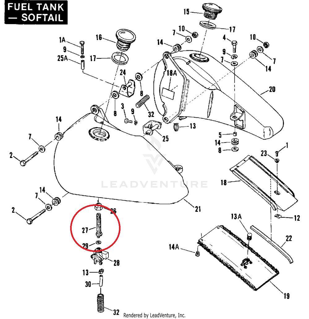

Line should be routed between the cylinder heads to the carb without the line going down and back up again, this will always cause issues. Line should be from the petcock to the carb so the fuel flows downward all the way to the carb
Ref:27
62166-81A
FILTER, fuel valve
