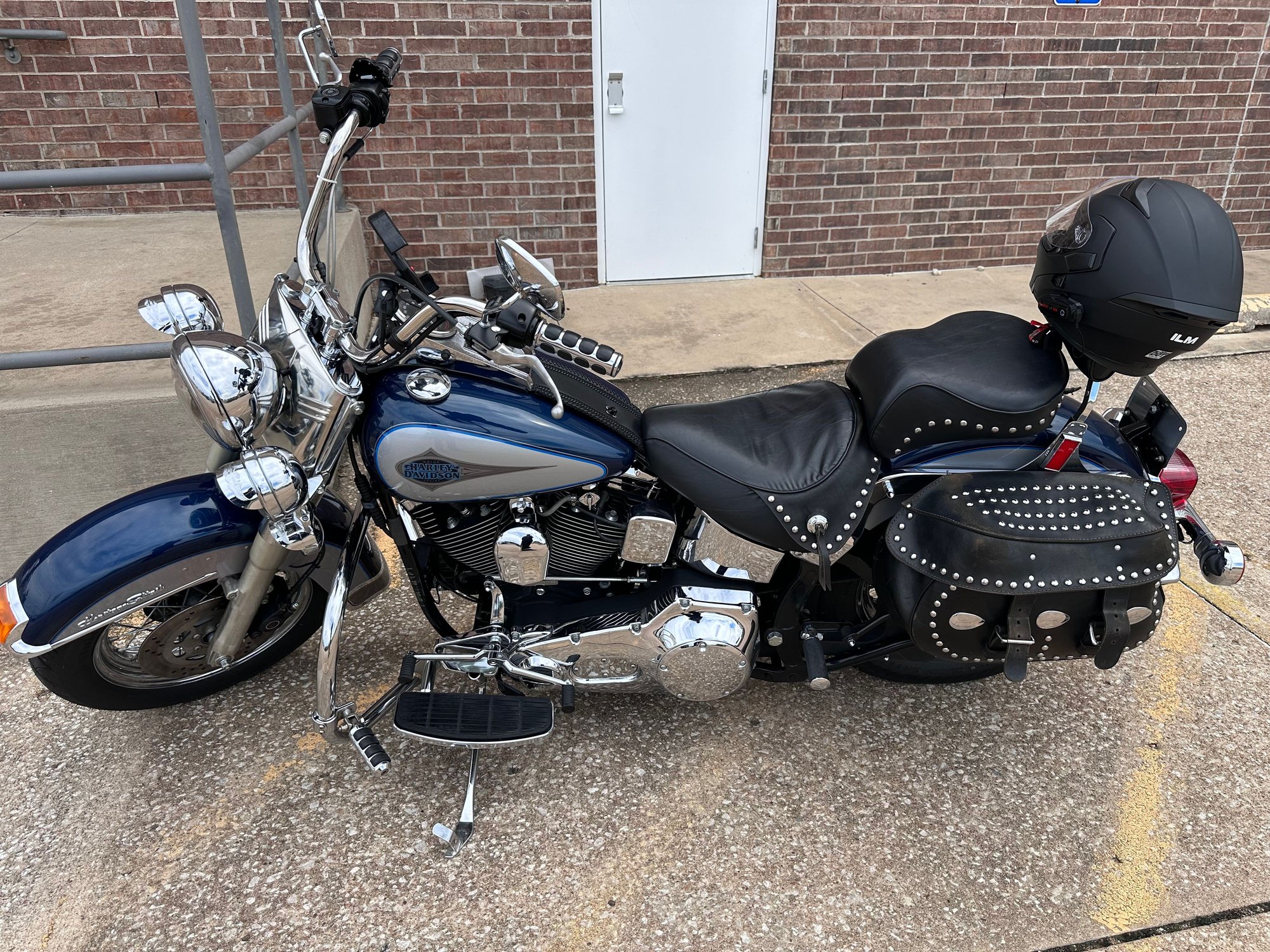

So I recently rebuilt top end, single fire ultima, EVL 3020 cam, Wiseco 10:1, honed jugs, replaced the stupid plastic **** with steel. It has stock pipes w/ screamin eagle II slip ons, k&n, w/ external breather. CV40 carb
My question is I don't have timing gun so do you adjust the timing then the carb by ear/feel. I've been tweaking on both but it's idling weird and kinda sluggish just above idle like rolling thru the hood. I'm not sure what might be the new cam or if it's not tuned right.
Anybody have a good procedure for how they go about this?
It almost sounds like one cylinder is double firing more than the other sometimes.
I can try to record it and post a link if that will help?
Thanks
