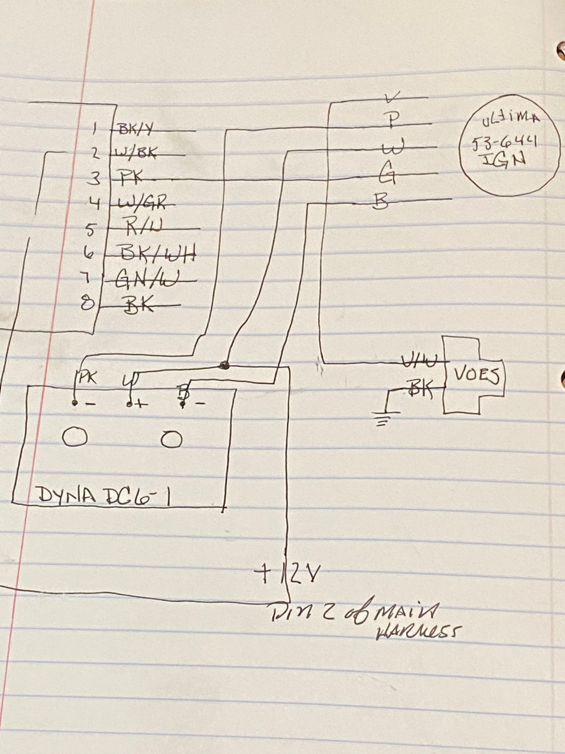

Old Nov 5, 2024 | 01:05 PM
flhchaz's Avatar
flhchaz
Joined: Sep 2011
Posts: 3,126
Likes: 1,755
From: In The Woods, PA
Wiring diagram. I used and ultima igmition, a dyna coil, and a voes used off of ebay
