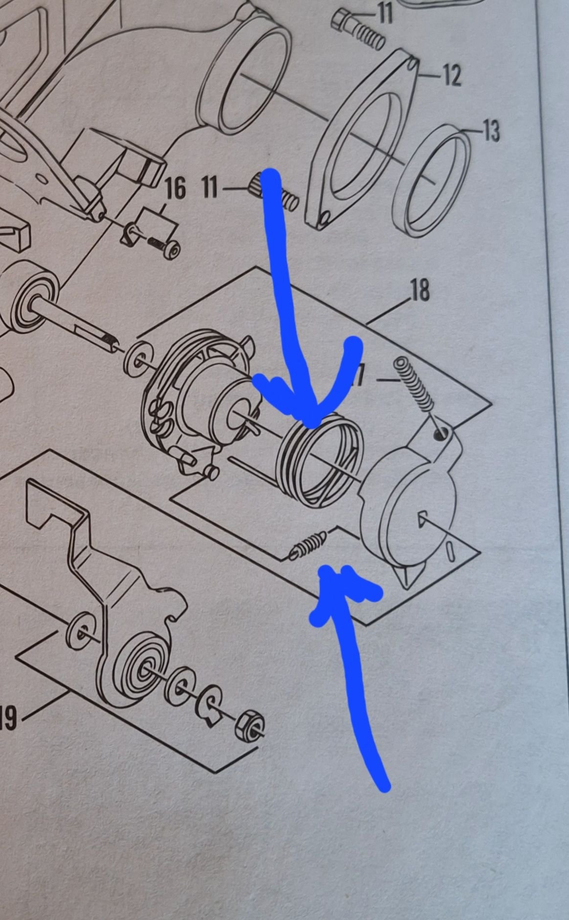

[QUOTE=GOGOBECK;21858499]I have a RK Classic with MM, it starts easily and runs great.
The only part I know of that is difficult to find is the ECM… there are always several available on eBay ($350-$500) from folks that have converted to carb.
Anyone have ideas about these two springs? I finally got my idle corrected, fuel leak repaired, and fired it up. Runs like a dream. Go to take it out, now the throttle sticks. The small spring on the bottom has been gone for as long as i know, but the big cam lever spring might be going. Runs great up to 2nd gear, then craps out.
