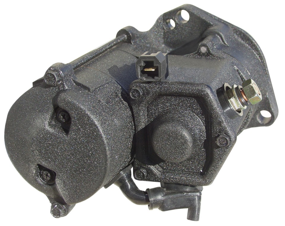

I want to look at a 1995 Dyna that doesn't have a key. Is there a way to engage the starter and turn it over to see if it is free? I have a jump pack. Not trying to start it. Thanks
edit: on my 98, it looks like the power comes in the side and the little plug is the trigger. I will try to get in there without sparking.

Yes. With screwdricer. Pos. on starter to any neg. point. Make sure it's in neutral.

https://i.ebayimg.com/images/g/5FgAA...jdm/s-l960.jpg
Yes with Jumper pack,but its not the battery cable terminal on top of solenoid that you want to add power to, but to the other side of the solenoid that has the cable going to the motor under the rubber cover
So with jumper pack, clip negative to frame bolt, then connect positive to terminal on the bottom of solenoid under rubber motor to turn the starter motor.
Note, help to use a piece of thinner rod,with sides of it tapped so only end of rod is expsosed, so you don't short out the jumper pack by rod touching to any other thing theh just the terminal nut metal.
And be dam sure trans is neutral to start with.
And no, bike will not start since not power to the coil, but will crank the starter to at least make sure engine is not seized.
Myself since it just to easy to pick a Harley tubular lock with tubular pick tool, would just do that to start with, to connect the jumper pack to the battery if the battery is dead, to make sure no problems in rest of system, as well as if bike is going to run from the start. If bike is using an alarm system, and owner does not have the fob as well, then does open some other hurdles.

Thanks, @Dano523 does that wire under the rubber boot go directly to the battery? This bike has no battery. If I connect the jump pack to the battery end, then touch power to the little trigger post, will it turn over?
Thanks for the advice on the pick tool, but I won't have one by tomorrow. The whole switch is pretty easy to remove on a Dyna, so I can probably figure something out.
And yes, I"ll make sure it's in neutral!

Yes with a momentary starter switch like this one from harbor freight. Just go from that power stud on starter to the green wire on the starter solenoid. It won't start it but it will turn it over to let you know if that part of it's working..
No, wire under the solenoid in photo, goes directly to the starter motor itself and is after the starter solenoid to energize the starter motor..
If you want to jump with the solenoid ,where the battery cable will connect to the starter solenoid instead (with jump starter on ground cable at battery location as well, then you want to jump the Green wire to energize the solenoid, which will energize the starter motor as well.
The glitch here, is if the starter solenoid has problems, needs to be cleaned or rebuilt, may not get the starter motor to turn in the first place, and may think that the engine is seized, when its the starter motor not getting power to turn the motor to begin with..

Thank you for correcting me. Been a long time.
