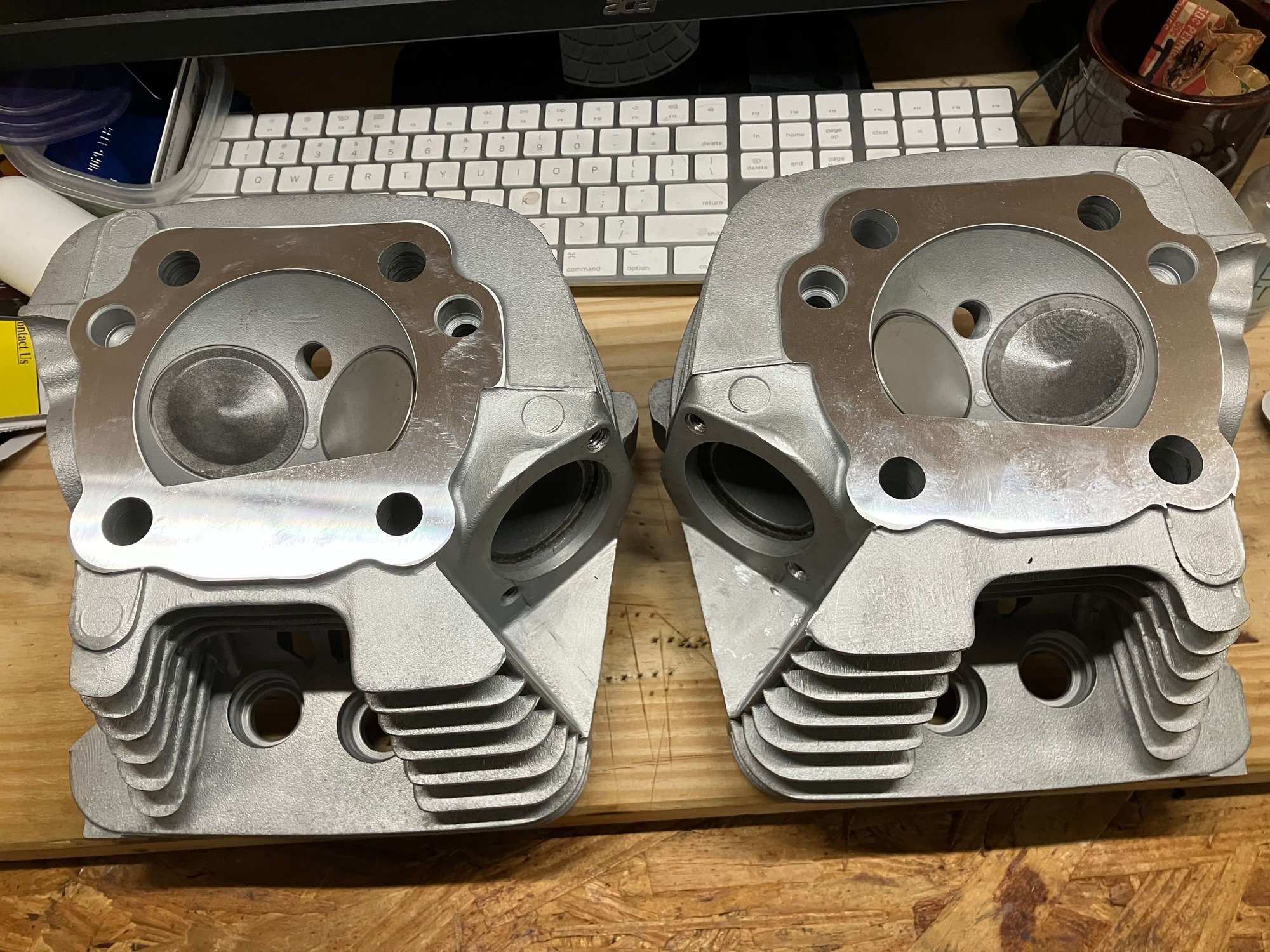

Found a shop to do them. They will determine if the valves/springs/guides are within spec. We will see what happens after I drop them off Wednesday.

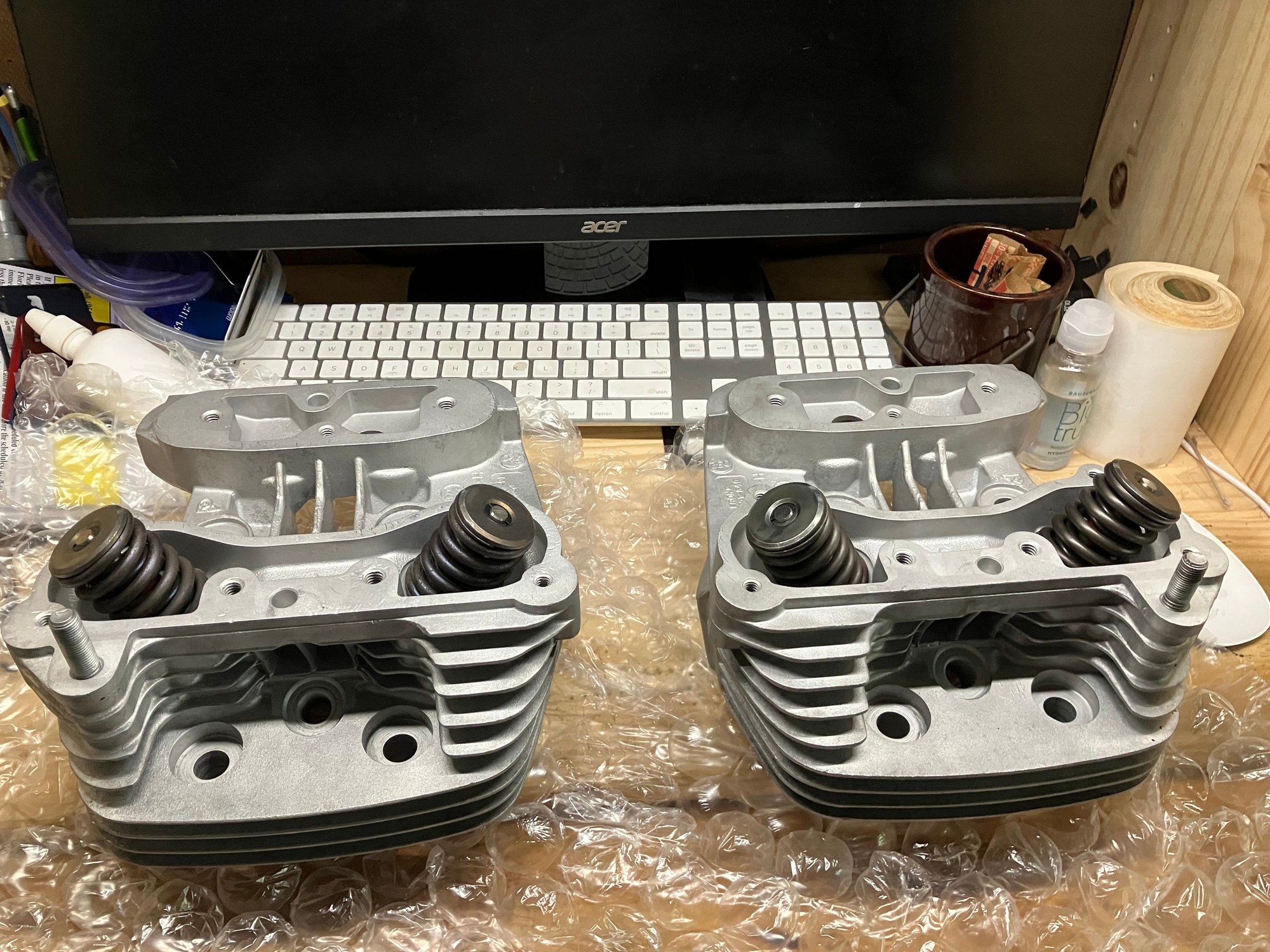

Heads are done. Everything cleaned up and was within spec. The only hiccup was pulling the exhaust studs. One had to be drilled out and rethreaded. Diamond cut the surface. Total was 590.
Next is putting them on, putting the lifter rods in, and the rockers on. I hope to get that done before I head out for the summer.
