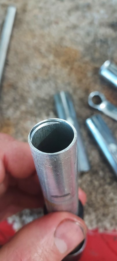

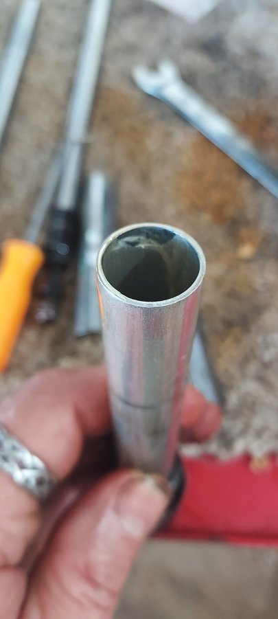

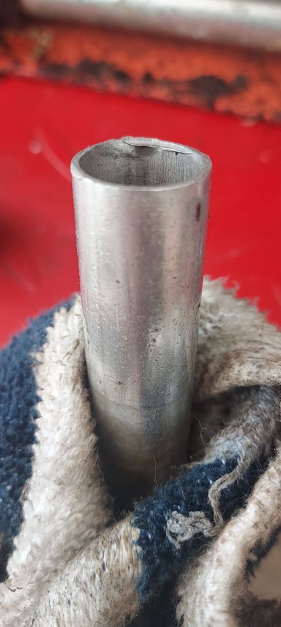

Originally Posted by Schex
Look at the end of the top pushrod tube for contact with the collar on the pushrod.
If they are hitting, It won't need much off the tube.
I've never done it, but you could probably install the pushrod with the top tube only, finger tighten the lash out, hold tube up in position and turn the engine with the rear wheel to full lift and check clearance
You, my good sir, are a goddamn LEGEND! 😃
I finally got the time to install my new, new lifters today. I say "New, new" because the *finger quotes* Johnson Hylifts *fq* I bought turned out to be some kind of bullshit knockoffs. I immediately returned them & bought some Fueling numbers.
Super straightforward job, but I did remember to check my tubes.
In order: Front exhaust, front inlet, rear exhaust. Oddly, the rear inlet was fine!
I abbreviated them to the suggested length of 4.875" installed new o-rings & changed the oil (just in case)
Damn me, the bike has NEVER been quieter! She runs like a sewing machine, although it's brought to my attention that my left hand gas cap rattles 🤣
