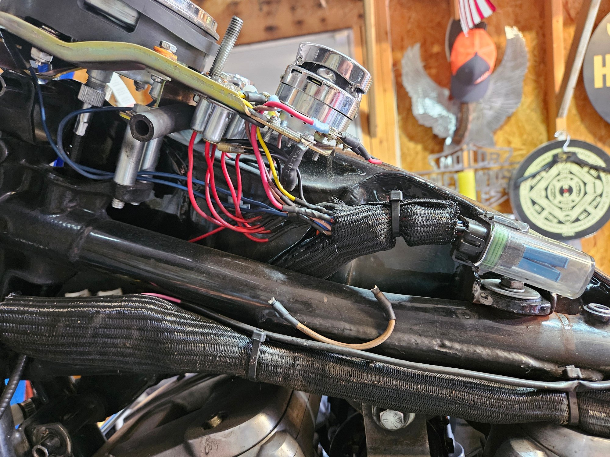

Finally got the bike on the stand this weekend. Not much to report but this is what I have so far.
- Tried starting it just to see what would happen. In hindsight putting a battery back in the bike might not my brightest idea... The auto breaker tripped. It wasn't doing that before. It did reset after a few seconds.
- Pulled battery back out and started inspecting wiring I could see. Couldn't see any thing burnt or damaged. I haven't removed any loom or protective casing yet. Positive cable from battery to solenoid looks ok on the outside. Ground cable from battery to frame does have a very small nick in it and the bolt to the frame was slightly loose. I could move the cable back and forth on it. I'm going to start by replacing these cables.
- I need to pull the gas tank. I rewired this bike a few years ago. There was a substantial amount of wire damage from rubbing between the tank and frame. I think I had it wrapped and placed well but we'll see. Before I rewired it the ignition wire had been rubbed through and replaced with a jumper(?) wire.
- Not very professional but I was sniffing around the bike trying to locate the burnt wires. Only place I can smell anything is on the right side by the starter.

Pulled the tank this weekend and found the ignition wire from the switch down in there. I didn't even realize it was missing when I inspected the switch. First place I go when I have an electrical issue. Usually one end breaks and it's obvious. These connectors breaking is an ongoing issue. Still need to make new + and - battery cables. Should have it back together for testing sometime this week.
