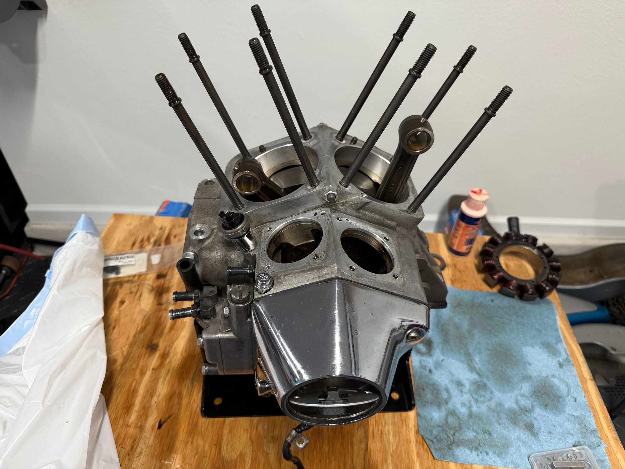

I have the cases split and cleaned up everything. I decided not to press the crank out. I was going to seal everything back up but the case bolts looked pretty bad so I ordered new ones. I think they'll be here on Friday so I should be able to get the engine back together over the weekend - that will depend on July 4th activities. In the meantime, I'm going to clean up the heads and install the new valve seals.

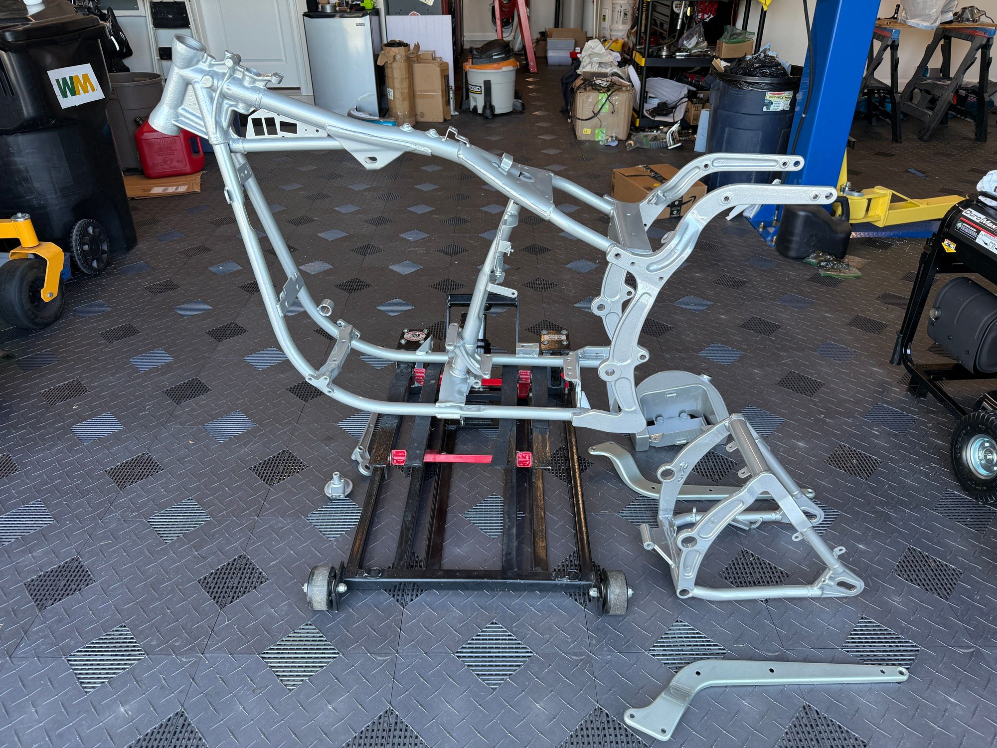

Now the work begins. I haven't been working on the bike that much but still cleaning and recoating parts. I just picked up the frame and some other parts from the powder coater. The engine still isn't together but the cases are back together and sealed. I'll be taking the heads apart this week, cleaning them up, reseating the valves, and install new valve seals. I'll be making more progress in weeks to come.
Ignore the mess in the garage LOL

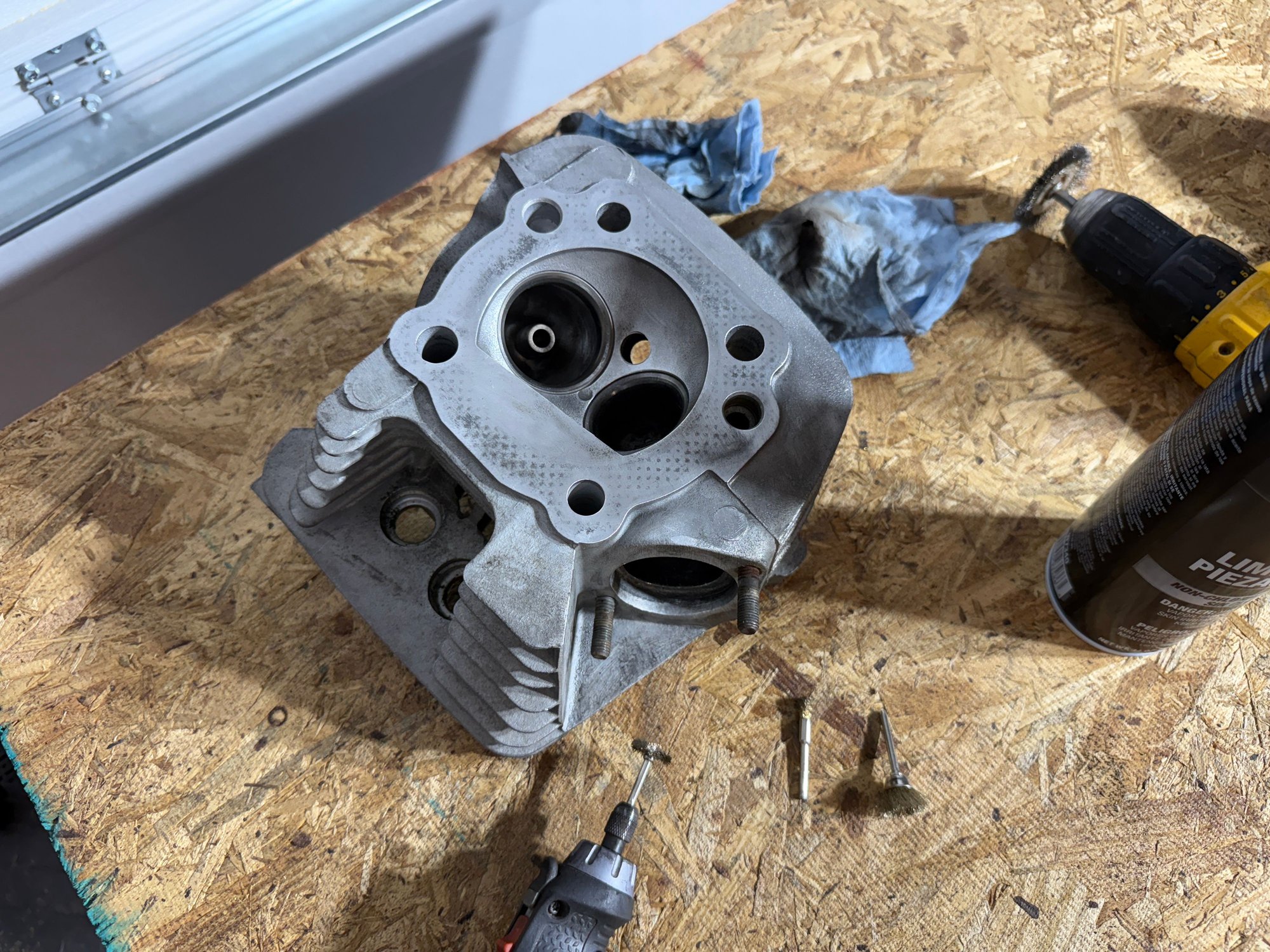

I got the oil pump cam chest of the engine sealed up and tested the oil pump. It is working great.
I have the front head clean up, same valves finely grounded, new valves seals installed. The exhaust valve had so much carbon on it I'm shocked it didn't invade the valve seat and refuse to close. Definitely running rich and maybe the valve seal leaking.

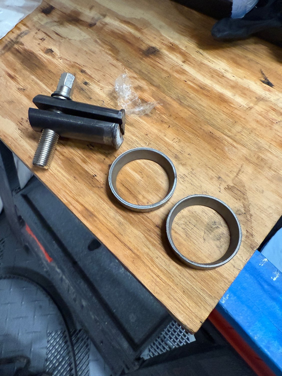

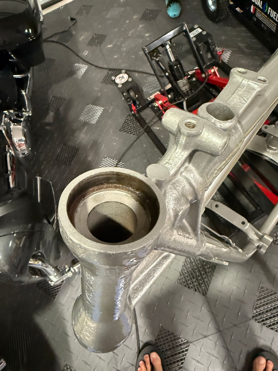

I needed to remove the races from the steering neck but the tool I bought was too thick to get between the race and the neck. I looked online at different tools and they all seemed to be the same thickness. It was only $26 so I said F it and put it on the grinder. It worked and I was able to remove the races.
Hoping to get the other head cleaned up tomorrow and put back together. Then I just have to put the engine back together. Once I get it back together, I have to clean and polish it. I found this YouTube to should help me on the process of restoring the natural aluminum finish.
Pics for your enjoyment!
