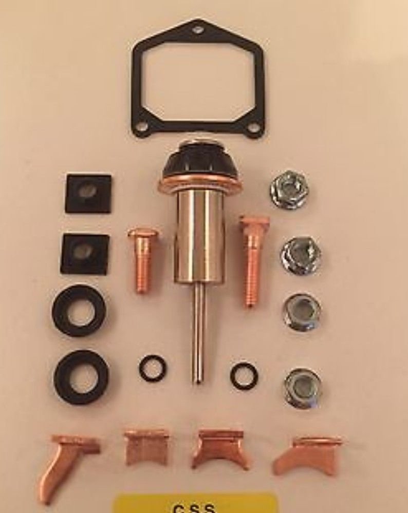

After checking voltage, my bet is on the large contact washer in the starter solenoid.
You probably can get a replacement kit for it that will replace it and it's mating contact tabs.
Years ago, they had a thick silver plating on the copper. Most are just copper now.
Your start button is just firing the small coil on the relay. That relay is firing the solenoid magnet that pulls in the starter gear and turns on starter with the big contact. So a little more load then the start button.
That contact in the solenoid pulls a lot of amps . It gets a work out.
