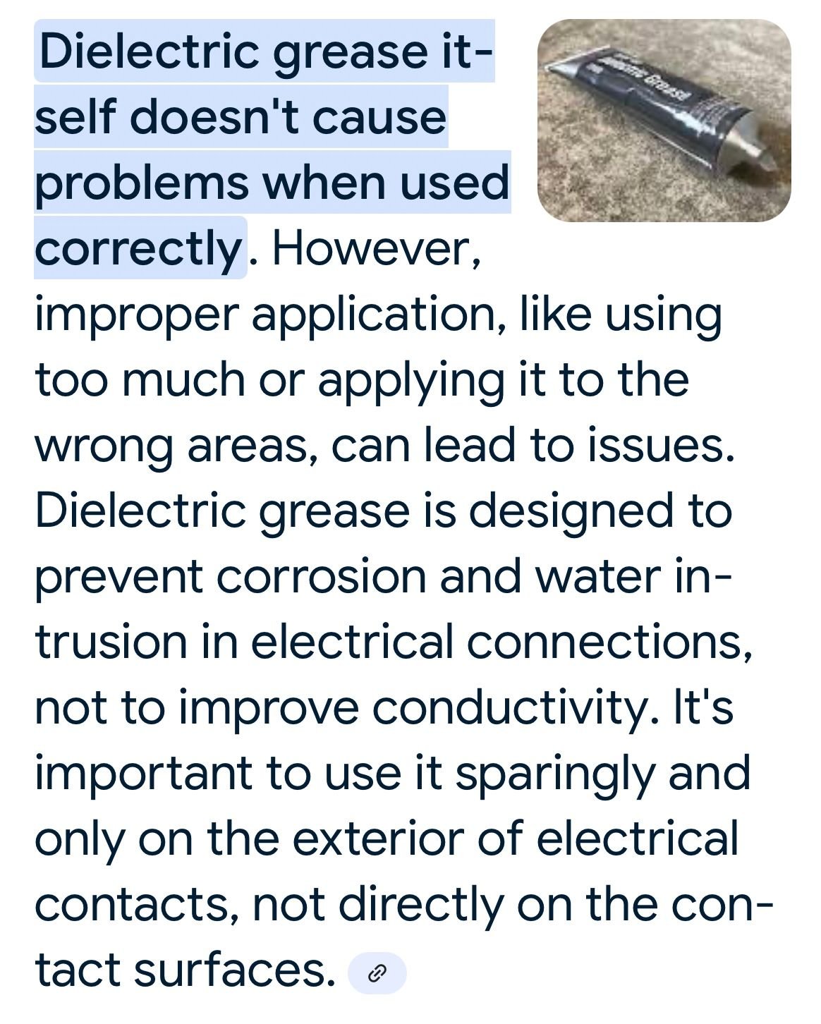

You probably already know this, if you do pull the ground wires and clean both the wire and ground surfaces, I'd use some dielectric grease on the surfaces when you put it back together.

Dielectric grease is non conductive, do not put it on the connection surfaces of the cable and frame.
Thanks, good to know.
