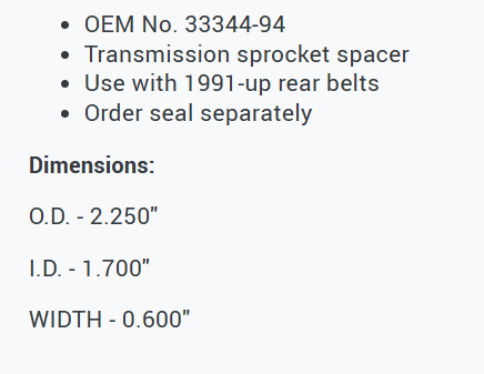

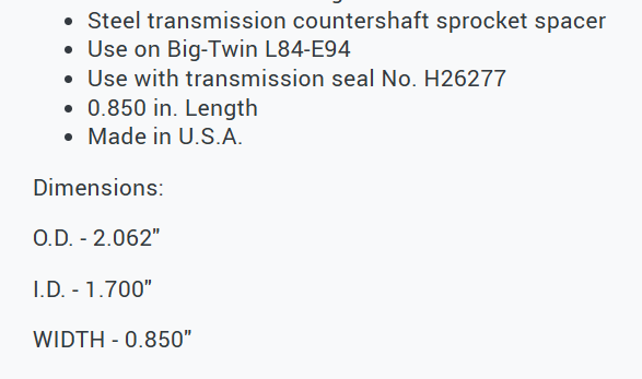

does anyone know if the upgraded drive pulley (with the locking/retaining plate) would use a different spacer and thus a different oil seal? This 1993 does look to have the upgraded drive pulley with the nut lock plate.
EDIT: just looked up a replacement spacer, the one listed as 2.25" shows fitment for a 94 fltc, not 93. Must be the upgraded front pulley does require a different spacer and I most likely need the main seal for a 94 fltc. I guess I shouldn't be surprised the first one leaked so badly after hammering that oversized spacer in. Going to run to the dealer tomorrow and take the spacer and unused seal and see if the late 94 or 95-up unit will fit. Should be 12067A I think.

what bike should take:
what is actually on there (probably related to the late 94 drive pulley):
Hopefully this info may help someone else avoid this issue (and 3 primary drive teardowns) in the future!

Upgraded spacer goes with upgraded seal and upgraded pulley.
If pulley says -94c it's the upgrade. Seal. spacer lock plate, etc. should match that pulley.
11165 quad seal
33344-94 spacer
12067B seal

yup these are the correct PNs. Dealer said 12067-A has been superseded with the B part number. My parts book must be too old I guess.

went on a 30 minute ride last night, clean floor under the bike this morning! A very good sign, finally...
