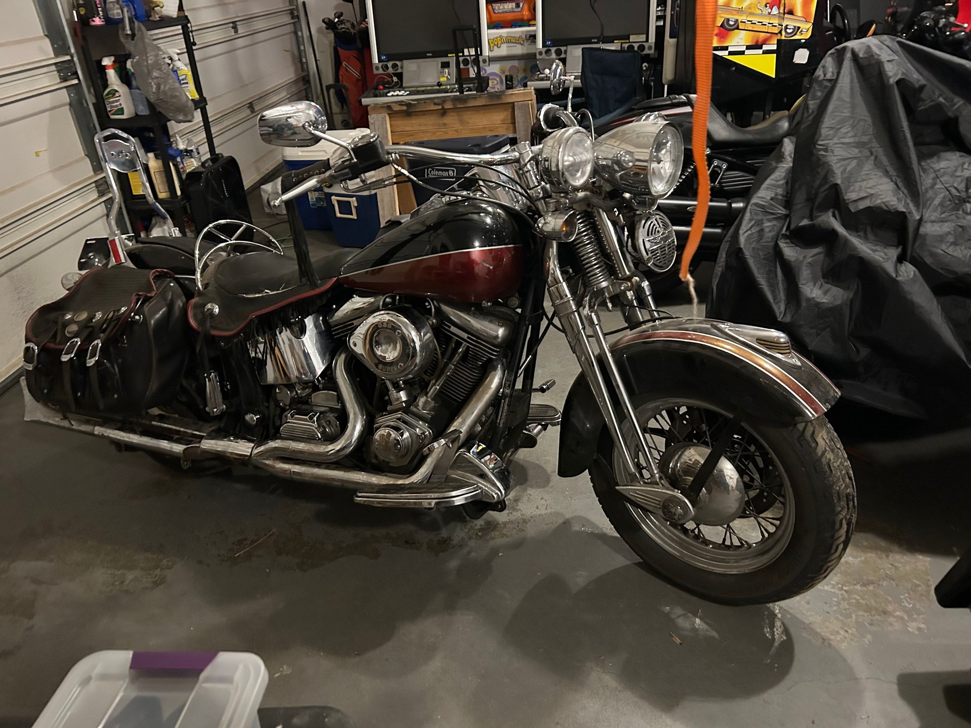

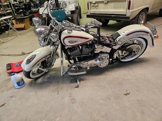

Looking for some insight. i have been working on this project bike for a while and seem to be stalled. I have a 97 springer that has been really worked over through the years. it is about 70% restored, if you ignore the motor being a revtech. Currently the goal is to get it running well enough to be able to ride around town. Currently the problem is a lack of power at what i would consider normal operating RPMs and that is based on sound. it is very hesitant and has a little puffing and spitting until you wind it out until it sounds like it is going to about blow up, then it takes off like a scaleded ape. Alot of noise sounds like the top of the motor, cant tell if its lifters, valves or just the way a Revtech sounds. I have replaced the chinese cv carb with a mikuni 42, ignitiion and coil with an S&S kit and it has gotten better but still not really reliable. I am wide open to suggestions please dont throw down replace the engine. I know eventually that is in the works i would like to get this one running first....

Nice looking bike/paint job!
