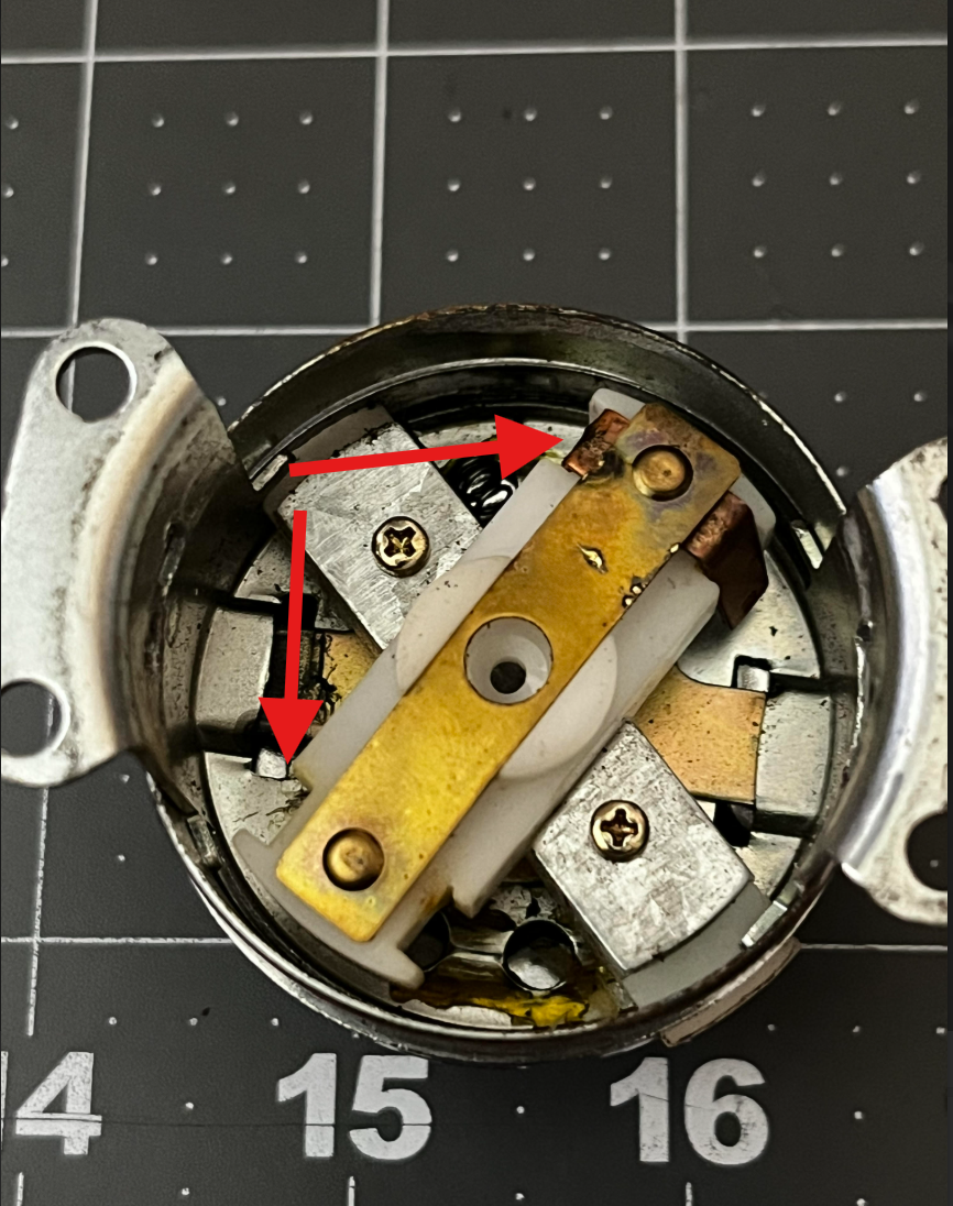

Originally Posted by bulldog1776
Thanks guys. Yeah my battery is good. When this ignition switch on the bike went out it made a electrical popping noise, and now when you turn the switch some times it will throw a spark.
I suspect something internal on the switch shorted out? It's also real rusty pretty much around the whole thing.
This is exactly what happened to me. The switch you have looks like the aftermarket switch that was on mine. There were two spring loaded copper wipers in there and one of them came loose and would short out at random times. I could move the switch back and forth to get it to stop shorting and get home. I took it apart...it was total junk. In this pic you can see where the lower left copper wiper is missing...it was rolling around in there and would short out at random times.
