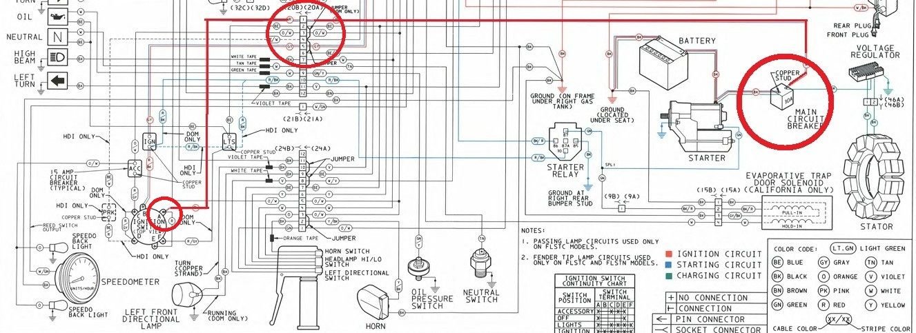

As you're looking at your switch the terminal at the 1 o'clock position is where the power hits the ignition switch
There's a self resetting 30 amp circuit breaker on the rear fender splash guard.

Make sure there is power going to the switch, check for voltage at studs on main breaker (rear fender extension). check studs for power one at a time, both should have system voltage.
Check the connector between the tanks, make sure there are no damaged or pushed out pins or sockets.
Check voltage at switch, should have system voltage at all times, regardless of switch position.

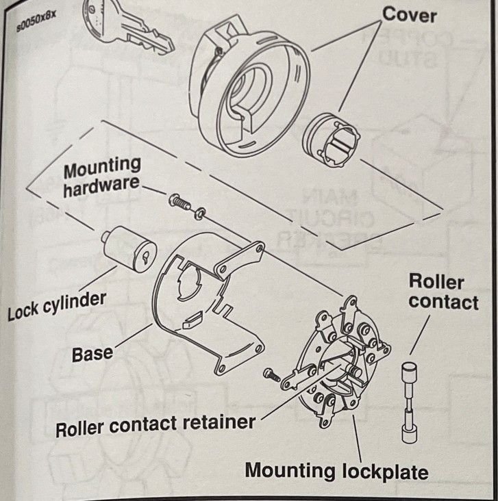

They can be cleaned up, here`s a page from the 1995 Factory Service Manual:

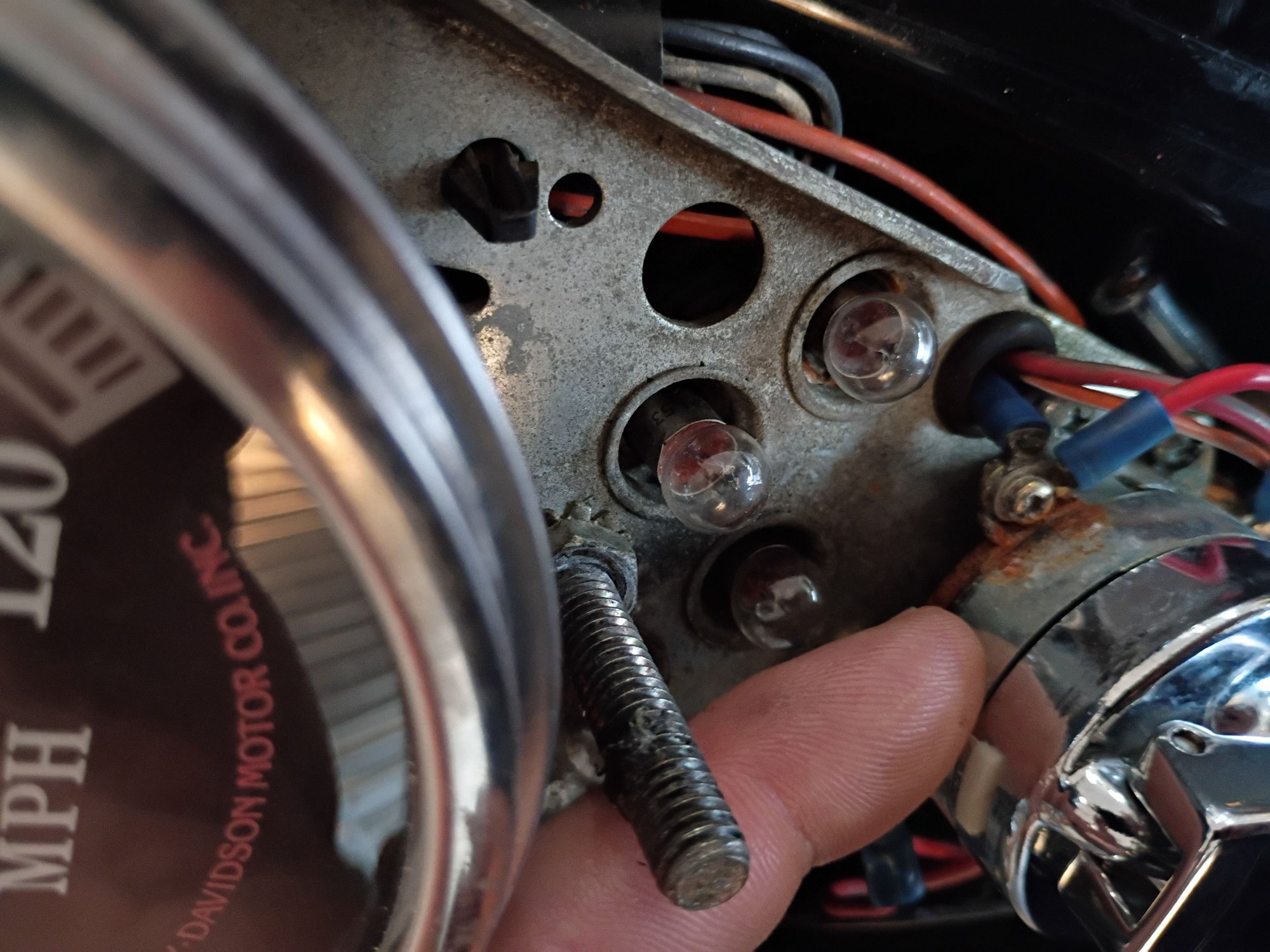

Thanks guys. Yeah my battery is good. When this ignition switch on the bike went out it made a electrical popping noise, and now when you turn the switch some times it will throw a spark.
I suspect something internal on the switch shorted out? It's also real rusty pretty much around the whole thing.
