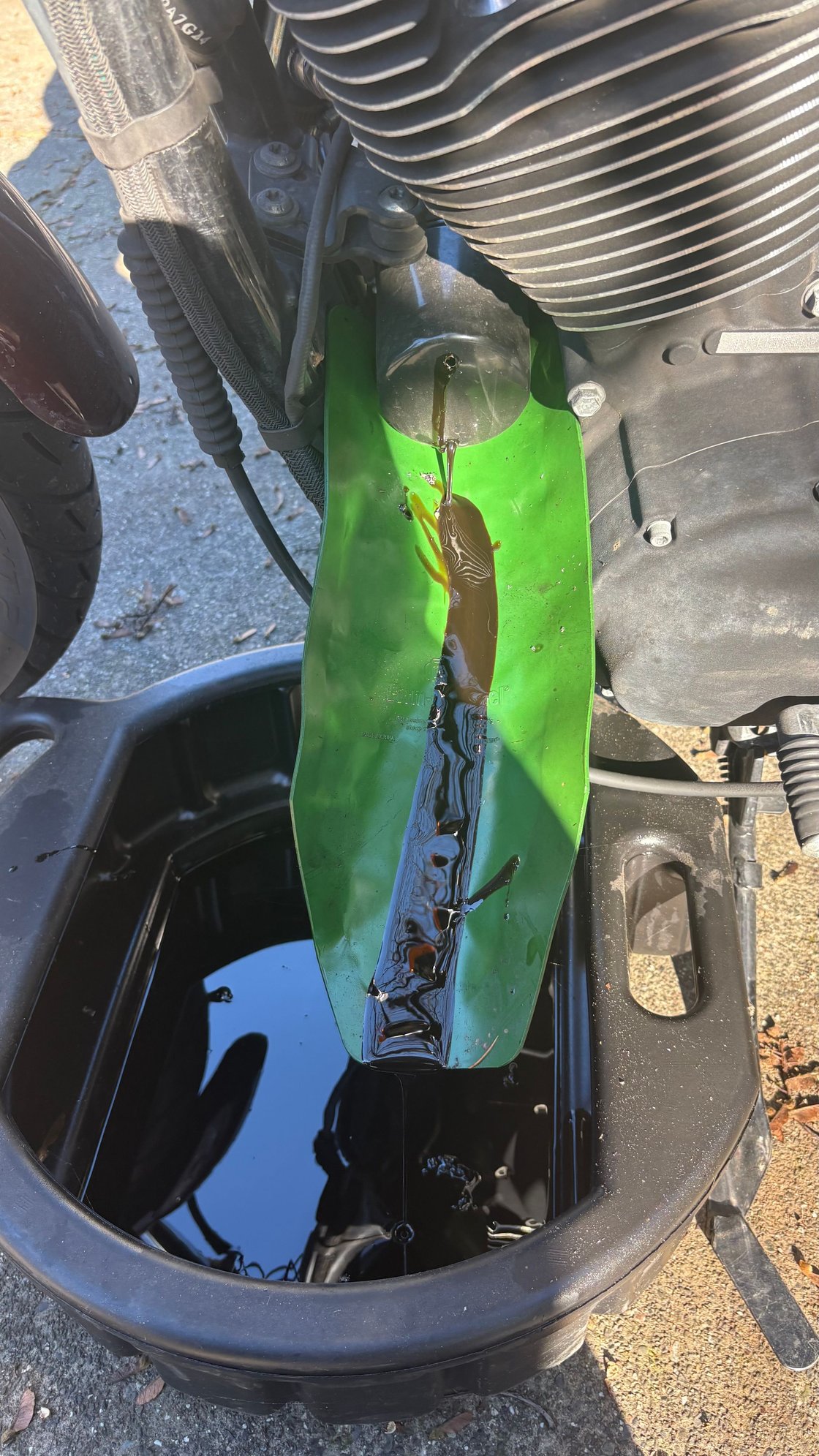

When changing the filter I first punch or drill two holes to drain it and direct the oil into a pan with a Form a Funnel, way less mess and oil on the motor mount that way when you remove the empty filter...just did one yesterday on my Sportster so fresh in my mind.

That's a great idea for removing the filter.
What about installing the new one? Do you fill it with oil before installation (thereby still making a bit of a mess)? I know some engines are not at all tolerant of starting with a dry filter.

I think I got the idea here of punching and draining the filter first...
I don't bother filling the filter first and so far so good, the engine quiets down very quickly after firing up...plus the bottom end has roller bearings and they are more tolerant of a momentary lack of oil pressure IIRC.
But that is just my experience, I don't know if that is a bad idea...FWIW my HD FSM doesn't say anything about prefiling the filter.

Sorry- but punching a hole in the filter is a quite old and well known function- the funnel kit i bought from china 15 years ago comes with a spike to punch the filter- and ive been doing it on my trucks hemi motor since i bought it.
Sorry to burst your bubble guy..
And remember- on evos- the filter is on the RETURN side of the oil circuit- not the FEED side where pre filling is important- so pre filling a filter on an evo is not really required.

And thanks for the replies, especially the info about the filter being in the return circuit.
