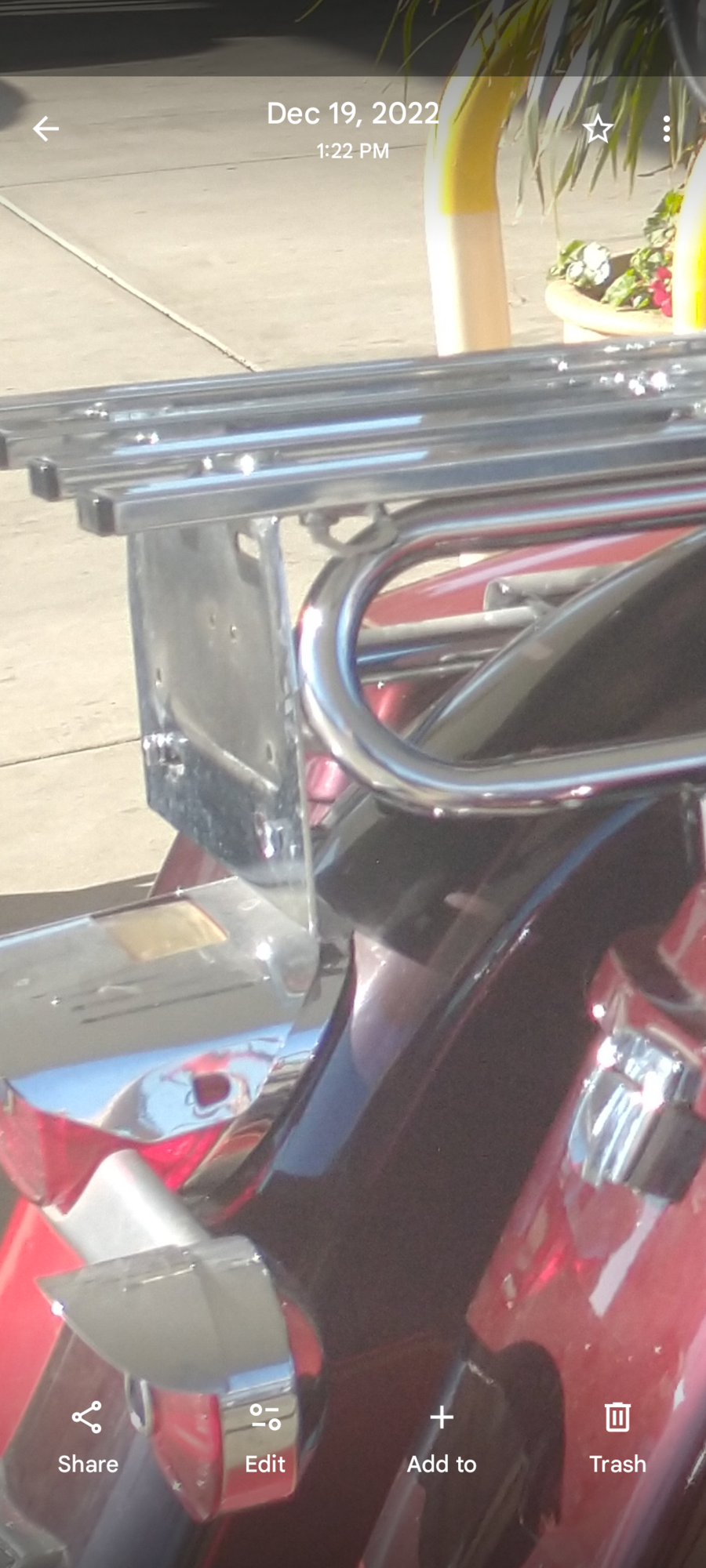

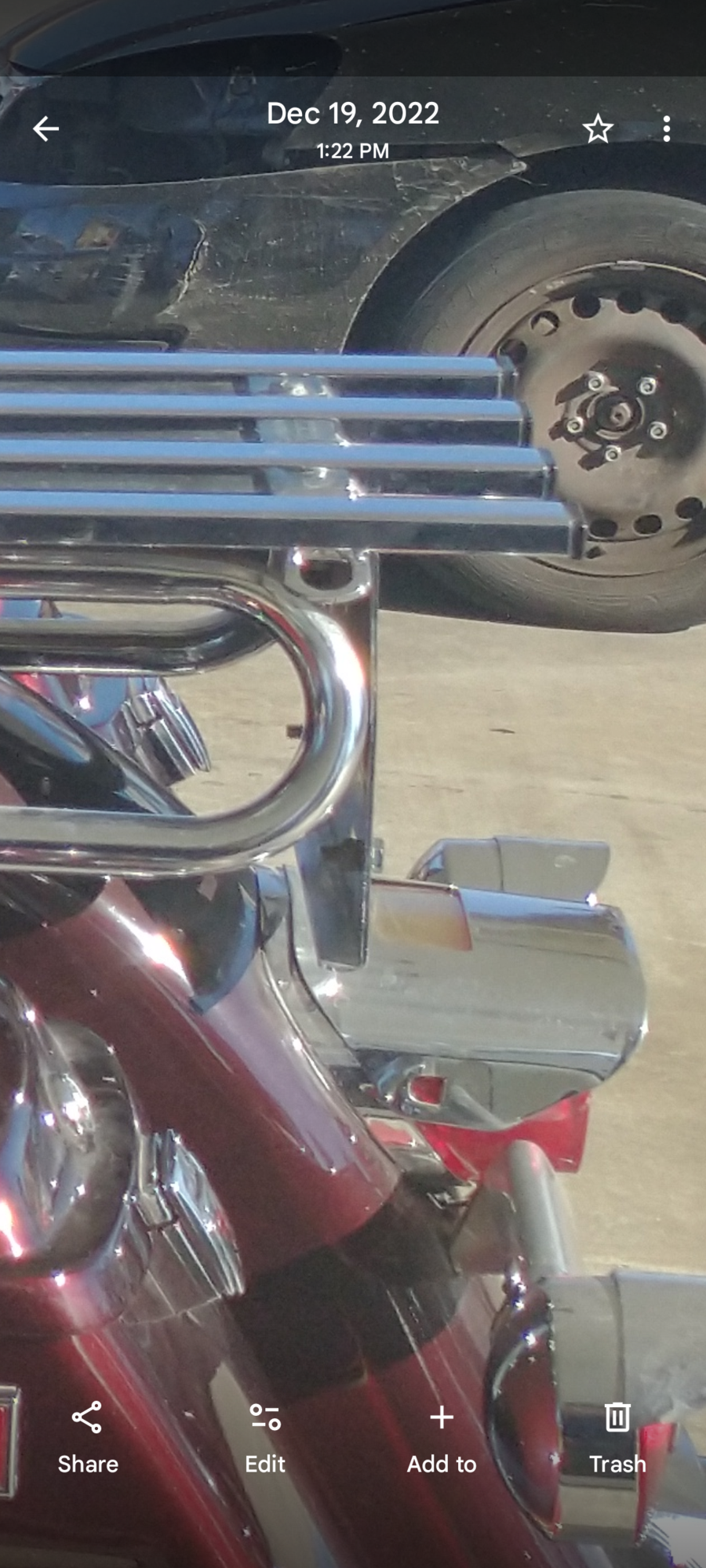

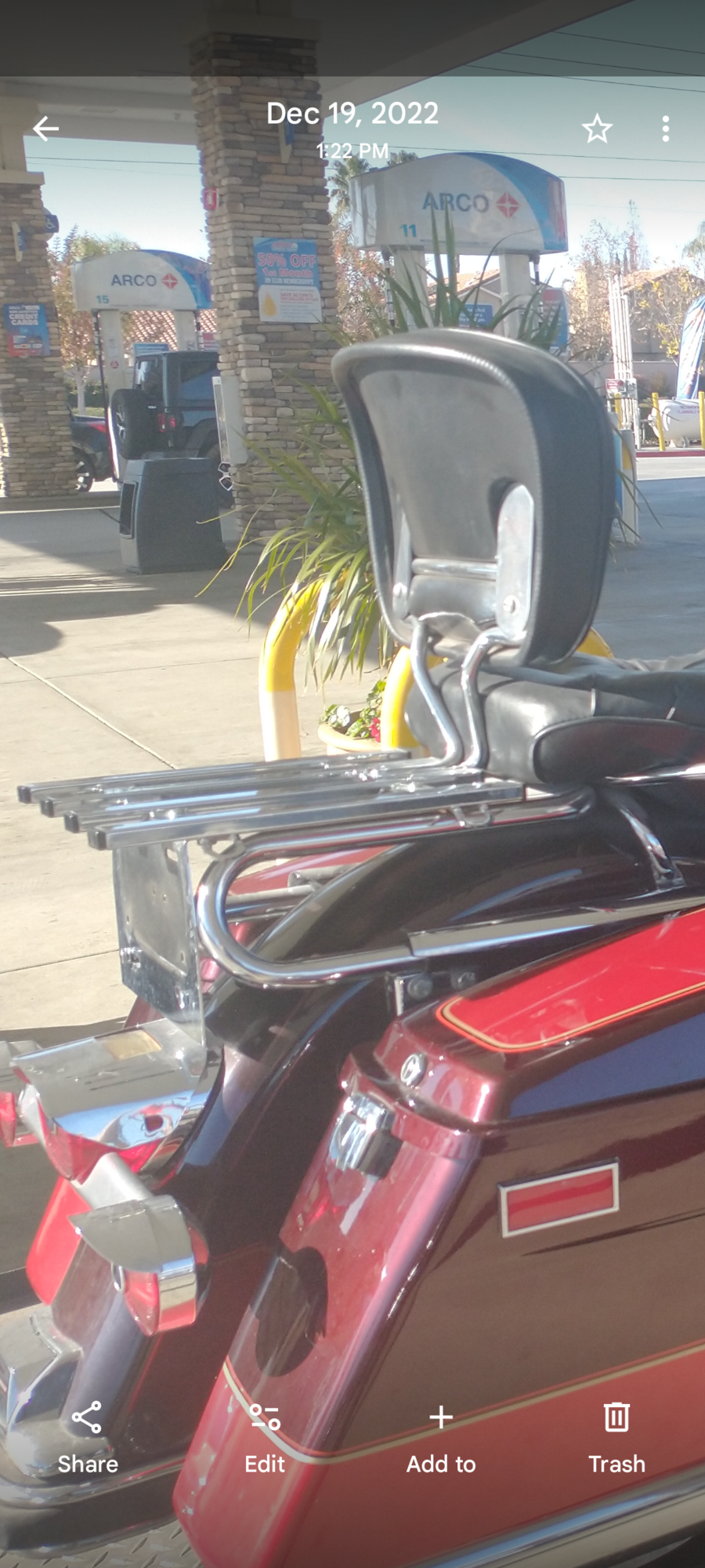

You got me wondering how the license plate is on my 1990 FLHS. It's fabricated into the luggage rack and backrest. Here are some pictures I zoomed in on.
