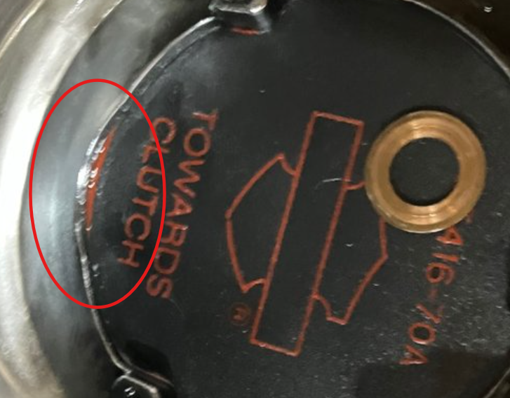

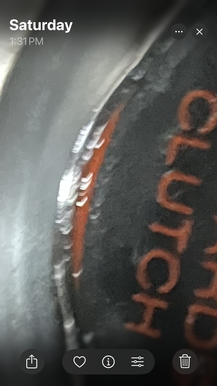

Cut does not look FMC to me????

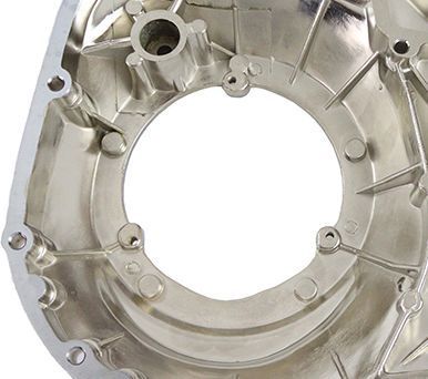

I can see something has beat on it and that needs to be addressed, but the "dip" is normal. It's only seen from the inside.

Originally Posted by jimkav
Look at the 1/4 moon cut where you see the orange peaking out.
Originally Posted by Bubba Zanetti
Is this what youre talking about?
That I see...but, No Clue what inside the primary might be able to Touch that spot!!
Originally Posted by Tommy C
If the bike is an 1988 or earlier, that copper washer is the thrust washer for the pinion gear.
Thrust Washer for Starter Shaft..
I look all around the area indicated for rubbing by Clutch Components, and certainly all The way around for Chain Rub from running too Loose. Which certainly Is Noisy!!

If the hub wasn’t seated all the way and stuck forward it may have cut into the half moon area.. also maybe a previous owner tried the wrong clutch hub or a aftermarket variable pressure plate and it didn’t clear grinding that away.
‘’To do that much damage I’d also change the tranny main seal and barring in inner primary.
