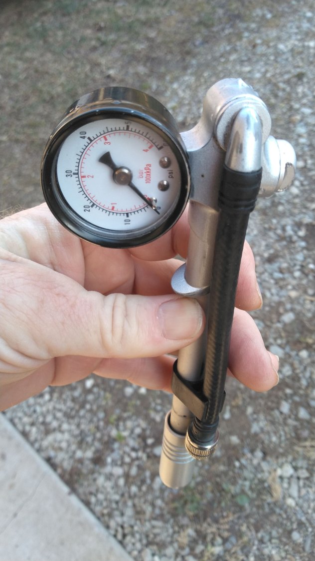

I wonder if the newer model shocks will alter the recommended air pressure. EDIT: I see the specs are pretty identical. Trying to find a cheaper low volume no loss pump is like surfing through garbage. I see a used progressive pump online, might make an offer.

Any low volume/low pressure pump will work. Amazon has a decent one for $18.

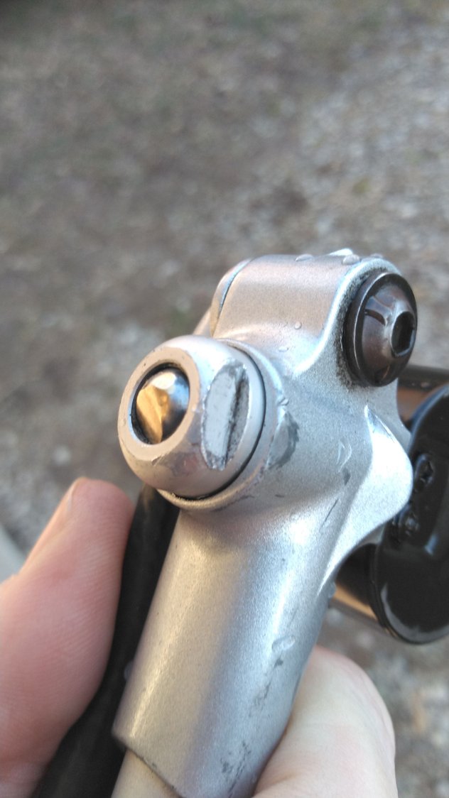

Even searching for low pressure they fill the page with high pressure pumps from 160-300 psi, making the gauge much less accurate for fine tuning. I took my old one apart several times yesterday and changed o-rings and such, but couldn't get it to stop leaking past the bleeder button. Might try again today.

About the only one I could find with a gauge suitable for what you are doing. Reviews sound promising.

That looks exactly like my HD pump, except my pump is black.

BONUS! Third time reassembling my hand pump and this time it's not blowing bubbles in my bowl of water, it seems to be actually functional again!
And oddly when I hooked it to my bike the rear and front both still had a bit of air pressure in them, I have the back set to 15 psi now with the pump still attached so I can observe any leakage from the seal
