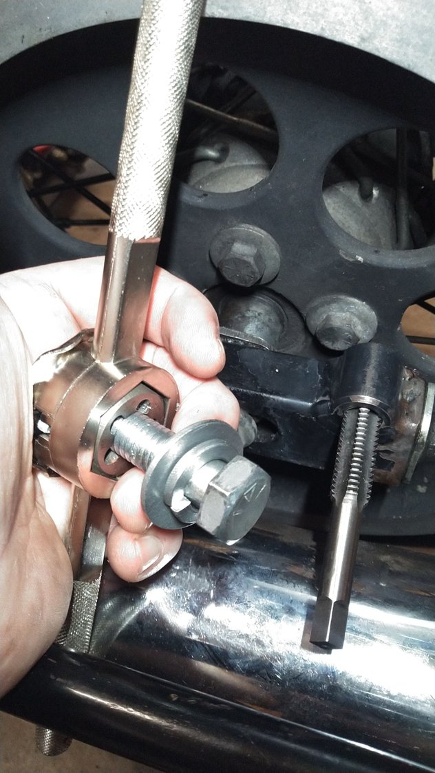

As always with this old bike they were minor complications. I took out one of the four shock bolts and it looked fine I think as I try to reinstall it I pushed a couple of threads because the bike was not at the perfect height, disaster averted with a Mac tools tap and die se
